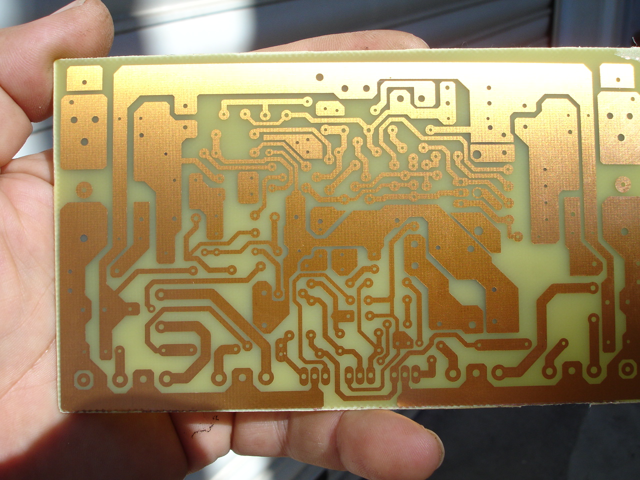

The very first boards I did were made from 2oz FR-4 scraps I bought on ebay, some FeCl2 I bought from ratshack, and glossy photo paper prints from my laser printer. I initially used a clothes iron to transfer the prints (lots of smeared attempts) and later moved on to a heavy duty laminator.
The process is fairly straight forward and the results were pretty good considering my noobness. Ha, here's the post I made about it some 8 years ago...

And here's after a couple years of practice...
http://www.diyaudio.com/forums/digital-source/133597-micro-dir9001-pcm1794a-dac-6.html#post1860855

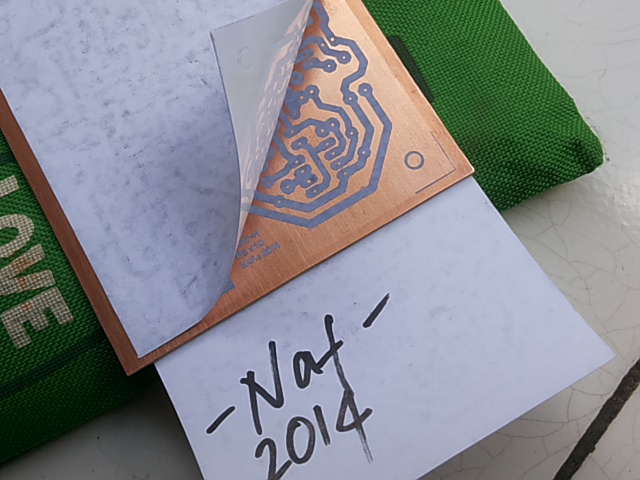

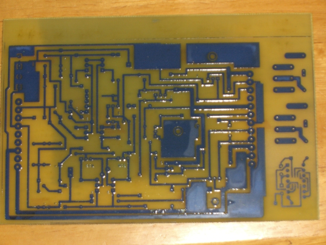

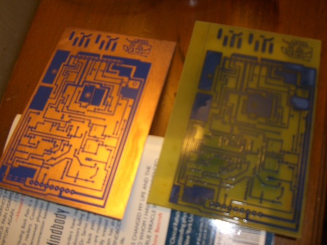

I can get a good toner transfer, using an Apache AL13P laminator and "Press N Peel Blue" transfer paper.
This laminator is adjustable. Backing off the adjusting screws about a full turn from the factory setting allows it to accept a .062" thick board.
I clean the boards toothpaste and green scrubby sponge, then rinse, dry, and clean with acetone and a paper towel. Keep rubbing until gunk stops coming off on the paper towel. Keep fingerprints off the board now...
Print on the dull side of the press-n-peel with a laser printer, as much toner as it'll let you apply.
Run the board through the laminator in a plain paper jacket a few times to warm and dry it, then run it through sandwiched with the press-n-peel about 10 times. I set the laminator for 300 degrees F.
Dunk the board in cold water for a minute, then peel it. It should come off clean, leaving blue stuff on top of all the toner. Don't remove that, the toner and the blue stuff together is the etch mask.
So far I've done a couple of reasonably large one-sided boards this way, and the masks look very good!

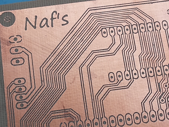

I managed to etch a board using vinegar, salt, and H2O2. It took a long time, like 2 hours or more. There must be a better way...
This was a large board (4"x6") clad in 2oz copper, so there was perhaps a lot of copper to remove. This was the process:
Get a plastic tub. Add 4 ounces 3% H2O2, 4 ounces 5% distilled white vinegar, and maybe 1 tablespoon of salt. Stir. Add the board, copper side up. Agitate. Brush the board with a soft brush occasionally to remove the precipitate. (I used a toothbrush.) Add more salt if fizzing stops. If adding salt doesn't do the trick, discard this bath and make a new bath. This works wonders! With each new bath, it would start fizzing energetically. Over the next 10 or 15 minutes, this fizzing would fizzle to a slow bubble and then to nothing. Salt might bring it back for another 5 minutes, once, maybe. Then to go any further, you need a new bath.
After about 5 baths, the etchant finally ate up all the copper. In hindsight, I would try harder to have more PCB surface area covered in copper so there's less to remove, to require less etchant.
Now I've got an old laundry detergent jug half full of used-up etchant to safely dispose of. That's a whole 'nother issue...
First pic here is a before-and-after for the etching process. Second pic gives a better idea the detail level here. It's a single sided board, and except for an SMT opamp adapter (in the corner) the traces are all 25 mil or more.
