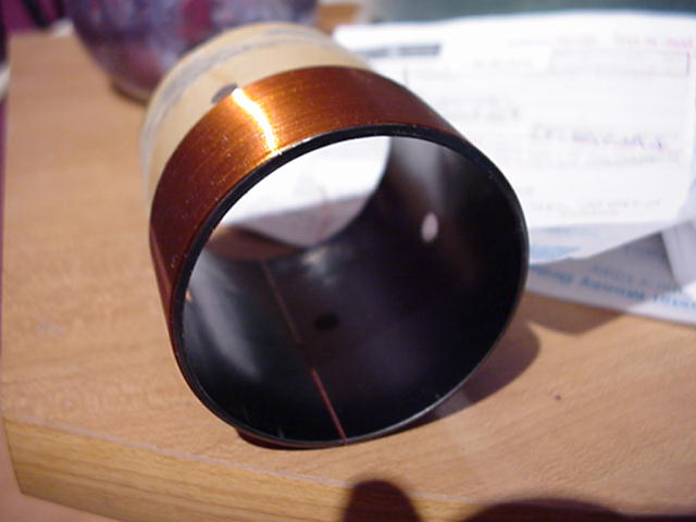

I have read every word in the 28 page Parthenon thread. Too bad no one every got around to finishing one. I also would like it to be high excursion; don't need 8-9" though
I also have FEMM but haven't done much with it. I opened it a few times and was lost. I am going to have to check examply problems or something.
For the motor I was thinking I could use a bunch of my ceramic doughnuts stacked N to S together. I have some older ceramics that were used inside the voice coil and there was nothing on the outside. Is this design bad? They used to do it a lot but stopped and started surrounding the VC with the magnets and just having the metal pole piece.
Aluminium former will form a shorted link as someone already pointed out. Cutting a slot will again spoil the stiffness. I think professional outfits use a special tool that forms a temporary bobin for winding the coil and the tool retracted and withdrawn after the glue has set. Here in India teflon is available in industrial materials shops.
For high excursion the factors to concentrate on:
(a)The surround and spider should allow the movement: large diameter spider may be required. I have also seen raised spiders in some drivers.
(b)For linearity at high displacement, the length of the coil should be sufficient, so that a part of the coil is inside the magfield at extreme positions.
The idea of magnet inside the voice coil sounds interesting. But remember that the field strength depends on volume of the magnet material. For a given material (ceramic in your case), bigger the magnet, stronger the field.
As for assembly-sequence, I have seen one manufacturer magnetise the magnet after the whole assembly is done. I think it may be difficult to keep the pole pieces in alignment with a strong magnetic field, during the glueing process.

I can get 14GA galvanized sheet metal from work for free, will that be ok for the basket and to transfer flux? I don't want to spend hardly any money because I don't have it right now. I will try an example coil using a beer can aluminum former and Minwax polyurethane to coat the coil. I don't even have enough money to get kapton tape so is there any common household item that will work to go over the former? Single layer of electrical tape?

2 Q’s
1) Does the former have an effect on the voice coil, for instance does an aluminum former behave differently then a plastic, copper, etc...? My intuition tells me that from an electromagnetic standpoint there must be differences, but are any of these audible?
2) Does anyone know a good software program that would aid in the design process?
I am going to wind my own VC’s for a recone job and I am currently planning or using silver(winding) and aluminum(former) or visa versa(open to suggestions). The former will be insulated with Kapton tape. I am interested in finding out if and how changes in the materials of the VC will effect its performance.
