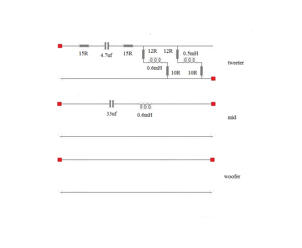

So would that increase the xo frequency or decrease?
generally, when you lower impedance, a smaller series inductor will be needed
with caps its the opposite
theoreticly, half impedance ought to result in twice the cap value
or double the impedance, and you only need half size cap value
but the reality is not that simple
one problem is you have multiple ressonance points/peaks with compression tweeters
yea, that makes sense, but what about the woofers inductor? why did putting the cap across the inductor make the woofer able to reproduce high frequency, and not the big peak ? when i put the red cap (4.75uf) across the ind, it made it sound horrible, but the 1.0uf was perfect.
Just a note on the marking on that cap; the 475 refers to the number of zeros after the 47 in Picofarads so 4700000pF; or 4.7uF
Hopefully Sreten will chime in with the formula for reactance, I can't find my notes as they are on a dead computer, but when components are used in conjunction the frequency and the damping/peakiness of the reaction change. Google Linkwitz-Riley, Chebychev, Bessel and Butterworth crossovers.
LR crossovers are well damped and Chebychev are highly peaked.

ok guys, ive had a chance to listen to them today after the mods. and i have to say im still not 100% happy with them. so im going to put it down to the specific speakers. the delta having bad manners above 1.8khz and the tweeter being cheap china crap.

so, as said, i listened today, at what i think of as moderate volume (as its in my garage and the next door neighbour is only 50m away .... ) but, with no EQ, they do sound much better than they did. still a bit dull in the very top end, (16-20K) and a tad bit vocal sounding.
so i then decied to turn on the EQ and give it a tweak.
heres what i came up with:
on that, you can clearly see where the woofer is filtered and where its not, and the fact that the tweeter is clearly lacking in upper top end.
im happy with the fact that its not maxed out except for 20k. but, before the XO adjustment, i had to have 10k+ all maxed out to make it even sound like it had a tweeter.
