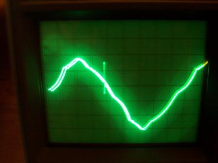

Speaking of clean power and how to get it, I remembered that we have a 12KW backup generator here that is powered from the gas line. I fired it up the other day to have a look at the waveform.
Below is a comparison of the mains power in my shop on a weekday afternoon vs the AC out of the 12KW generator. Both taken from the same receptacle that the o'scope is plugged into.
Can you guess which is which?

right one is the mains
Correct!
You must have seen generator power before. I was surprised how dirty it was.
