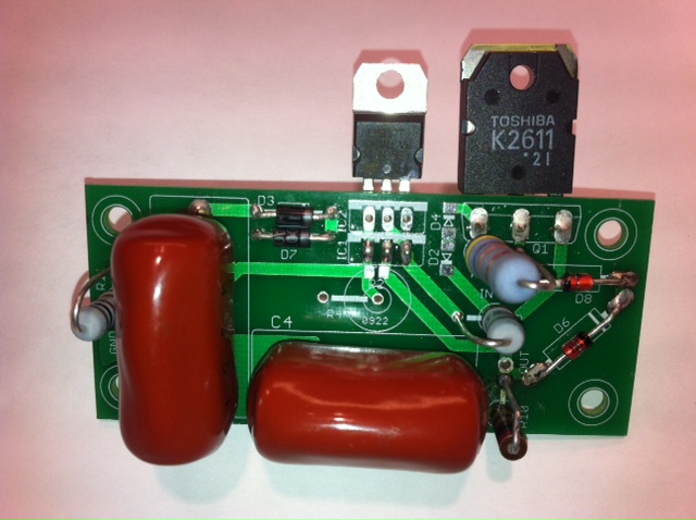

Hey Heath,
I got your card very promptly and they look great. You vendor does a nice job for the price. Pardon my manners for not commenting sooner. Things get hectic around here.
I built one up last night out of parts I had around, and I will test it when I find a suitable pot (I'm keeping this first one adjustable). BTW, most of these parts came off a power supply board from a Flat screen TV. I recommend them highly when they can be had for free. Lots of big caps, heatsinks and cleaver means of isolating and clamping devices to the heat sinks. I used a Toshiba K2611 N Channel Mosfet rated for 900V.
A few questions I have:
1. Can you explain the purpose of D2 and D4. I can't imagine what these opposed diodes can do since no dc current can pass in either direction. I see that in the Maida, he uses a 1K resistor tied to the middle of the Darlington.
2. I don't have any surface mount components and I forgot about them on the last Mouser order. I'd like to work around that at least until I get another order out. I think we all agree that D1 is optional?
3. R1, the gate stopper, is not on the Maida notes but those are NPN bipolars not FETs. Can I get away by soldering wire across those pads until I get the surface mount resistor?
4. There is an implication by omission in the Maida discussion as well as MJs 3rd ed. drawing of this circuit, that the LM317 doesn't need a heat sink. Have you noticed if it runs hot? I suppose that with a 12 volt zenier (my choice) it will run hotter than that the Maida with the 6.2 volt D9

The "zener diode clipper" circuit is new to me. I just read up on it. Any voltage over the zener value gets clipped. I'll have to look at that on the scope later.
So is the purpose of R1, the gate stopper, to limit the current through the zeners?
The purpose of the zener clamp is to limit Vgs on the MOSFET to a safe value. Most MOS don't tolerate more than +/-20 V across the gate oxide. Some MOS devices (like the STW12NK95Z I like to use) have the zeners built in.
The purpose of the gate stopper is (usually) to prevent parasitic oscillations in the gate drive circuit.
