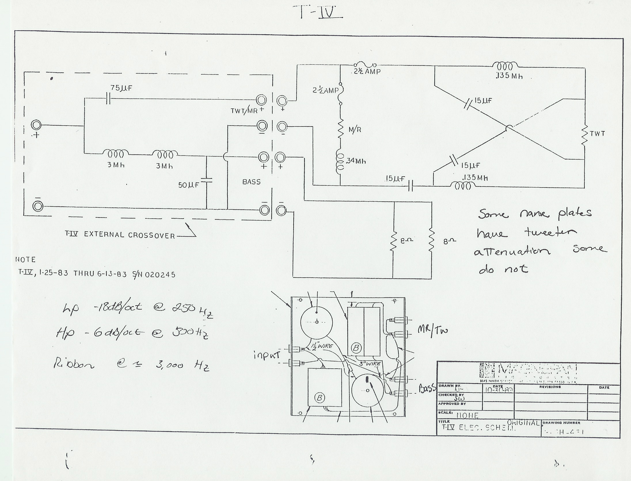

I just bought a pair of Maggie MG-IIIa's, but they are missing the external crossovers. If someone was willing to share the schematic for the IIIa's, I would be very grateful! I spent an evening scouring the internet, but could not find one for this model. Apparently, there used to be one posted on Geocities, but that site is down now.

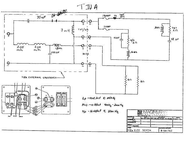

Hey, I had and loved my MGIIIa, until I heard and bought my Tympani IVa's. I will never get rid of my Tymp's.

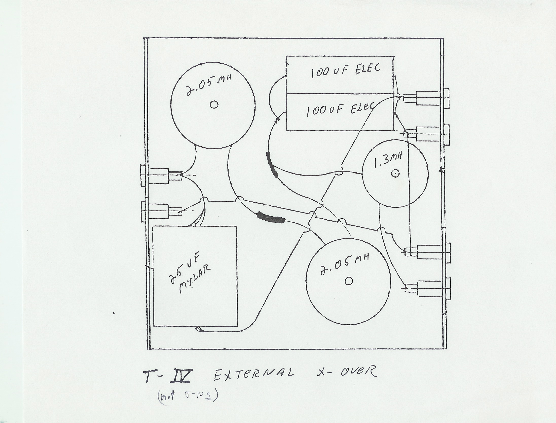

Anyway, I know I have the MGIIIa schematic on another computer, and they were really similar to the Tympani's. I have attached the Tympani external schematic.
I rebuilt my Tymp crossovers and was amazed on how well it worked out (someone offered me $350 for the original crossovers). I used simple and relatively cheap Wima caps for the 10uf and 68uf caps, as they sounded much better than expensive Sonicaps and other higher end boutique caps...

Thanks you for the info! Do you know what the differences are between the IIIa's and the Tympanis and the values of the crossover components for the IIIa's? I'm assuming there are some differences, because I noticed that the Tympanis have a low pass crossover point of 250hz, and I believe the IIIa's cross over at 300hz.

If this isn't enough information to do the job, perhaps it would be best not to do it yourself. This gives the original values for the crossover. The schematic is the same as what john65b posted in post 4 for the Tympani.
