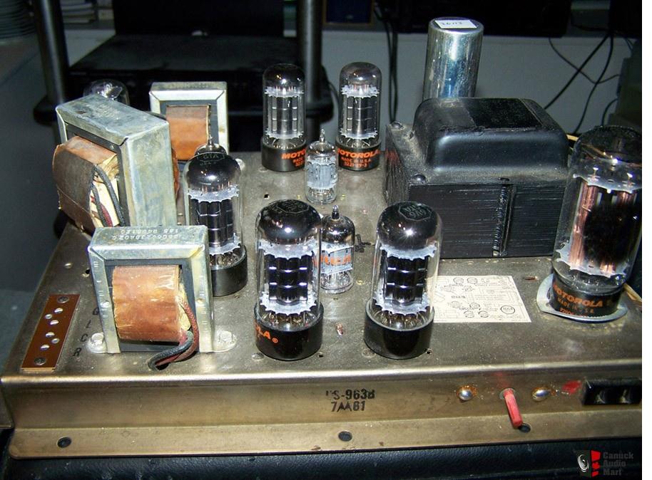

I just got this phonograph/record player from my parents and wondering about it's quality and would it be worth refurbishing, plus adding an auxiliary to it for an mp3 player. Its a Magnavox Stereophonic and sounds ok through the radio but I need a new needle for the record player. I assume update the caps, the tubes are all running well and what else would need to be cleaned (ie tube sockets etc...)

The turntable/cartridge is a piezoelectric POS, which can destroy valuable records. :( It should go!
It looks like the amp uses PP 6V6 O/P tubes and an EZ81/6CA4 rectifier.
It's blurred and I can't be sure, but you may have an AUX position on the source selector. That's where an external, line level, source (like a CDP or MP3 player) would attach.
Are you going to use the console's speakers? As is frequently the case with console amps, the O/P "iron" is not "meaty". Circuit modifications, including triode wired "finals", would allow for maximum fidelity in reproduction. The price of doing that is an approx. 50% reduction in O/P power and the need to use mid to upper 90s dB. sensitive speakers.
The 6V6 O/P tubes are nice...I have a Motorolla unit with a similar topology (also a console pull) that's quite nice, indeed, after a re-cap...
Small output iron aside, mated to the right spkrs, as Eli mentions, your amp should yield very nice results...

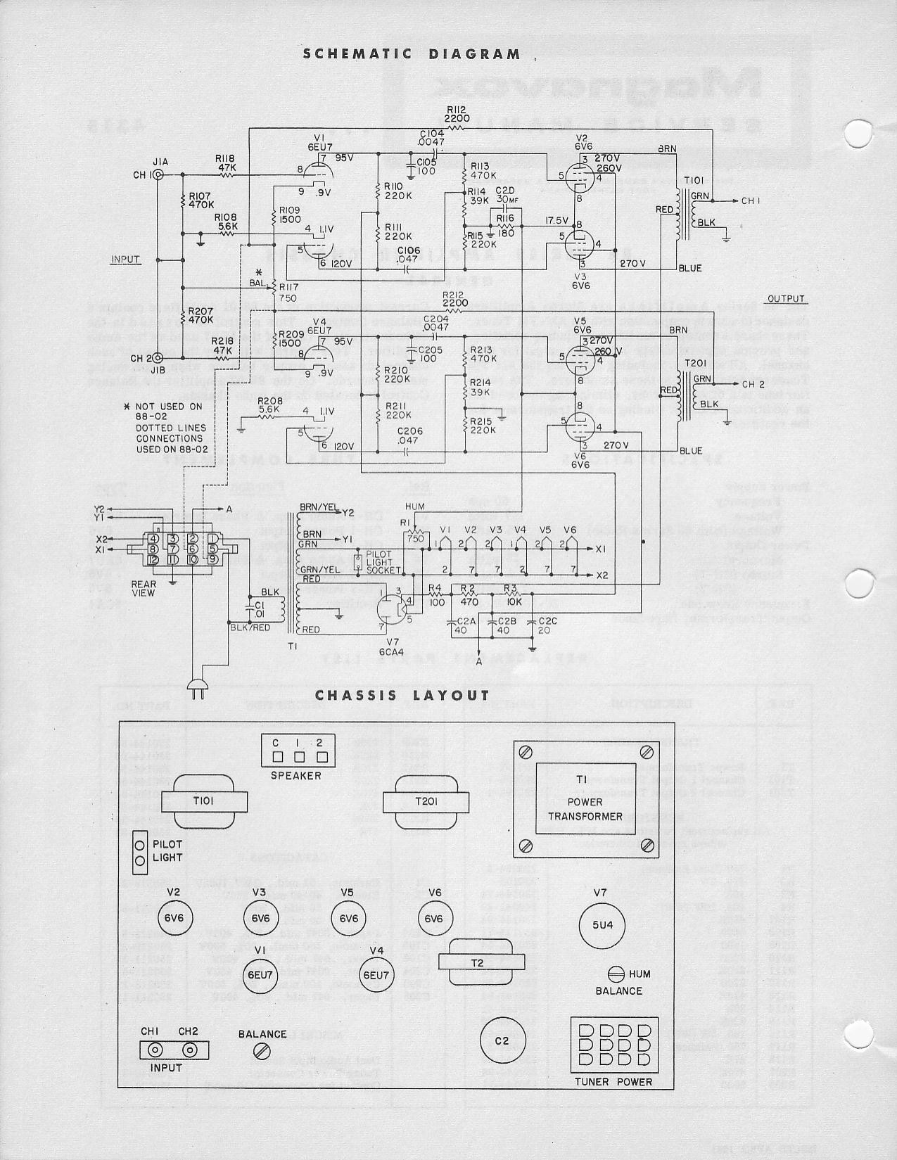

The graphic Bruce uploaded provides us with lots of info. Unfortunately, corners were cut in this design. The 6CA4/EZ81 is rated for 150 mA. and it's being asked to provide a good deal more. :( Please observe that the tuner/preamp gets its B+ from the same supply as the power amp.
The editorial error on the graphic of saying 5U4 instead of 6CA4 is a history lesson. A previous version of the console amp used a 5U4, which is adequately rated at 250 mA. The manufacturer saved money by simplifying the power trafo (no 5 VAC winding), using a less costly tube, and a less expensive socket. The phenomenon of "shafting" the customer for a bit more profit is not new. Grrr!!
IMO, the easiest solution to the overworked B+ rectifier is to switch to SS diodes. That will raise the rail voltage, which is something that can be taken advantage of. The operating point of the 6V6s will be more favorable. :D
6EU7s are scarce and priced accordingly. Fortunately, the triodes in the bottle are the same as those in a 12AX7. Rewire the sockets and install Sovtek 12AX7LPS tubes. The 'LPS contains a spiral wound, hum bucking, heater, like the 6EU7 contains. :)
Ok I have put in a 3 prong power chord and replaced some caps. I also installed a volume knob onto the amp portion. I plugged in my mp3 to the input on the amp and get about 1/10th the power I had when I ran it through the tuner. I assume the tuner had a pretty loud preamp in it. Can I reattach the tuner just to the power supply on the amp and then run an mp3 player through the tuner to get the increased sound level back or do I need to reattach all of the cables attaching the tuner to the amp? does the tuner adjust bass, treble and volume from within itself before it goes to the amp input?
