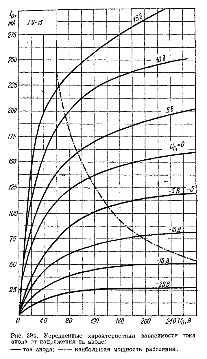

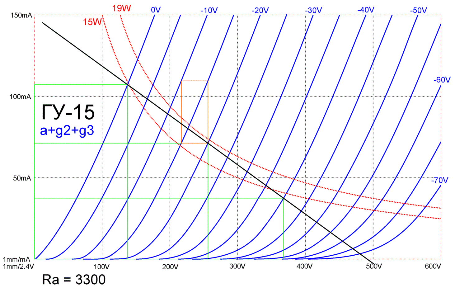

hello every body, i recently got a box of ry15 (russian version of GU15). the seller told me it was a wonderful small DHT. diyers locally usually connect the tube ad triode to build the single ended schematics,i want to redesign it as a pushpull one.unluckily enough, i got no plot of its triode connection. could you help me with that tiny wonderful small DHT?
did anyone use this tube? I got 8 pcs last week. Any good datasheet? What is max anode dissipation? Maybe triode curves?
Maybe this help.... ''GSTube.com''. Tubes, sockets etc. Parameters and characteristics GU-15 and this GU15 | Tubes Information....
I also found that datas. Txy anyway.
Does anybody know the max ratings? Anode dissipation? ETC...
THX a lot. In triode mode looks quite linear.
