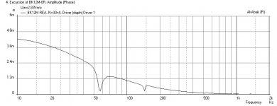

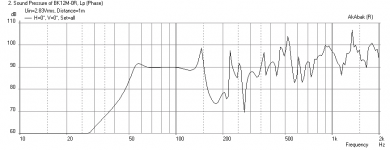

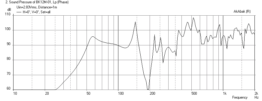

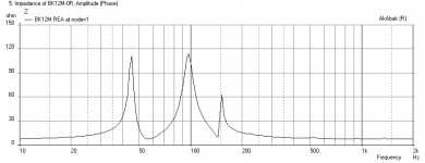

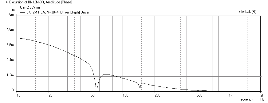

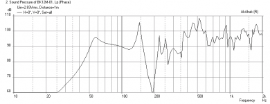

Making the horn mouth in the back completely changes the speaker, both the sound and layout as driver chamber needs to be positioned to allow driver access to back wall which now becomes baffle. You might look at DNA or Busch horn designs. Although it would be interesting to see a sim of the BK12 with a rear firing horn. I might give it a go in Akabak.... it is no longer a BK12.
Sim of rear facing horn
If you could rearrange the mouth to be rear firing, here is how it may look as an Akabak simulation. The bass level is reduced a bit but appears to be flatter. There may be some benefit to a rear facing horn. The first plot is the BK12M as front horn, then rear horn, displacement, and impedance plots. This is with the speaker located 72 in away from a back wall, 1 watt input with sound pressure at 1 m away from driver centerline. The driver cone displacement is rather high (1.2 mm at 1 watt) given that xmax for FE126EN is only 0.3 mm.

The FH3 is a tapped hypex rear horn with no driver chamber - a very different design and will sound different than flipping mouth of BK12 to the back. Interestingly, I put a FF105WK into the sim and reduced driver chamber vol to 1.2 liters and it works pretty well. It has more xmax so won't be running into the excursion limit as easily as FE126EN and it's bass will be more balanced with its lower SPL for higher frequencies.
