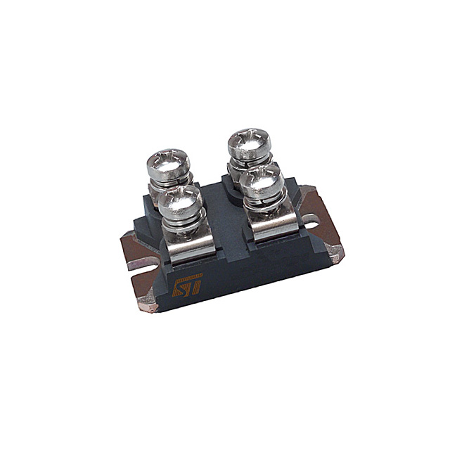

I suppose that the package is the limiting problem.
Behringer PMP880S, 3000 and PMP5000.
Mmm, speaking of a nice rock solid package.
