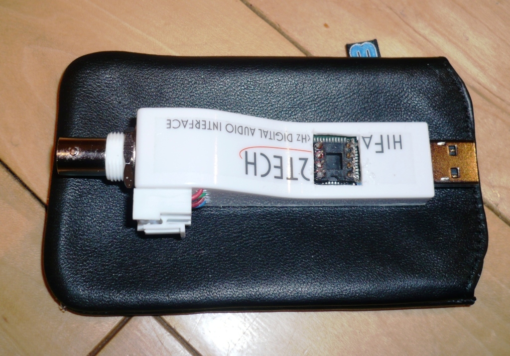

Somebody asked me to post pics of the modded, cased unit - so here they are:
The first one is with battery attached & the second is the unit sitting on a Ipod Touch leather case
