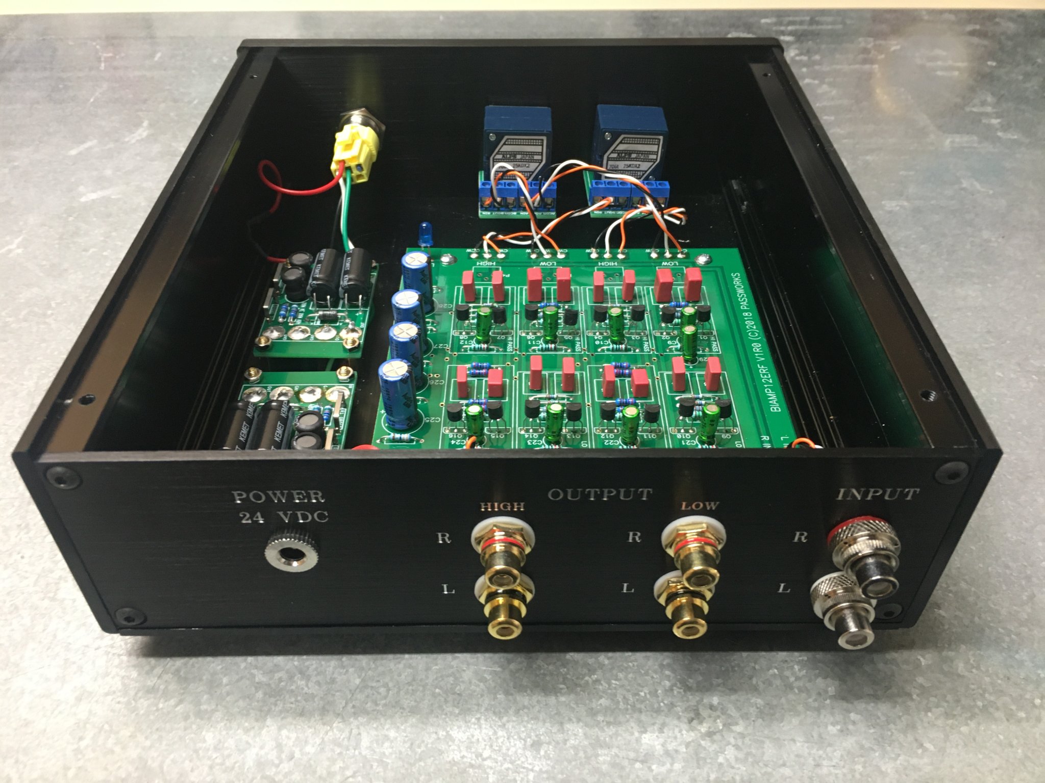

I can't speak for the LX mini speakers, I'm using SLOB with CUBE FC-8 full range and Eminence 4015 15" woofers.
I started with using the P channel VFET amp for the full range drivers and an N channel VFET for the woofers. I had no trouble balancing the treble and bass using the input pots on the xover. I thought I was crazy trying to drive the 15" woofers with the 7 - 10 watt VFET amp, yet it worked just fine.
I have since swapped out the N channel VFET with a FIRSTWATT J2 clone. The input pots on the xover are now both set to zero and the bass sound seems fuller, probably due to the SiC JFET output devices.
10 years ago, I never would have considered buying an amp that wasn't at LEAST 100 W/channel, I even sold my McIntosh amp (which I had lusted after for years), after building the M2x. I no longer worry about amplifier wattage anymore, which I feel is similar to "range anxiety" with EV's.
I do recommend using input pots on the xover which can be mounted on the front panel for ease of adjustment. I used the blue ALPS pots on mine, I wasn't concerned about using very high quality pots on the inputs since I only adjust them when I swap amps. I did however, swap the J113 for 2SK170's in the signal path, I wanted lower noise and I had lots of them in stock.

...I've read about a minimum power requirements for this system, but the XA-25 I am sure can get the job done. My doubt is about the Vfet which is only 10w...
At 93db sensitivity and since the minimum power requirement for the speaker is 10 watts, I think this would be a winning combination as long as you don't expect to play them at concert levels all day and night. For normal listening the VFET is magical on compression drivers. Try it and report back! Also, pictures would be appreciated. 🍿
