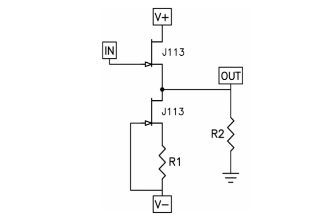

Yes, thank you for the nice article Mr Pass. Great to see that a simple buffer using dual JFET (J113) in SE Class A can be used instead of opamps for a buffer in between the filter blocks rather than opamps.

There was a thread a while ago about a "B1 active crossover" where some of us discussed using BF862. (I never had the time to build one.) Would BF862 work well in place of J113 here? They're very low-noise... I presume the biasing resistors would need to be adjusted, although I don't know how. Since the whole circuit is very low-power you could presumably use little adaptor boards like juma used in a thread ages ago and not have trouble with heat.
Alternatively, maybe a little DIP-8 adaptor board could include both jfets and little surface-mount resistors, so the buffers would have the same footprint as an op-amp. (Although this wouldn't fit the PCBs of course...)
Thanks for the fascinating article!
