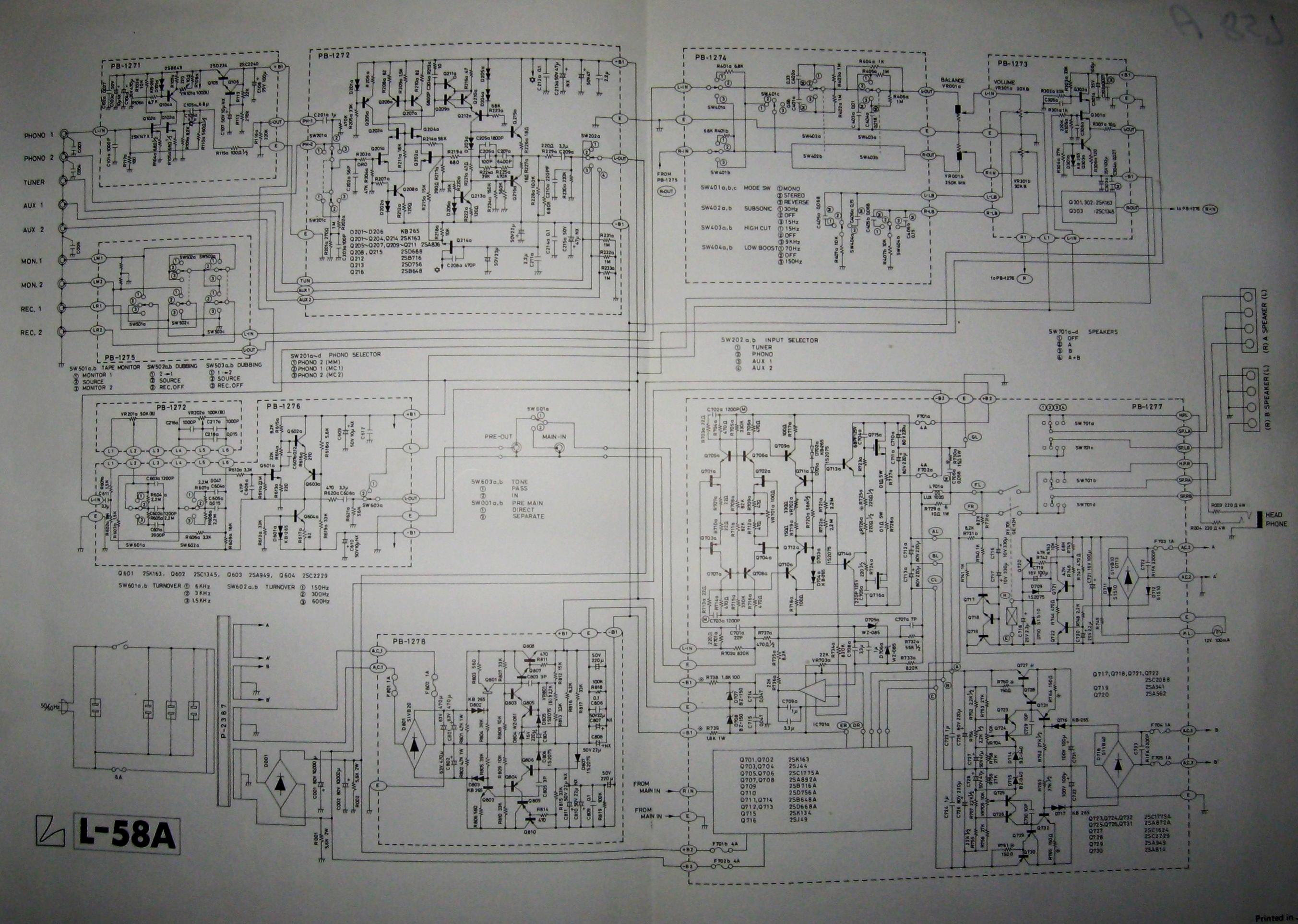

I have just bought a very nice Luxman L58A still working - But , the circuit for the amplifier part showed, that Luxman for the input differential stage has used 2SK163 and 2SJ44 from NEC.
It is possible to buy the 2SK163 in Europe but impossible to find the complementary 2SJ44.
Does anyone know if there is a substitute pair of fet's available with the approx. same spec's?
Have just bought the output fet's - the original were 134/49 but the 2Sk135/2SJ50 bought takes 160V instead of the original 140V.
Any help would be appreciated.

I'm looking for a repair manual schematic of a L58A amplifier. I've downloaded and payed for several pdf wich supposed to be the right schematic but it was for the 55a ampli, Do you have the correct one.
Well - I have just received a scanned copy of the Luxman L58A schematic.
I was about to open a new thread to see whether someone has a better scan or pdf?

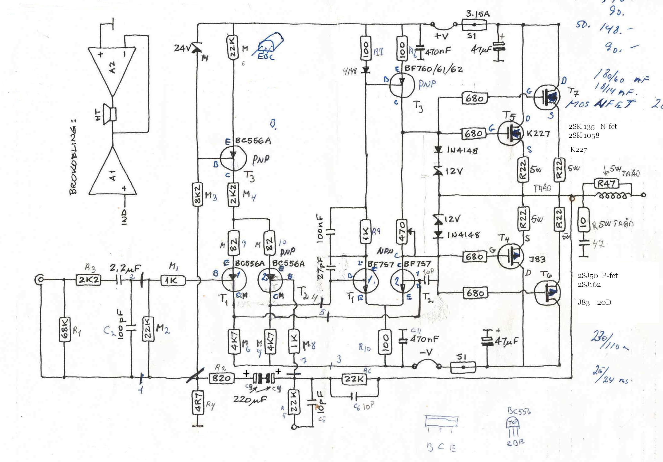

Seems that you know a lot about fet's - which I don't. I have worked with some valve amplifiers, and my old and long gone mosfet amplifier turns up constantly in my memory. - Same sound filosofy as valve amps.
Find the circuit attached.
I have listened a lot to my L58A from Luxman and like the sound very much, but irritated because of the lack of power - uses AR3a speakers.
Would like to built with 2SJ50/2SK135 ( have 8 pairs) and use the Luxman driver circuit. Which input devises could be used as replacement in L58A and used in a similar mosfet amplifier like the one attached?
Kim

After I have heard a symmetrical mosfetamp with a differential fet inputstage (the L58A) I would like to built one. What is your opinion of the 2SJ74/2SK170 as inputfets? The old asymmetrical 100W poweramp attached erlier was quite well sounding without servo. The L58A schematic shows a servo, and as far as I can remember the sound from L58A is a little more detailed.
Do you recommend fet input? - and servo? - and symmetrical/ asymmetrical design?
Rgds.

i have a question about the luxman schematic;
first off, in a bunch of old components i found a bzx75c 2v8, which is so old it is in a Ge-diode like black glass case, and which i wanted to use as ccs reference perhaps, and i tried to measure if it works ok, with the diode test of my dmm, the voltage drop both ways is out of range of it (so i figured perhaps broken), but, with a very large resistor, fed by the hv of my amp as test, the breakdown the "forward" way is 2v3 (fraction of mA current btw), and the reverse "zener" breakdown voltage is 150V lol (note it is not changed by the test). i wondered, can it be that it is 4 forward junctions in series, kin like the references in the luxmann schematic?

no, i do not have such amp (so offtopic perhaps), however as i peered over the schematic i noticed those double series diodes as reference for the vartious ccs'es (or so it appears to me) and i already wondered of this 2v8 zener i have (unrelated to such amp) is just 4x0,7V forward junctions in series (say 4x 1n4148 in a black thinlead ge-diode glass casing) however i am sure it is a silicon device, because it is a "B" device (silicon).
what is the voltage of the reference diodes in the luxman amp btw?
The L58 has some drawbacks...
first, the power amp stage has a very high gain
of about 120..I suppose that it allow for preamp
circuits to work with low gain and reduce distorsion
of these first stages, but then, the power stage
lose some available feedback to reduce THD..
Second, the power mosfets drivers work at low current,
typically about 3 mA , wich is not enough...
Third, it seems that the cascoded differential stage work
with a relatively high current , so the bjt cascodes have
to dissipate something like 250mW each, wich is too much
for the 2SA872/2SC1775 ....
All in all, it s a pity, since the general design ideas are
fairly good but the practical implementation is not up
to these ambitions...
