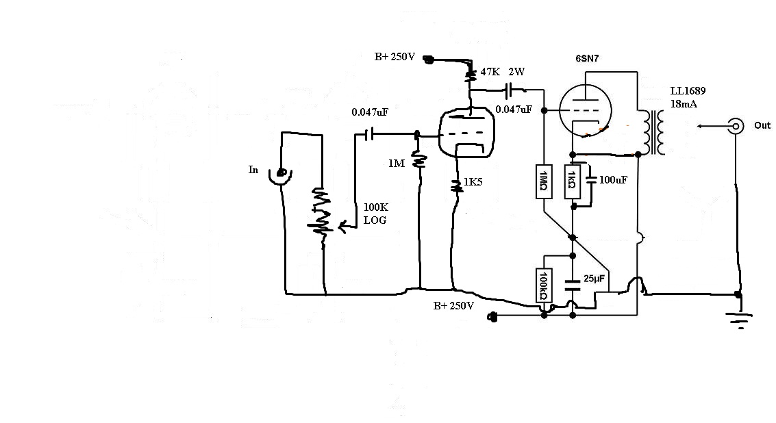

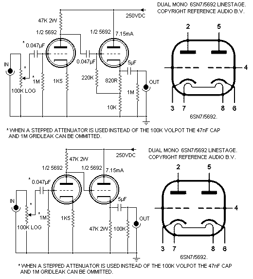

As I mentioned above: At a certain point you should just start and build it. Then see how it works. Measure it and listen to it. Modify if needed and observe the changes that brings. This circuit is easy enough to get started.
If you want to know the currents. Look up the 6SN7 datasheet. Put the op points into the plate curves and get the currents from there.

Hi!

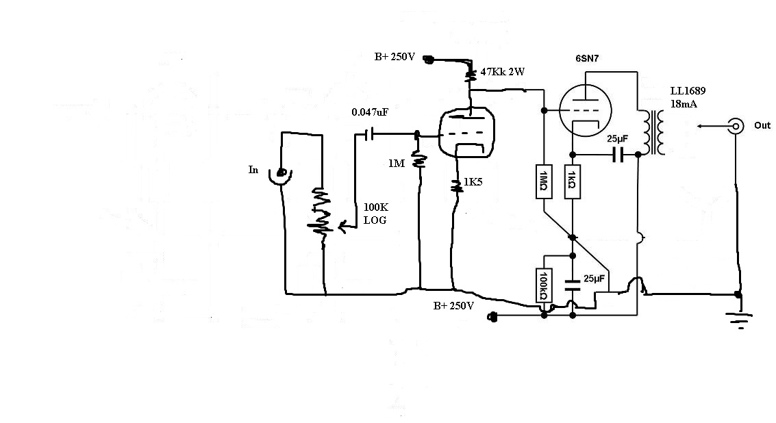

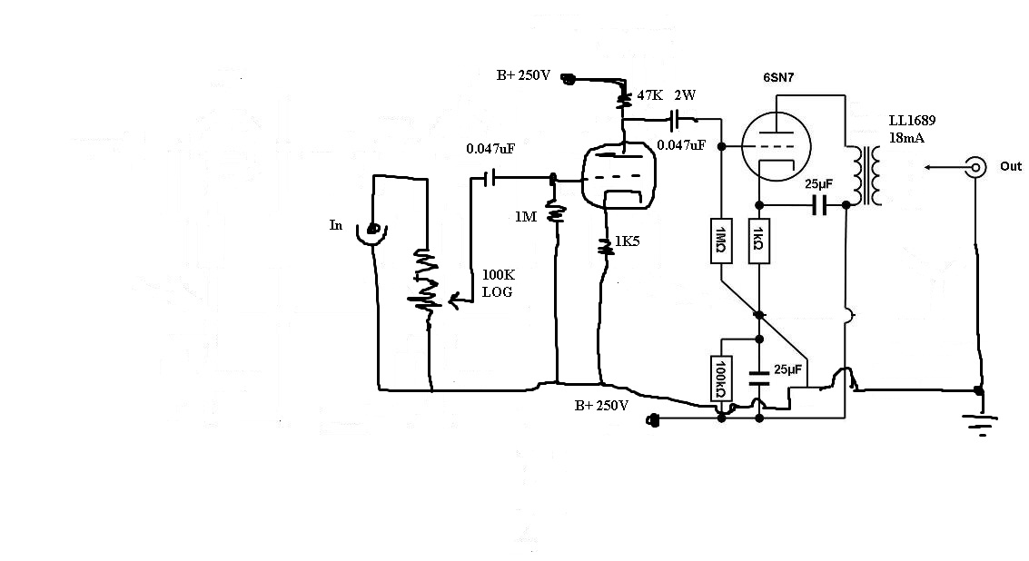

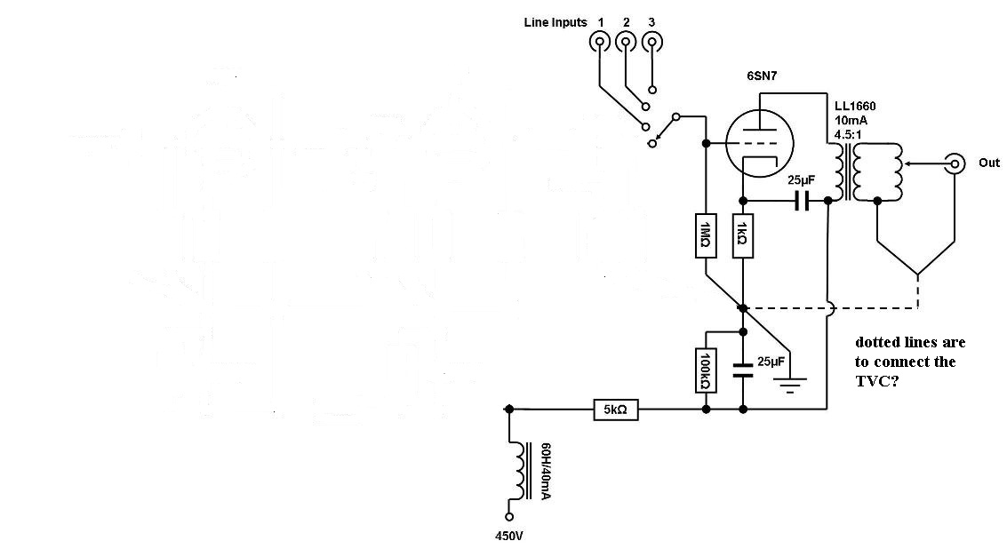

It is available for different currents. If you use one system of a 6SN7 only use the 10mA. If you use parallel 6SN7, use the 18mA (in that case the cathode R needs to be halved to 500Ohms).
Connection alternative Alt Q for 9:1 and Alt R for 18:1 for very low Zout

Near 8mA
I see all these Lundahls LL1689 models, only to be sure for Senhs 300 ohms have to be wired Alt Q for 18:2, right?
LL1689-18 218-071-68 9+9 : 1+1+1+1+1. Interstage, for tube applications 18 90H

Hi!
I just checked what I have: 11mA, 18mA, 25mA and 36mA. It is also available for PP or 9mA
11 or 9mA will be fine for half a 6SN7 the difference is negligible, the 11mA allows more room for experimentation with current.
The AM models are about twice as expensive. They have amorphous cores. I am not a friend of the AM versions. I prefer the standard cores sound wise.
You can easily try both and see what you like better. It is a matter of 5 minutes to change between 18:2 or 18:1
