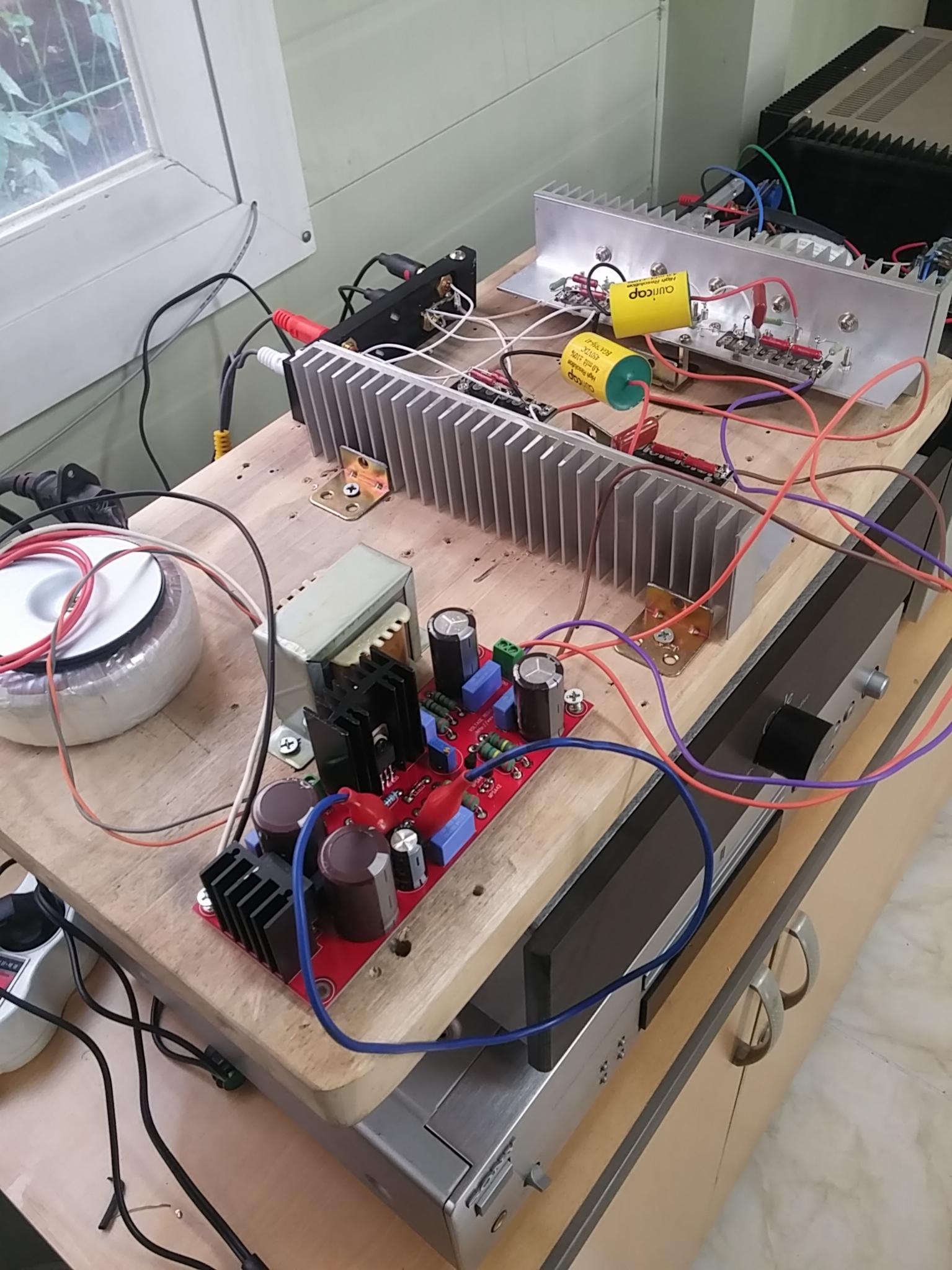

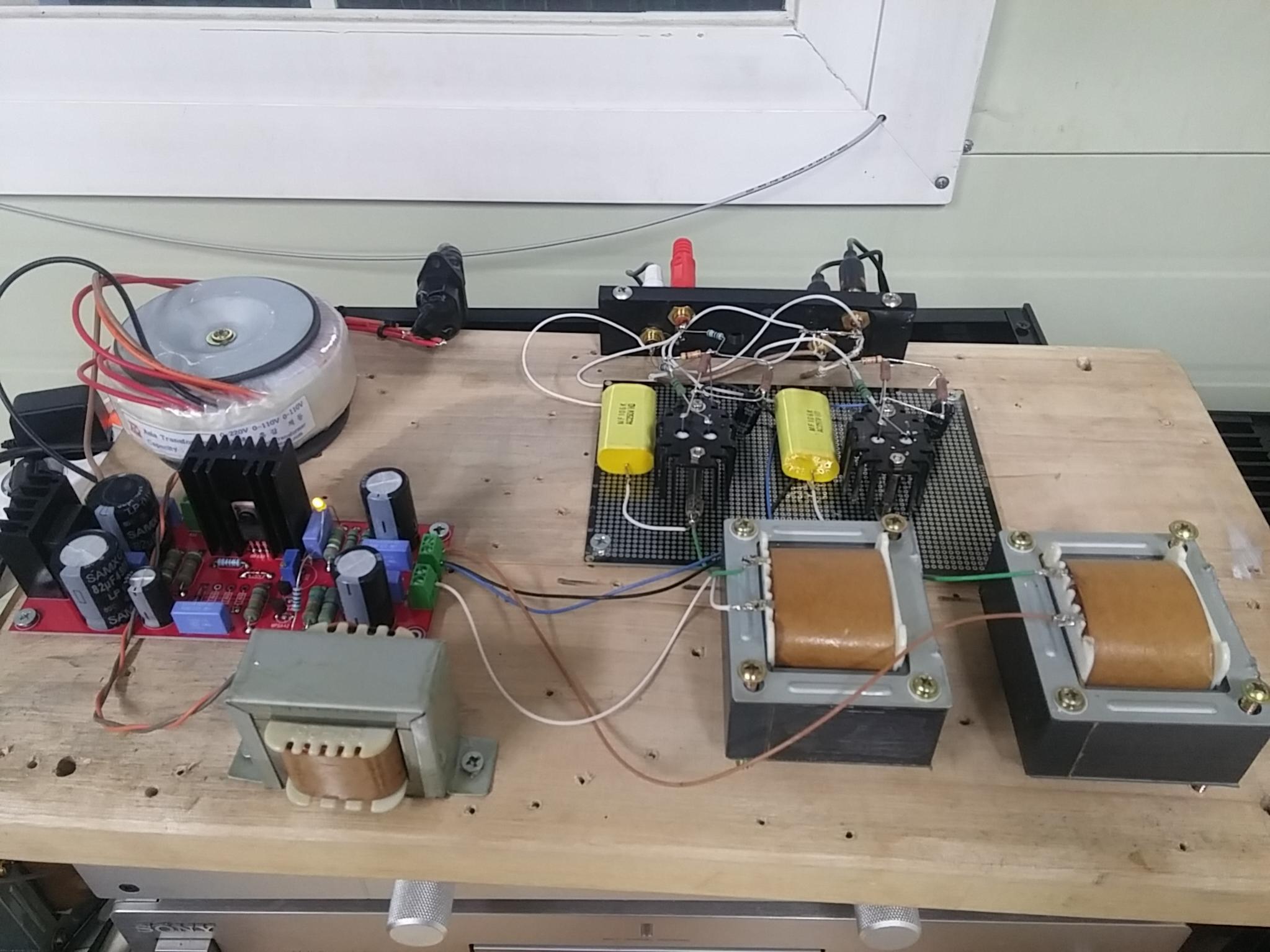

Hi all,
I built Luminaria with help from cwtim01 and also played with 2SK60, aiming at the half current of 2SK82 at the same Vds and Vgs. I used self bias and random choke load from my part box. I even tried Aikido circuit with eight 2SK60s and it has been fun really. Please forgive my lousy work on the cutting board, I only wanted to taste the sound. :rolleyes:
2SK60 in simple circuit sounds good already, with simple regulated supply and a these simple parts. I do not now how to fine tune the circuit but this is promising indeed...
What does this mean? We need to be patient and wait for Mike to come up with his tweaking.. :)
