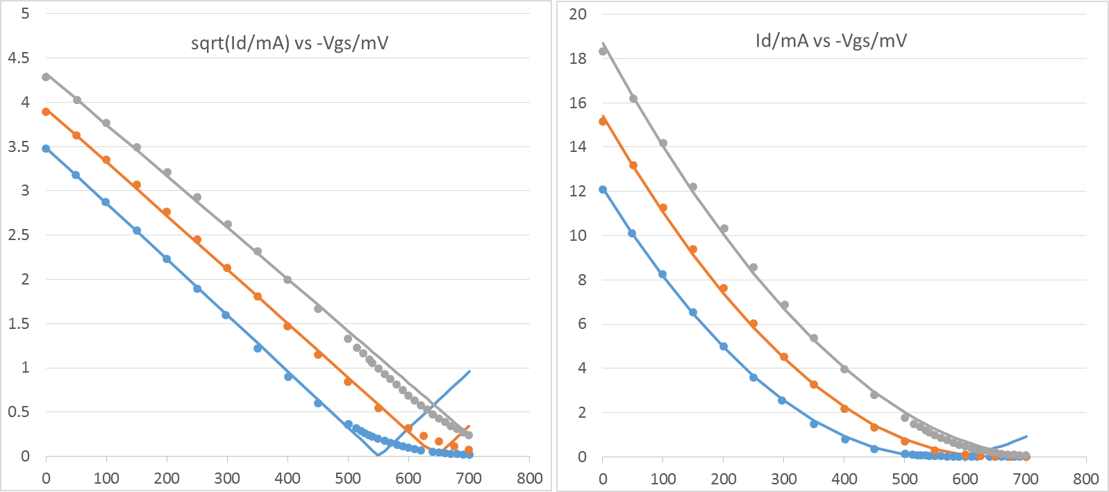

I've been wanting to model and simulate the BF862 JFETs I own in circuits I am considering.
In particular I wanted to understand how device variations (as characterised e.g. by different Idss) play out in a circuit.

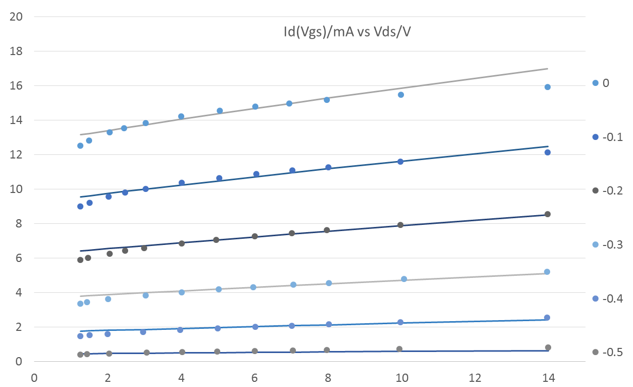

To this end I measured the device characteristics of 14 JFETs and fitted the LTSPICE model for the saturation region.
I can model my devices fairly well by fitting 7 parameters, i.e.
VTO = -0.02280 * Idss/mA - 0.2508
beta = 0.001777 * Idss/mA + 0.02304
Rs = 0.5137 * Idss/mA - 0.5590
lambda = 0.03663
The RMS error between measured and modelled Id values is 110uA for 257 data points taken from 14 different BF862 with Idss ranging from 12.07 to 18.33mA.
For all 14 JFETs I captured Ids at Vds = 8V and Vgs= 0 .. -0.5V in 0.1V steps
For three devices (Idss = Id(Vds=8V) = 12.07, 15.17, 18.33) I took Id from Vds = 1.26V to 14V and Vgs = 0 .. -0.5V
The results I fitted for 2.5V <= Vds <= 10V using the model that LTSPICE uses for Id in the saturation region, including the effect of a finite source resistance Rs.
I used one common parameter lambda for all devices and modelled Rs, beta and VTO to depend linearly on Idss.
The result of the fit to the Id, Vds, Vgs array for one JFET is shown in the first attachment.

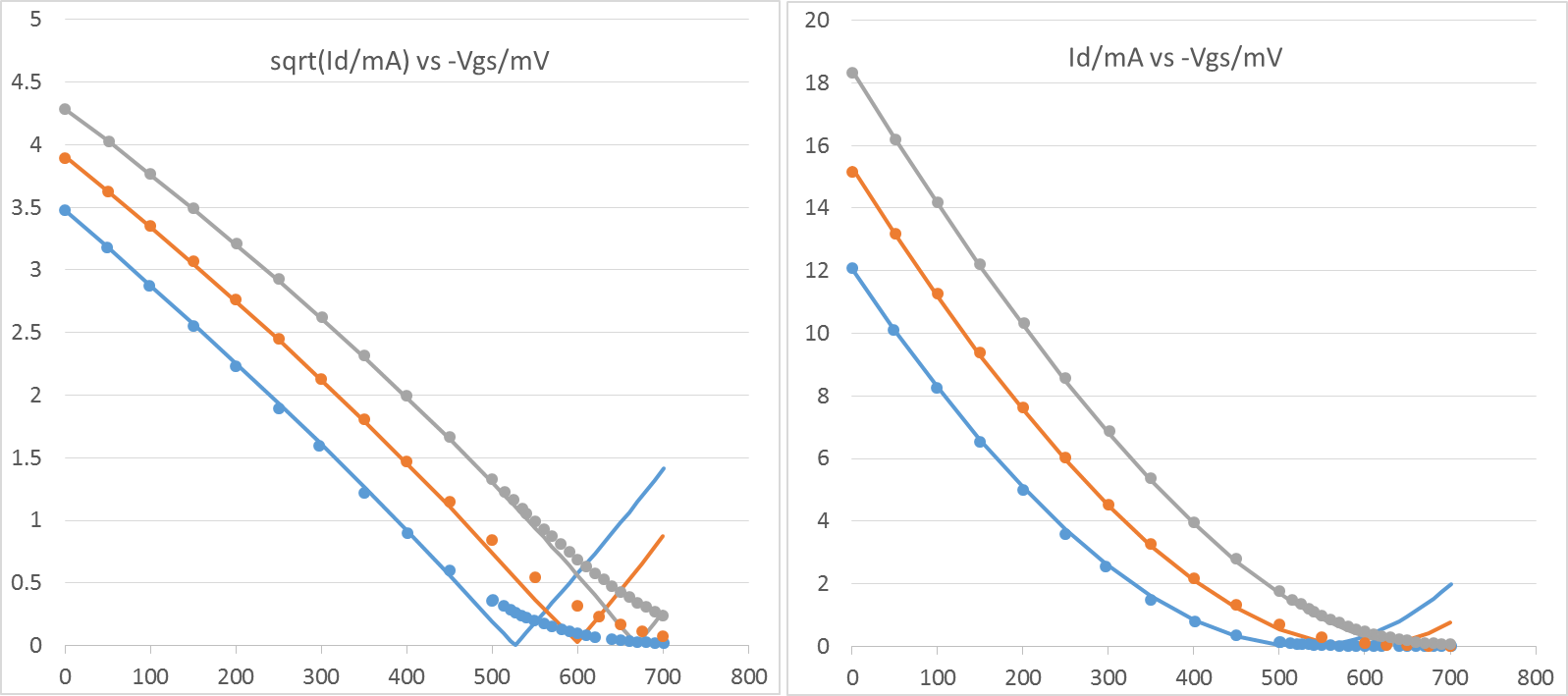

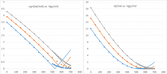

The second attachment shows measurements of the top, bottom and middle Idss JFETS in my sample of devices (Idss = 12.07, 15.17, 18.33) and the modelled Id curves for fixed Vds = 8V. The data are plotted both as sqrt(Id) and Id.
In the sqrt(Id)-plot note that the measured data are curved downward and deviate from a straight line implied by the basic JFET model. In the model this curvature is provided by finite Rs.
Also the model NXP publish for the BF862 on their website sports a Rs of 7.5 Ohm.
LTSPICE will produce the desired Id values in the saturation region when fed with only the four given parameters. However a more complete model for e.g. the Idss = 15.17mA device could be

Edit: as per keantoken's hint you can adapt your ltspice simulations to the Idss of your devices simply by using your favorite BF862 model (e.g. the one above) and then altering it via
Code:
.param Idss = 15
.model BF862Idss ako:BF862 beta={0.001777*Idss+0.02304} VTO={-0.0228*Idss-0.2508} Rs={0.5137*Idss-0.559}
That way you can even .step through different devices.

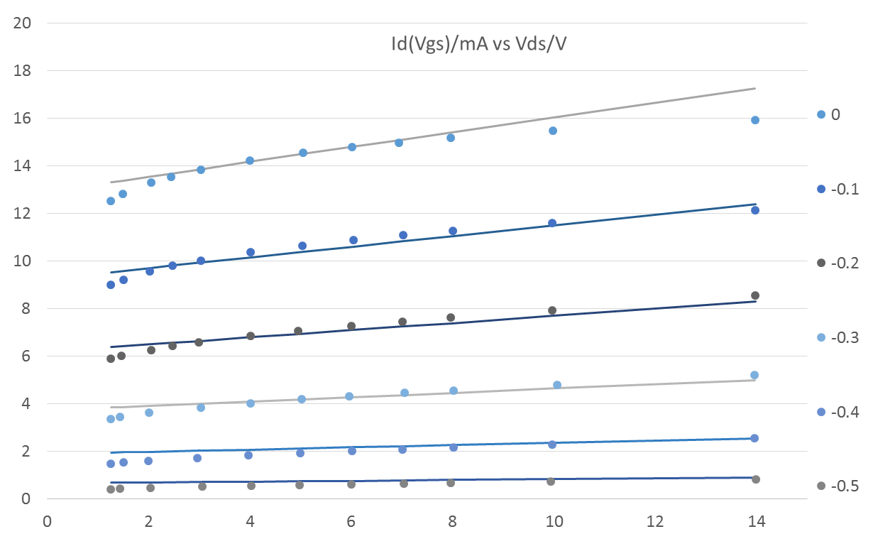

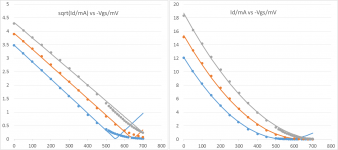

Rs = 0.5
If you feel that Rs shouldn’t be device specific and rather a constant of 0.5 established by a different experiment the fit naturally gets worse.
The first and second attachments in this post show the resulting fit to the same (Id, Vds, Vgs) arrays as before.
RMS error is 185uA.
The coefficients to derive beta and VTO from Idss in this setting are given as
beta = -0.0007956 * Idss/mA + 0.04376
VTO = -0.03038 * Idss/mA - 0.1840
with
lambda = 0.02524
Rs = 0.5

The point with Rs here is that IMHO it is not a physical quantity like the bonding wire resistance inside the package. It is a fitting parameter that helps to bend the sqrt(Id) curves to match the data. And it works very well...

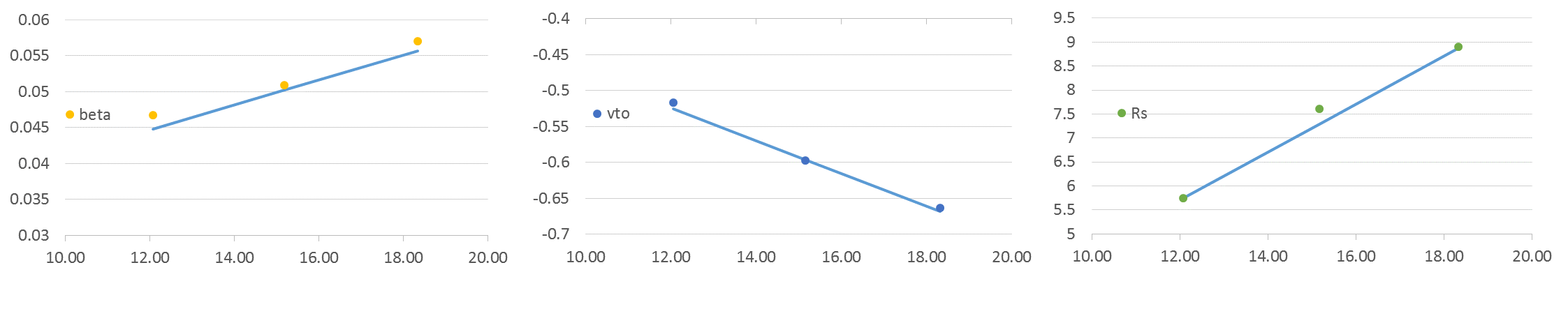

Could you show how well these match the fitted VTO, BETA, and RS of your three devices (Idss = Id(Vds=8V) = 12.07, 15.17, 18.33) ?
Since you asked so nicely here are the parameters for individual fits to the data of each of the three devices (still common lambda).
Points are individual fits, lines are the linear relationships for all data as cited above. All shown over Idss/mA.

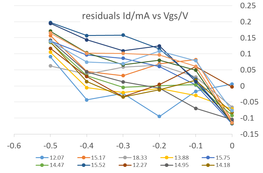

Thanks for explaining, I think I understand. It would be reassuring to see the measured-vs-spicemodel data for two of those 14 devices: (i) the device with the largest positive difference between measured and modeled; (ii) the device with the largest negative difference between measured and modeled.
Of course this might open a can of worms: how do you define "difference" i.e. "error"? Is it (measured-modeled)^2 ? Is it |measured-modeled| ? Is it ((measured-modeled)/measured)^2 ? etc. Each of these are reasonable choices and there are other reasonable choices too. But however you have chosen to define fitting error, there exists two devices with the greatest error, and people considering adopting your models are probably interested to know "how bad can it get"?
I can show you the residuals for the Vds = 8V data, so you can have a look "how bad it can get". And I chose (measured-modeled)^2 as you surely already guessed from the RMS error given in uA.

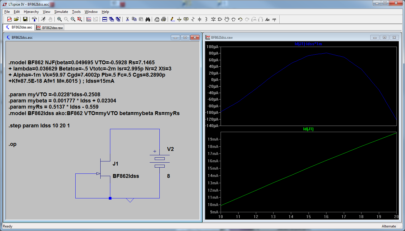

Yep, that is a saner way to do it, if you have equations for the parameters that get changed. Much better than cycling through a list.
The equations can be put in the model or AKO model using curly brackets:
.model BF862 NJF(beta=0.049695 VTO=-0.5928 Rs=7.1465
+ lambda=0.036629 Betatce=-.5 Vtotc=-2m Isr=2.995p Nr=2 Xti=3
+ Alpha=-1m Vk=59.97 Cgd=7.4002p Pb=.5 Fc=.5 Cgs=8.2890p
+Kf=87.5E-18 Af=1 M=.6015 ) ; Idss=15mA
If you put this in your standard.jft or .lib/.inc it, LTspice may complain if you do not have the IDSS parameter specified on your schematic.
