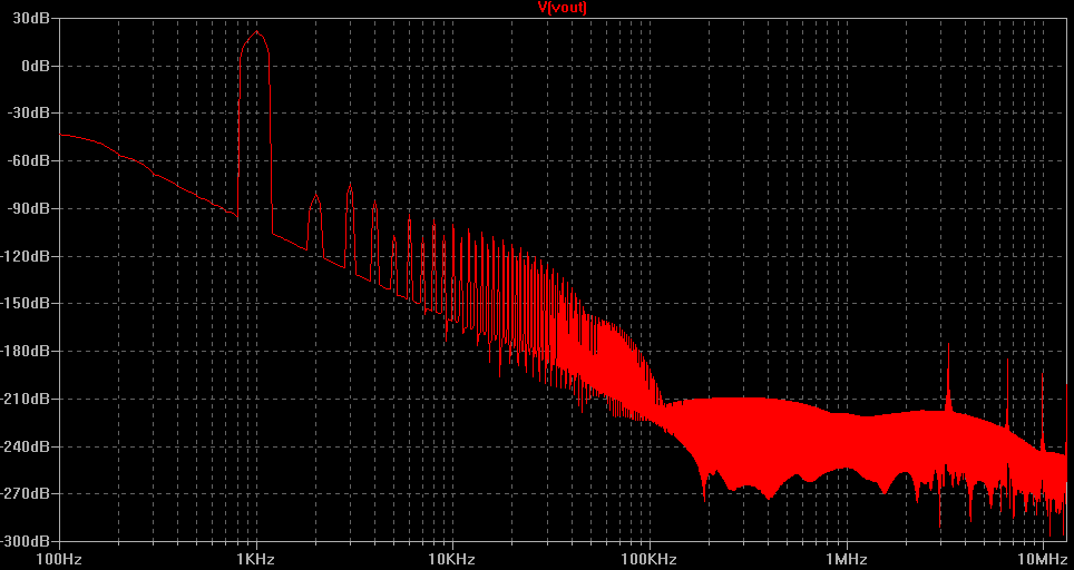

Here is an FFT of my latest creation. It is an all-BJT class AB amp with a rather unconventional input stage and stability compensation. This is at 18V into 6R. Does this look like a "good" spectrum to you? It sounds incredible on my bench!
Those spikes up in the MHz area.. are those the frequencies where the amplifier is prone to oscillation...?? The high order order (Above 4th) are typical for amplifers with hard turn on/off of the output bjt's... You can simulate deeper in the circuit if you disconnect the servo and magke caps big...1F
Those spikes are artefacts of the FFT. My FFT is actually set at several times more samples than my simulation. The spike occur where the frequency resolution of the input samples runs out, and after that the FFT just makes up stuff... Man I wish SPICE wasn't like this.
The amp is actually quite stable.
It's how it sounds to you that matters most. The 3Khz 3rd harmonic is perhaps a little prominent but that's probably output stage related. If you make the load 60 ohms instead of 6 it will probably disappear. If you like what you hear then pursue the design further. See how the distortion changes into different speaker impedances...

Unless the circuit has settled, you can't be sure in THD. Due to "Simple twist of fate" you can get lower than in reality THD - the settling curve spectrum components may incidentally have opposite phase with WRT THD components you are trying to measure.
This would seem to have the worst effect on rectangular windowing because it has so much spectrum leakage.
In my simulations and with the command set I provided, the first several cycles are not recorded, allowing the impulse caused by the suddenly starting sine wave to dissipate. After this only very low frequency spectral components are left. I always make sure the drift spectral leakage is well below the harmonic levels, say 40db, in which case the harmonics are not altered by more than 1%.
Gootee, there is also the option in Control Panel -> Waveforms to replace "ohm" with the omega symbol, this makes the scale less crammed.
If you have an expression like 1/Ie(Q7) and you want the display to indicate ohms, you need in indicate the the 1 is a voltage. So if you use the expression 1V/Ie(Q7) the scale will indicate ohms.
This would seem to have the worst effect on rectangular windowing because it has so much spectrum leakage. ...
Rectangular window has the minimal spectral leakage. I think you confuse spectral leakage due to window with spectrum leakage due to non-bin frequencies. Essentially, when apply a window you exchange one for the other.
If you multiply input set of samples by bell-like window, you do amplitude modulation using as the modulating signal half-sine (for Hanning window) wave whose period is 2 * N where N is number of samples.
Amplitude modulation causes appearance of two side bands - each side band is +/-F, where Fm is the modulating frequency, from your carrier.
I.e. by applying bell-like window you create for every spectral component (for every FFT bin) two sidebands, hence the spectral leakage.
Since the bell-like window looks more or less like half sine wave, it spectrum is not limited to 1 / (2 * N) sidebands.
To make long story short, when you apply bell-like window, you cheat. You cheat in favor of getting rid of unpleasant artifacts, but the artifacts is the reality of DFT.
In order not cheat let the simulation settle as I wrote above.
