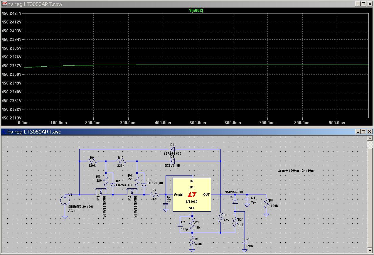

In the Power Supply Section of the new edition of "Art of Electronics" a simple HV regulator using Linear Tech's LT3080. This seems to work nicely:

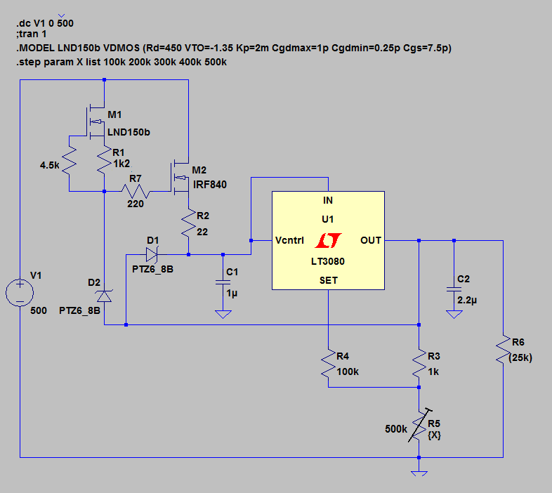

What if we raise the bar a bit and make it more useable by getting rid of the CCS and instead use resistors and a cascade of mosfets to raise useable current to lets say 200mA and share the HV drop to 2 mosfets? In the simulation seems to be able to handle shorts but c3 puzzles me a bit in case of direct short circuit.

D1 shouldn't make a difference, and that's how it's shown in Figure 9.113 of the new AofE.
The cap on Iset's resistor isn't necessary at this point, but is discussed over a few paragraphs in the datasheet.

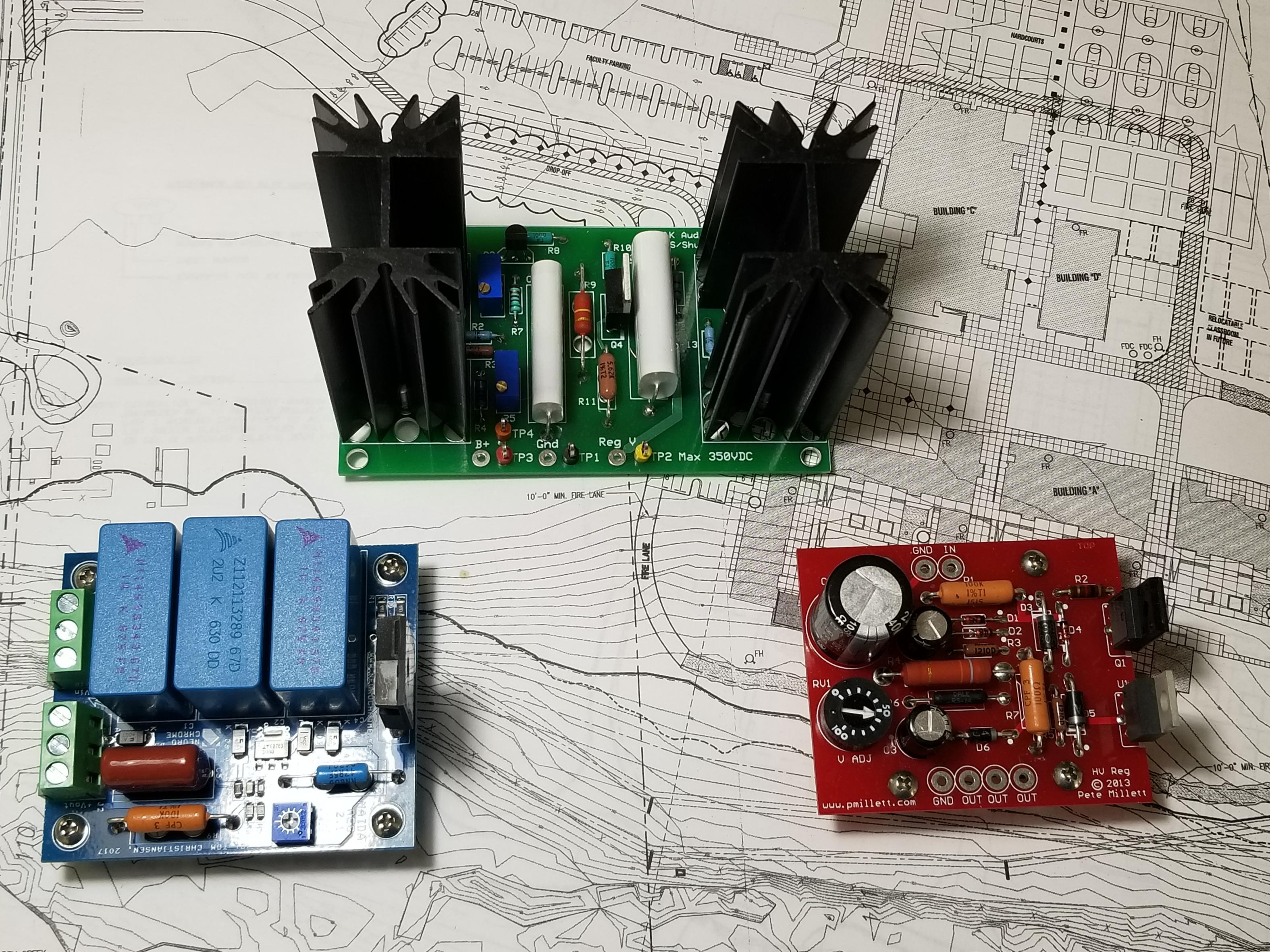

To put this into perspective I am making a SET 12B4A headphone amplifier. First the goal is to get the noise floor as quiet as possible for as few dollars as possible. The next step is to tune the 12B4A SET to minimize the FFT harmonic profile. That leads to optimizing the signal to noise Raito at the equivalent output of 90dB into Audeze LCD-2 headphones. (About 1 v RMS into 70ohms)
I have assembled the three different regulators; one of Pete’s, one of Tom’s and a Salas style HV Shunt from K&K Audio.
I will test these with the AP 2522 on the bench.

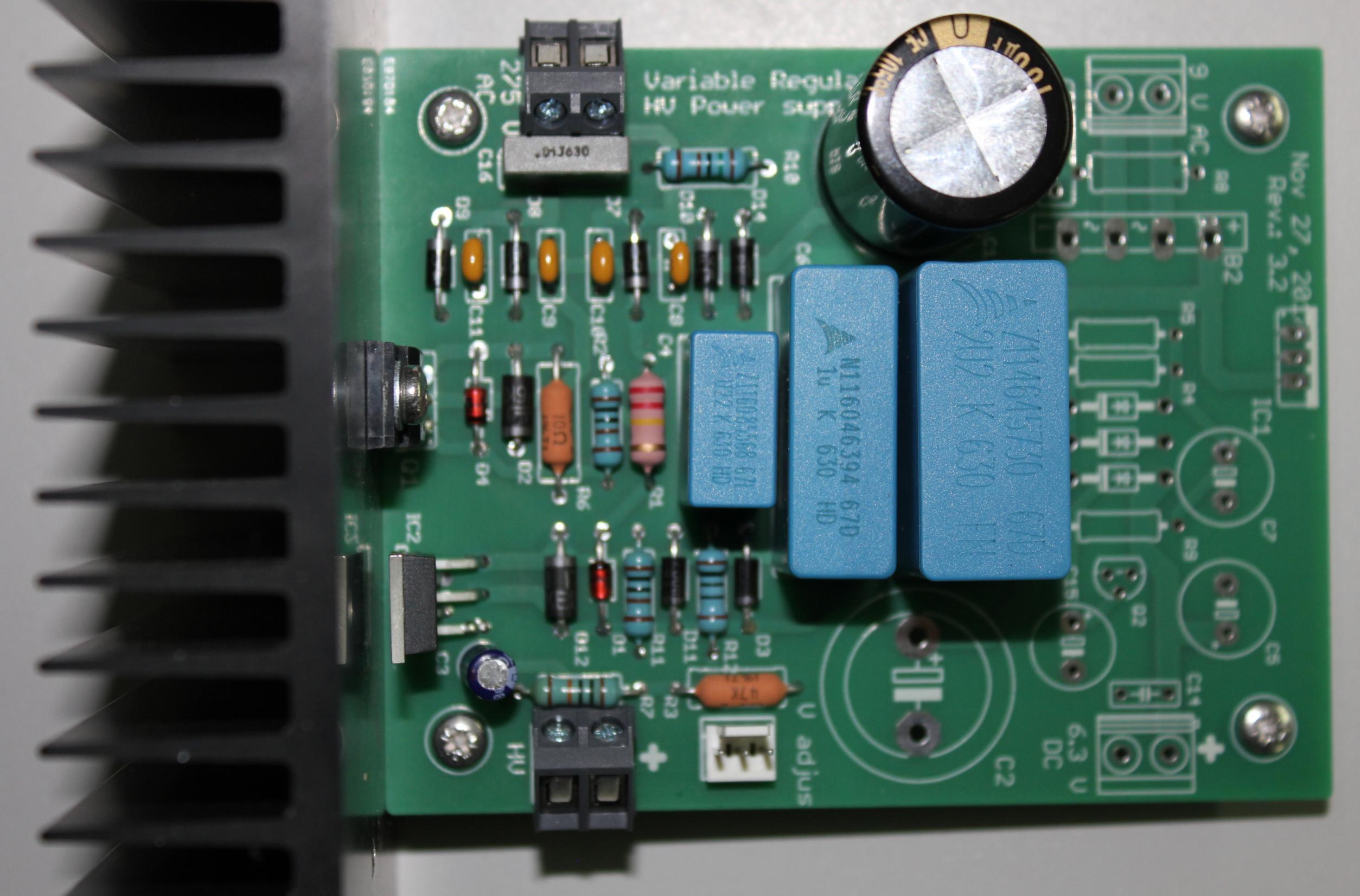

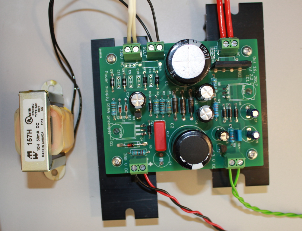

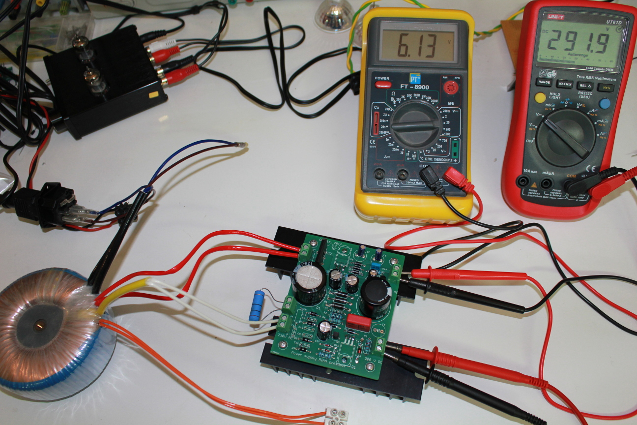

I have also made two different style of power supply for my RIAA preampli ( Merlin RIAA Preamp ), the first one is a simple version stabilized with three 100 V Zener diodes and the second one use a LT3080 in a Maida like regulator... I wanted to be able to use it also as a high voltage variable lab power supply (50 - 350 V). The un-populated part of the second PCB is just a 6.3 V 5 A regulated power supply for heaters, like in the first version (it is too much for the preampli, but the power supply can also be used with a power amplifier).
It is quite different than the ones you are testing since I wanted to have on the same PCB both the high voltage and the 6.3 V heater power supply and their rectifier with the 100 uF 400 V and the 10'000 uF 25 V capacitors, therefor it can be directly connected to my toroïdal transformer as you can see on the third photo (the heater should be 6.3 V, I have to replace a 470 ohms resistor by a 487 ohms, i didn't have them in stock when I have build the board)...
The connector indicated "SELF" can be used in the filter area of the power supply to connect a resistor (C-R-C) or a choke like in the last photo (C-L-C) or even a NTC to reduce power on surge current, but it can also be simply ignored and connected with a wire !
The first power supply is working very well and is currently powering my RIAA preampli :)
I have started the test with the second one, but I have the following problem : with the input voltage of 250 V AC (about 350 V DC) I can only adjust the output voltage from 47 V (this is OK for the fixed resistor) to 177 V :eek: I am using a fixed 47k resistor and a 470 pot that I can use only on one third of total course !
May be the circuit don't like the 10 inches connection to the pot ?
