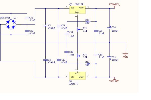

I am newbie to the power supplies . I am using the LM 3x7 series for the tda1541a DAC analog output stage. pls take a look
I wonder R11, C29, C24 suitable for the purpose of driving a simple transimpedance amplifier.

I would implement the LM3x7 series as recommended in the data sheet or i would do this:
http://www.diyaudio.com/forums/showthread.php?postid=1833337#post1833337
Very interesting circuit!In the data sheet for the LT1033 negative adjustable regulator there is a typical application schematic for a tracking regulator that i am interested in but don't understand. I like the simplicity of the design as all the tracking regulators i am familiar with use opamps.
here is the schematic from the data sheet
here is the more common implementation as well as the formula for calculating resistor values to set the output voltage.
my two questions are:
1. how do you adapt the formula to calculate resitor values for the tracking regulator?
2. how does the circuit match a voltage change at the output of one regulator in the other regulator?
I simulated it, and i think that it works like this:
Ir1 and Ir5 are always going to be 12mA, because of the 1.2v across that resistors. That's all the available current, and it's going down thru the resistor network.
R3 is connected to the top of R2 and the bottom of R5, so whatever r3 you use, Vr3 = Vr2+Vr4 = 2*Vr2 = 2*Vr4.
That means, that with r3=r2=r4, Ir3 is going to be 2*Ir2.
Ir1=Ir2+Ir3=Ir2+2*Ir2=Ir2*(1+2)=Ir2*3
So, in this case, Ir2 = Ir1/3, while in a standard circuit, all the current from R1 flows thru R2. This has the effect of dividing R2 by 3.
Then, by reducing R3 further, more current goes there, instead of thru R2 and R4, reducing the voltage drop there, and thus, the output voltage.
