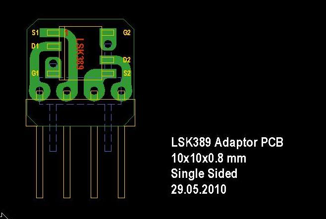

LSK389 Adaptor PCB
It took less time than I thought. ;)
Output pins are standard 2.54mm pitch angled header pins.
You need to cut off pin 3 & 7 at the LSK.

There are total of 192 ICs bought. So let's say we need 8x14=112 adaptors. That is one board 160x100mm.
The only sensible way to do something like this is either CNC routing (cost a fortune and need gerber files), or DIY.
If there is sufficient interest (>100), I shall DIY and let you have them in strips of 8 (or strips of 14).
That means you need to trip to size and drill holes yourselves.
I guess something like 1 Euro / adaptor including Paypal fees & postage worldwide (not registered).
Material cost is not much. My time costs more.
Of course someone else is welcome to take over if he is willing do it for less.
It is simple enough to copy.

I'm in 3 strips of 8 or 2 strips of 14. I will trip to size and drill holes.
