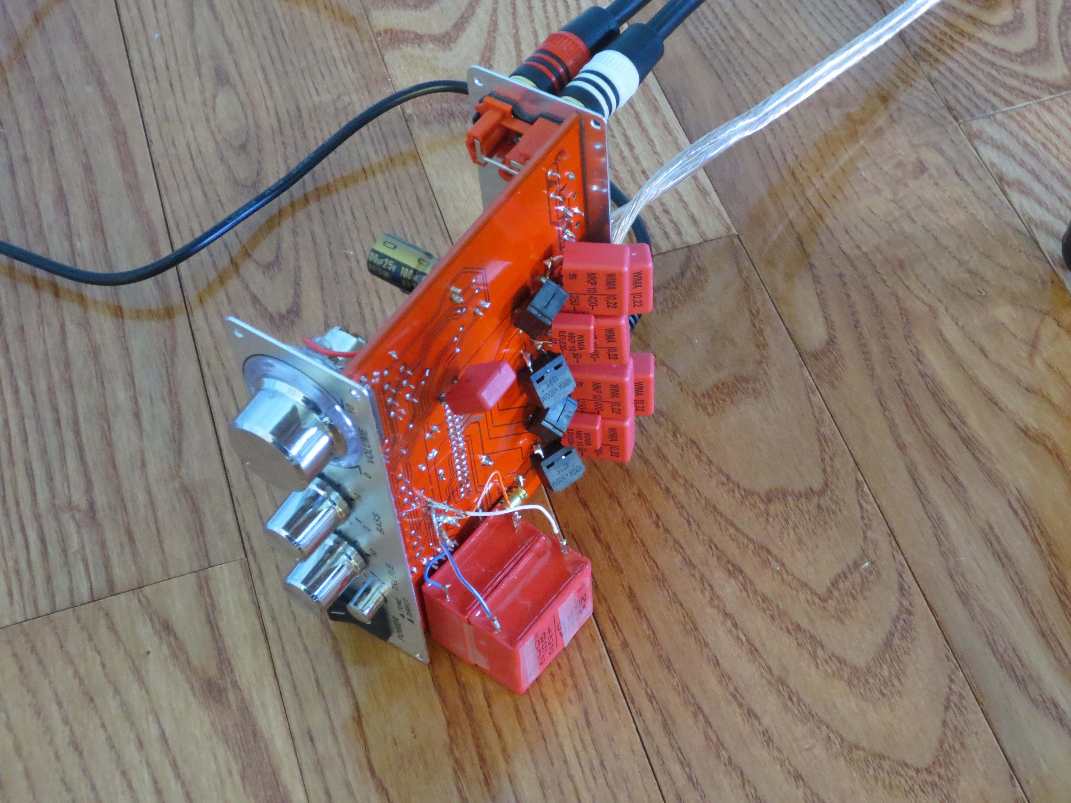

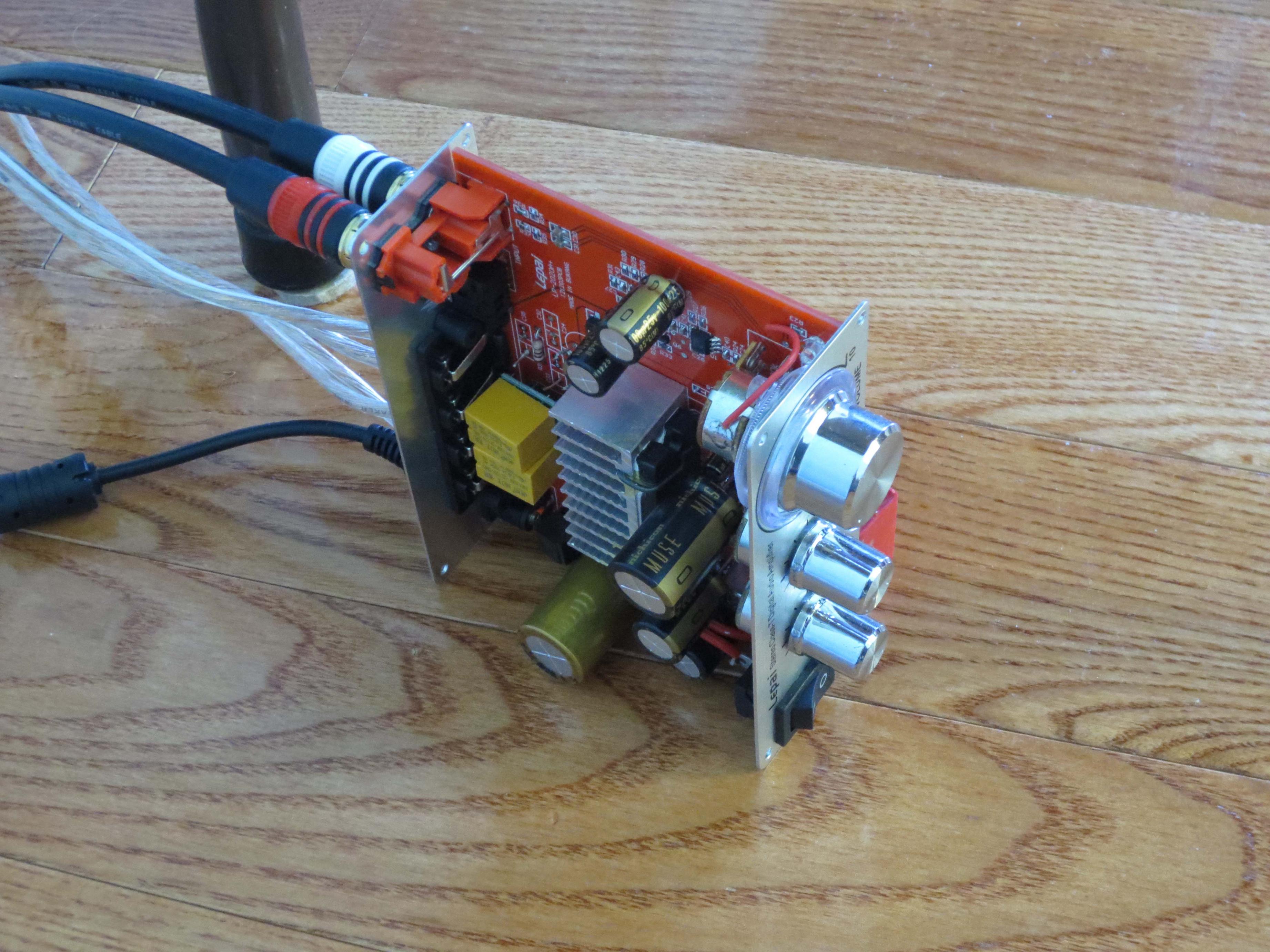

Here's pictures of my caps, "temporary placement"
Honestly I don't think I can fit everything in the case... :shhh:

Here's pictures of my caps, "temporary placement" Honestly I don't think I can fit everything in the case... :shhh:
TP - Consider finding a really nice cigar box, big enough that you could fit your modded board into. Cut a rectangular opening in the front of the box and just screw the amp's faceplate to it to mount.
