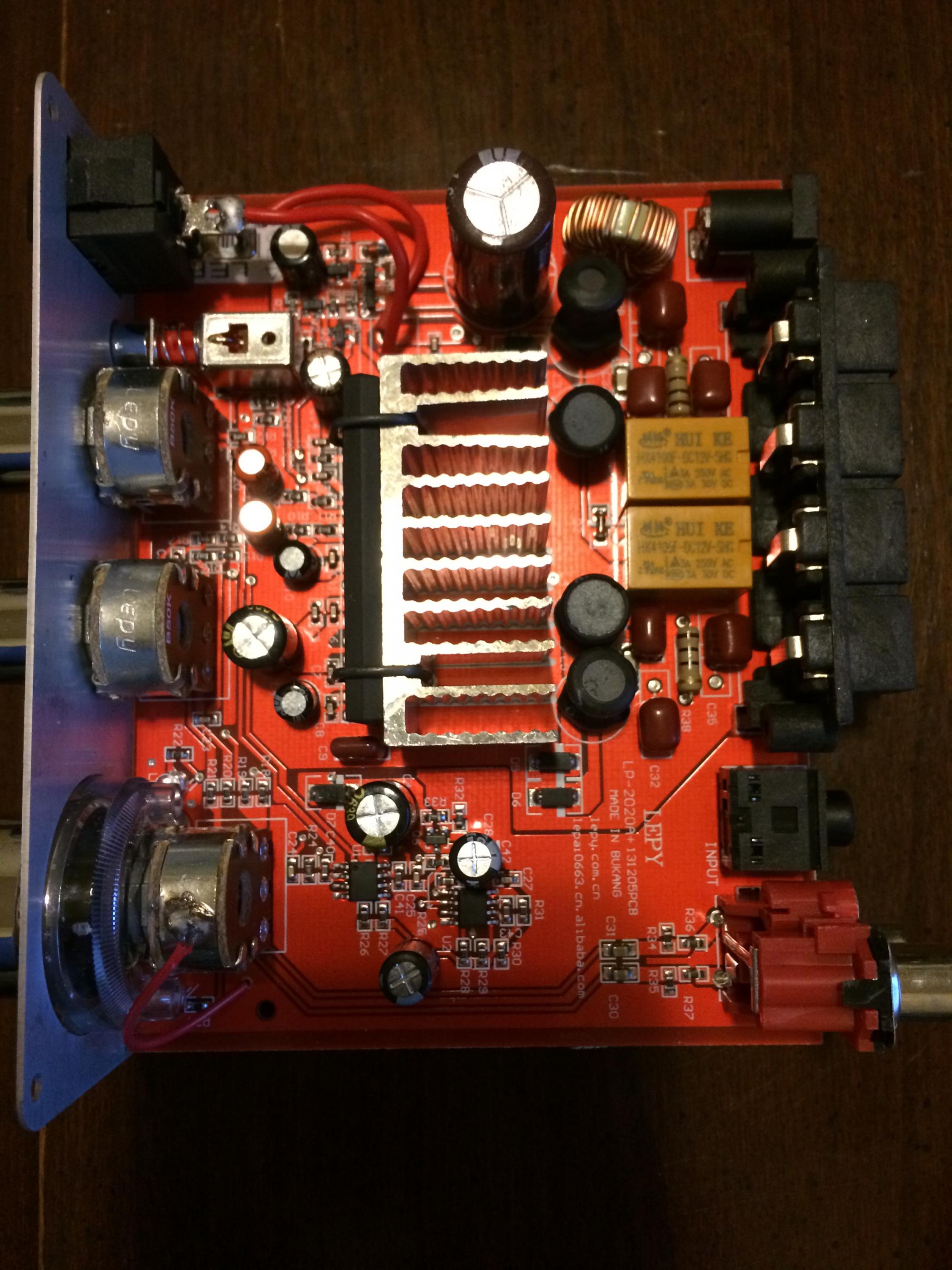

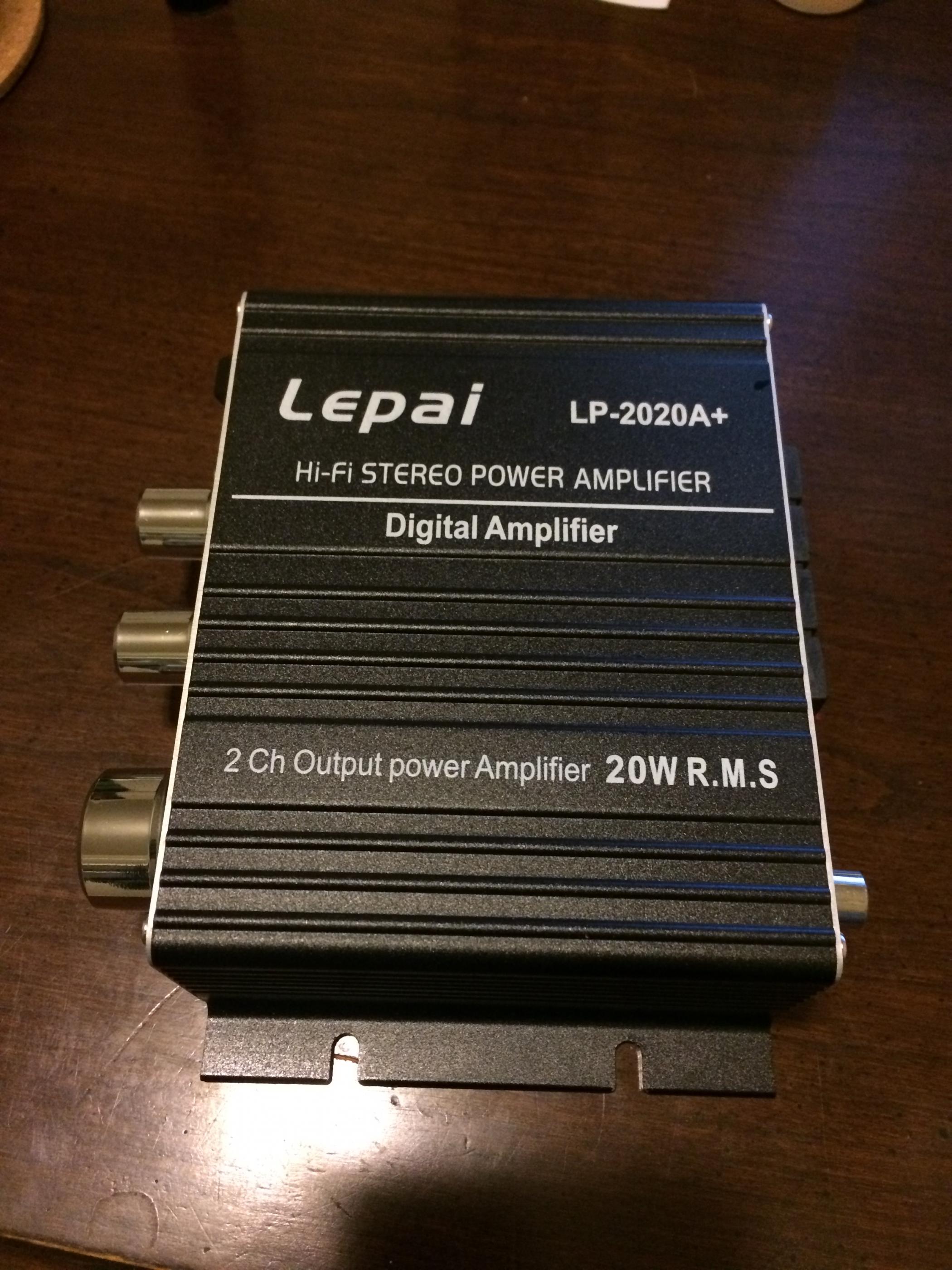

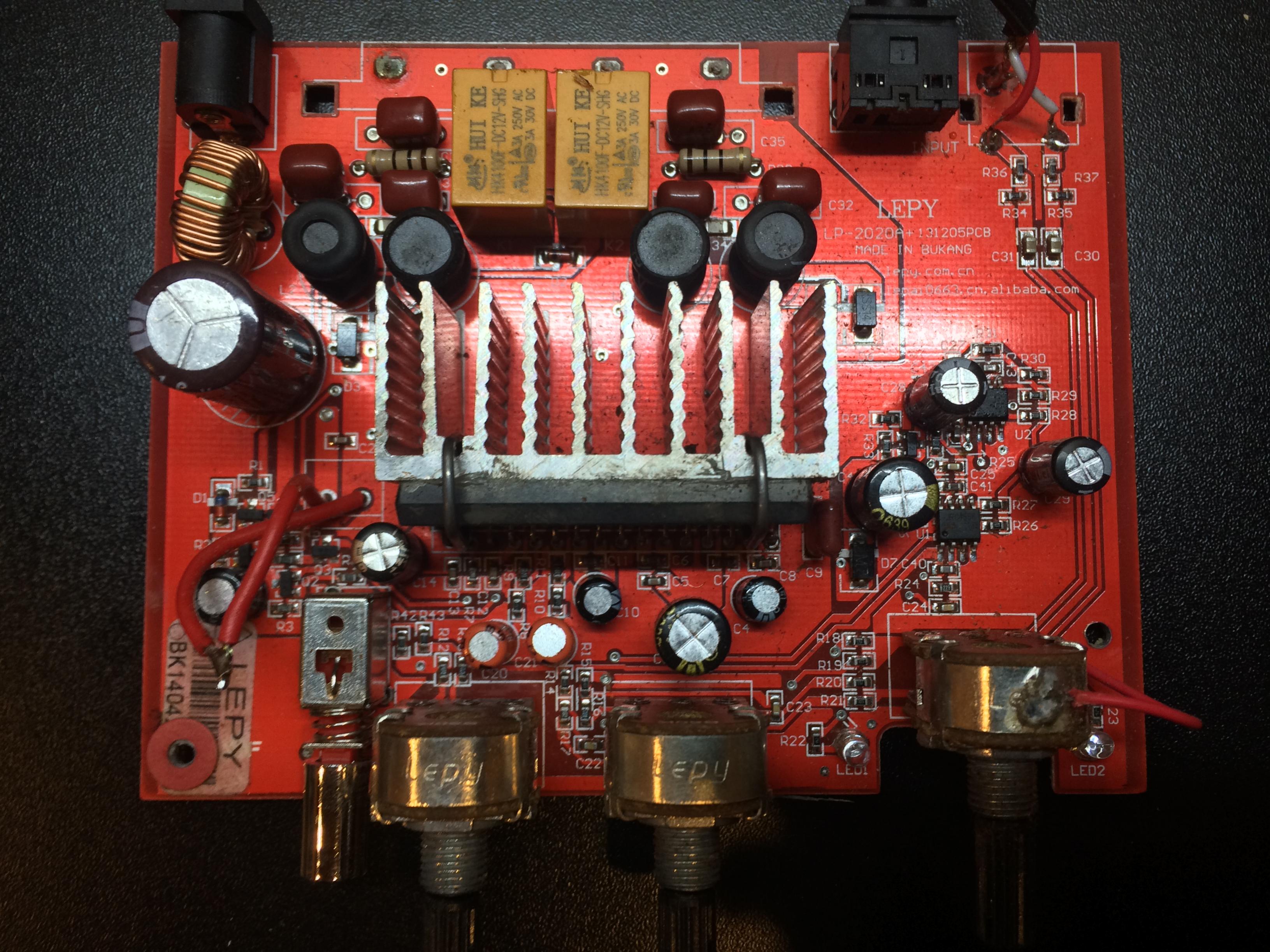

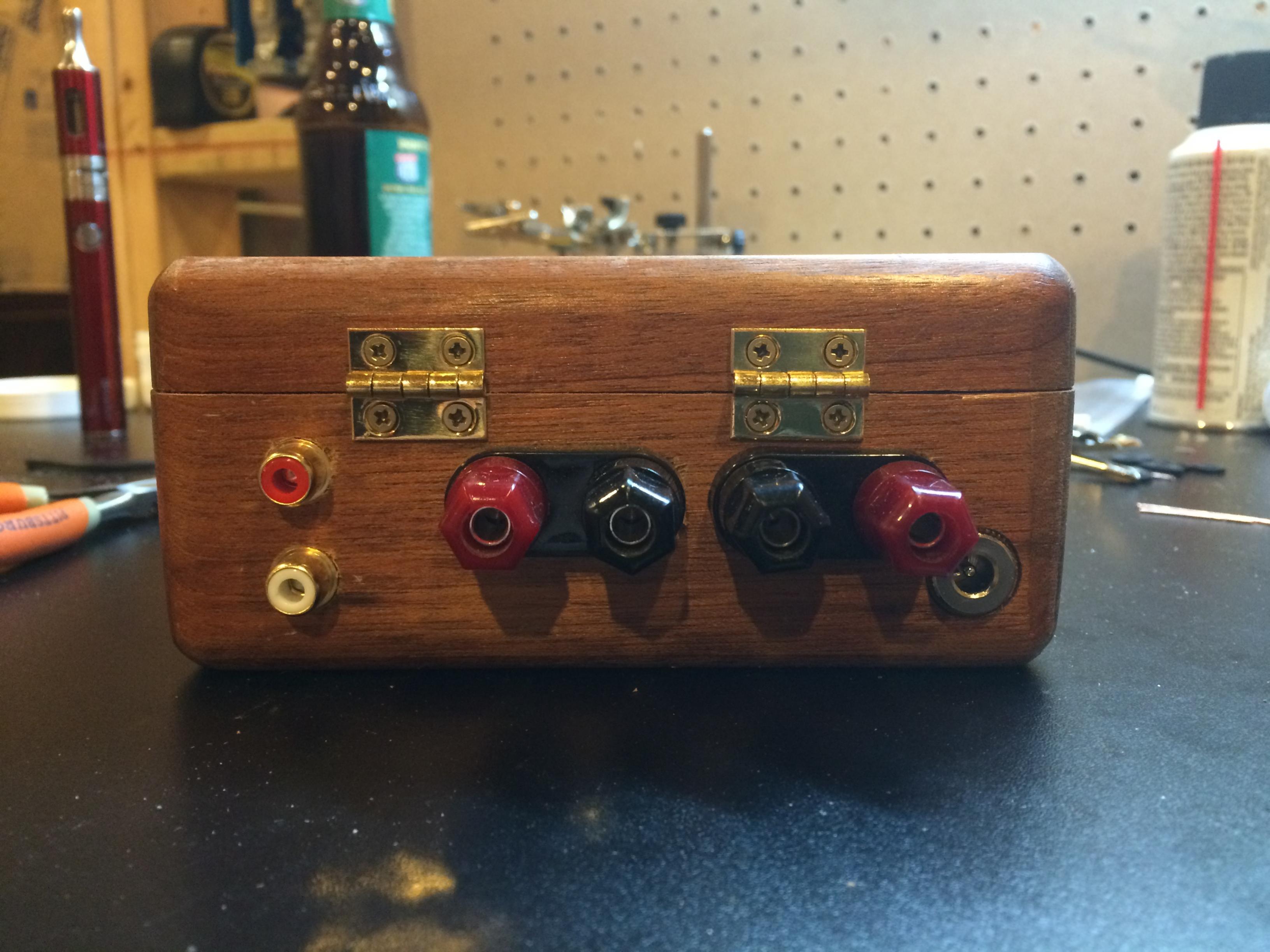

so i bought the 2020a+ and it sounded ok, Lots of background noise and anything above half volume started distorting.
researched mods that had been completed by a few people, created a parts list and off i went.
thanks to mouser, i was able to get everything i needed....

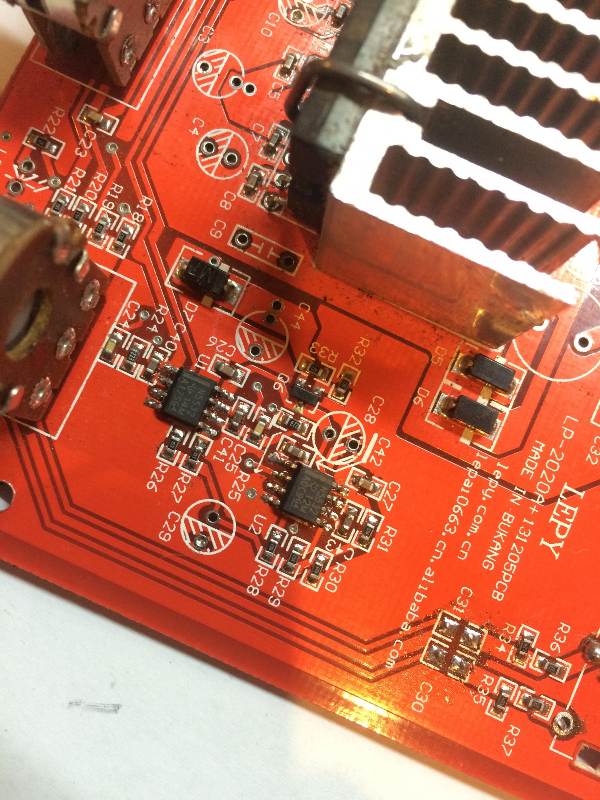

op amps NE5532D

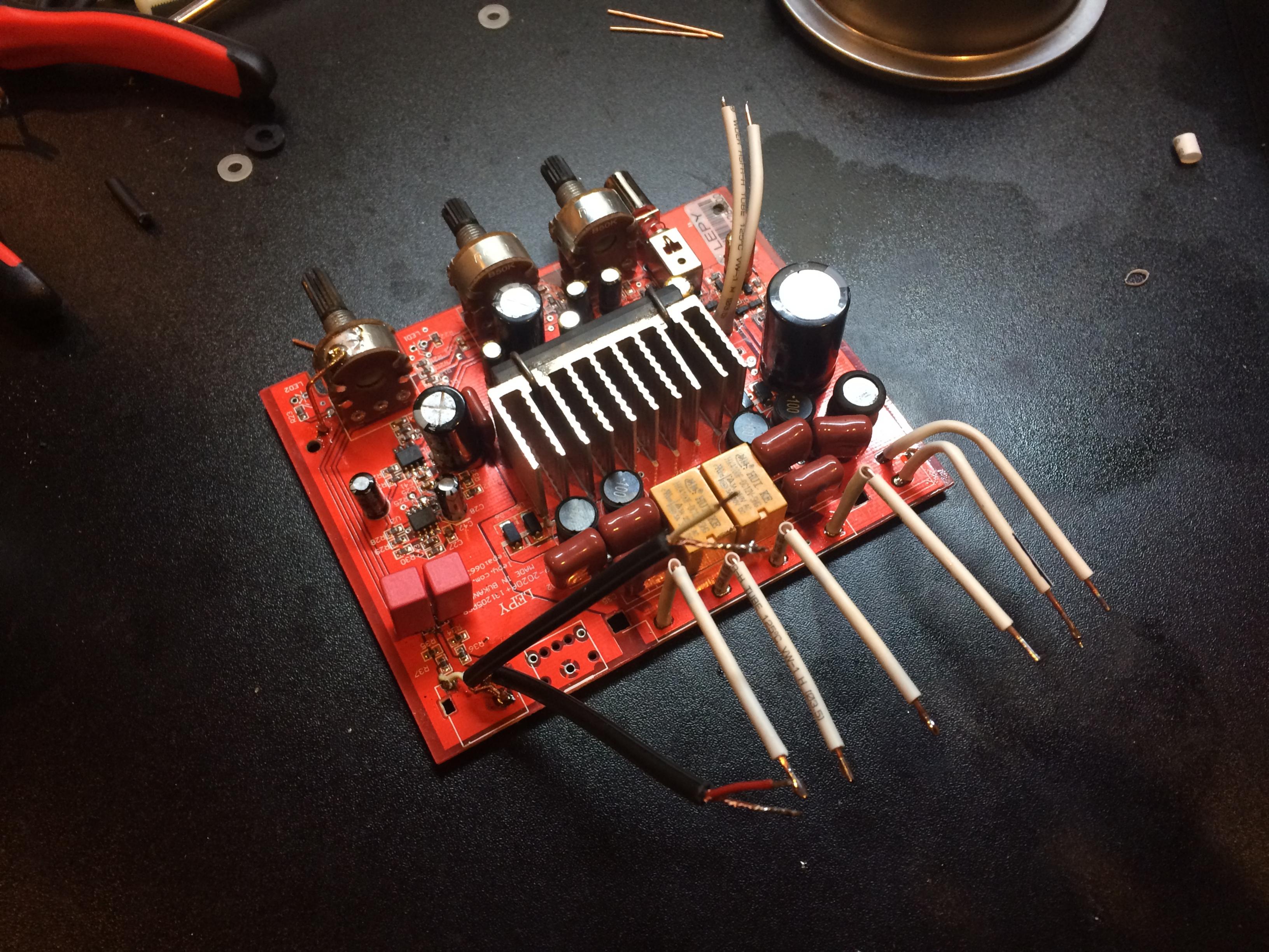

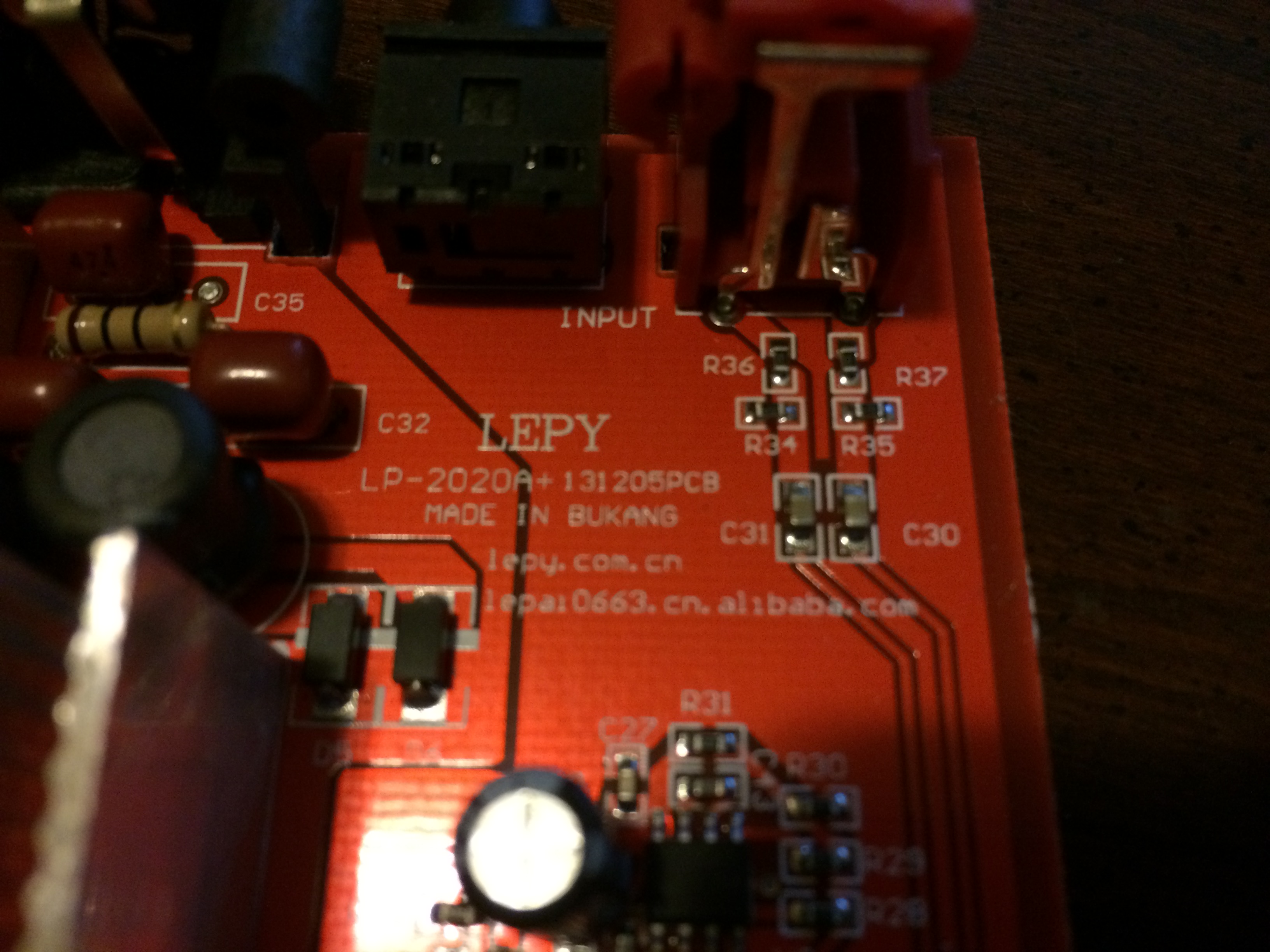

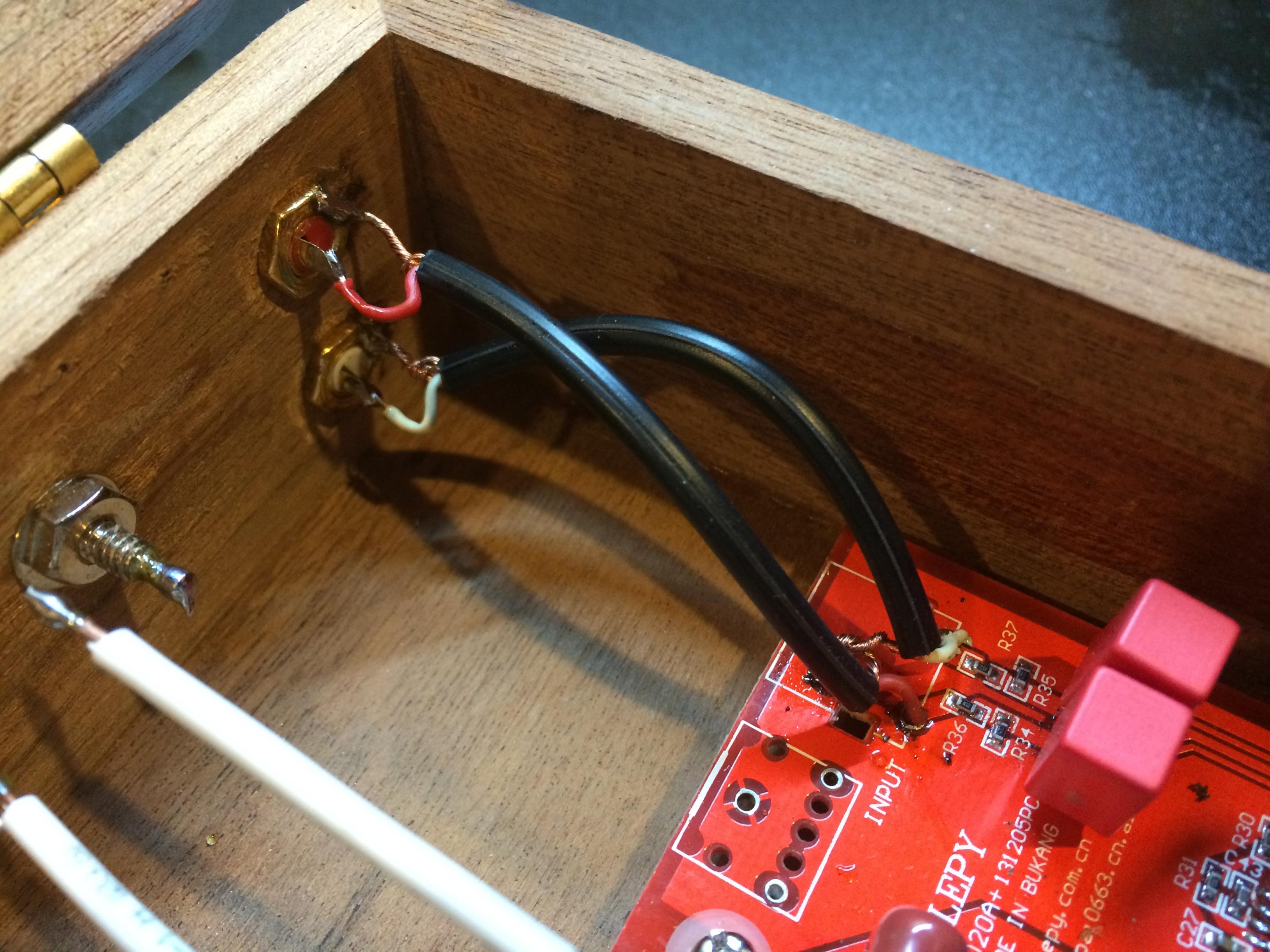

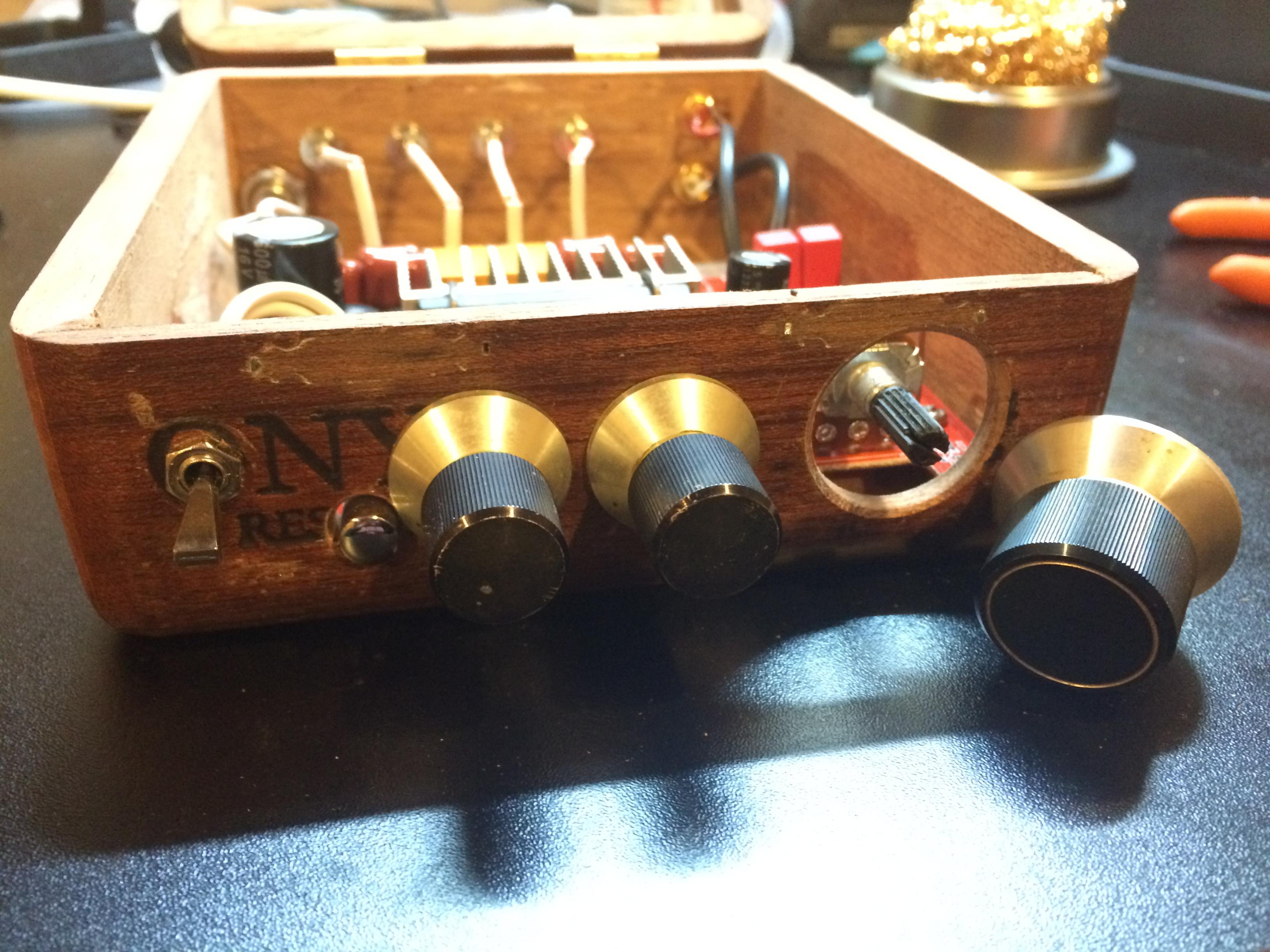

assembly really wasnt hard at all!
even the surface mounted op amps didnt give me trouble despite all the info on the interwebs scaring me about having to use solder paste and junk...
i used a super fine tipped solder iron and alittle flux, those things dropped right in

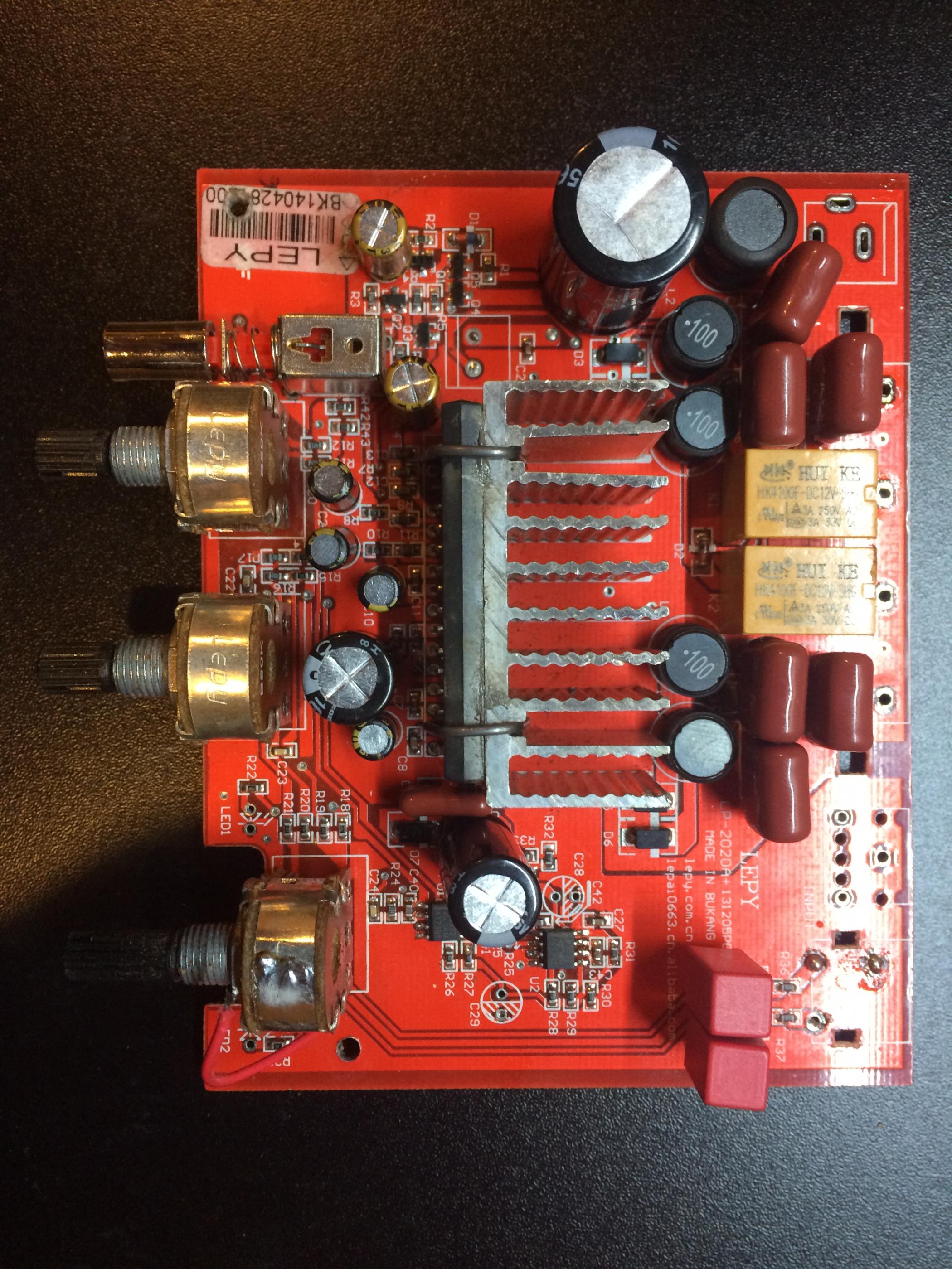

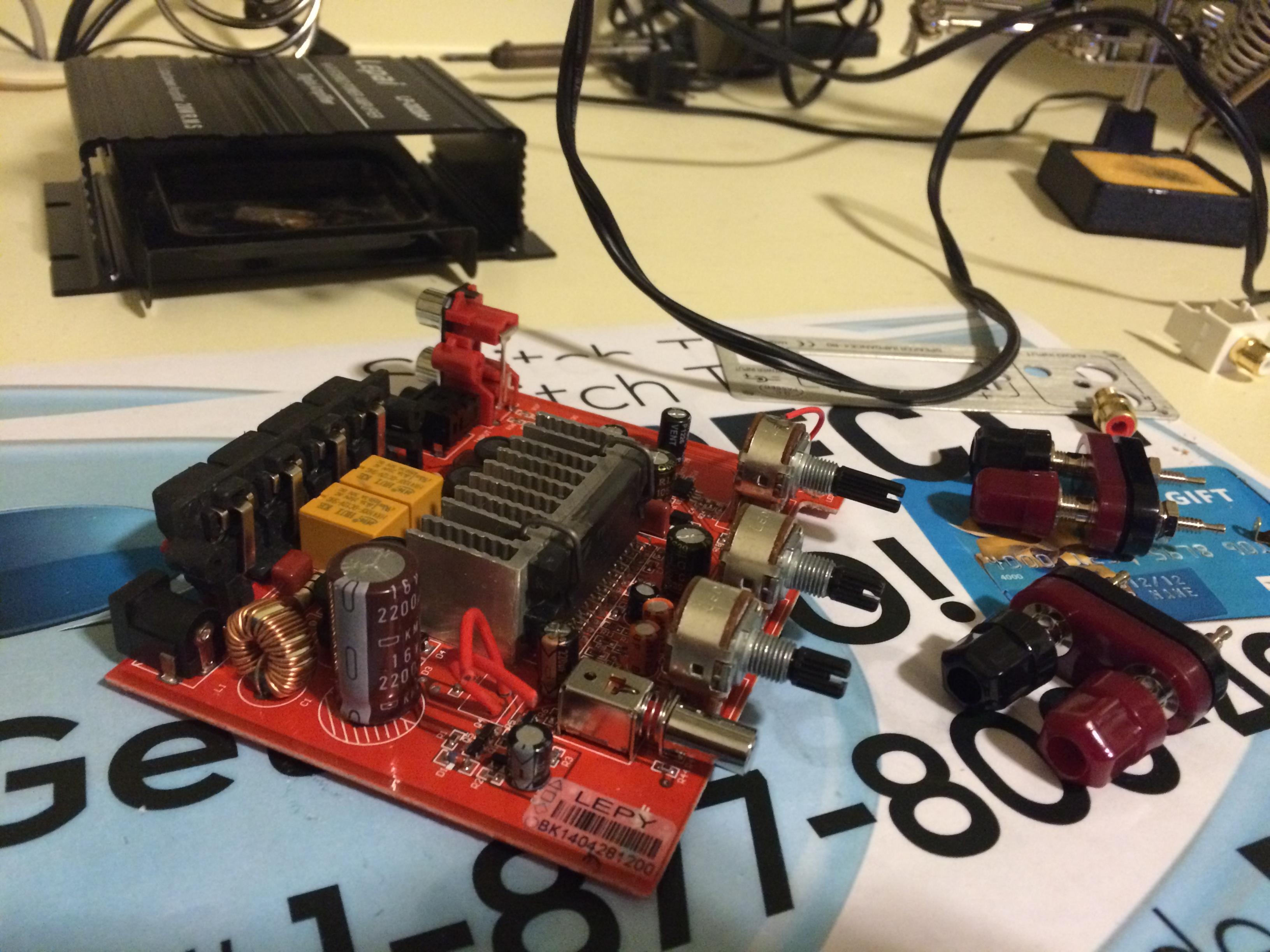

one thing i forgot to mention, i had separated the tripath chip from the heat sink and thoroughly cleaned then applied Artic Silver 5 (even though this probably didnt make ANY difference) the chip runs pretty cool even before modifying the entire board.
one thing i would like to mention is that after switching the components (and this may have to do directly with the op amps) the bottom end is now super strong and the overall clarity is a complete 180 from stock sound

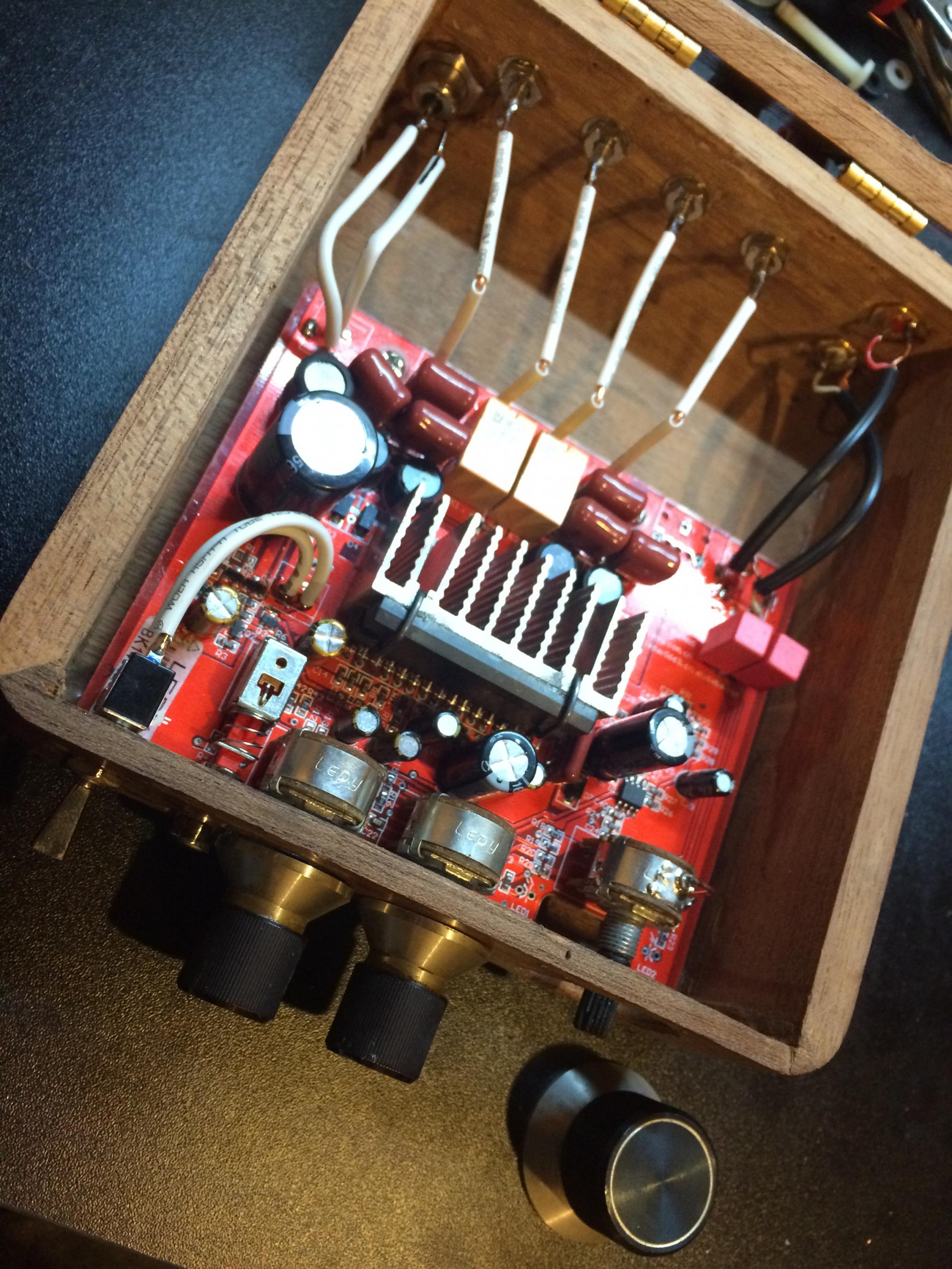

I'm still amazed, that my modified amp is still working without problems for 2.5 Years now, 12+hours daily usage. (Same goes to the 10$ Chinese psu).
From when i first started reading about it, then buying and modding it, i would have never thought it is going to make it so far.

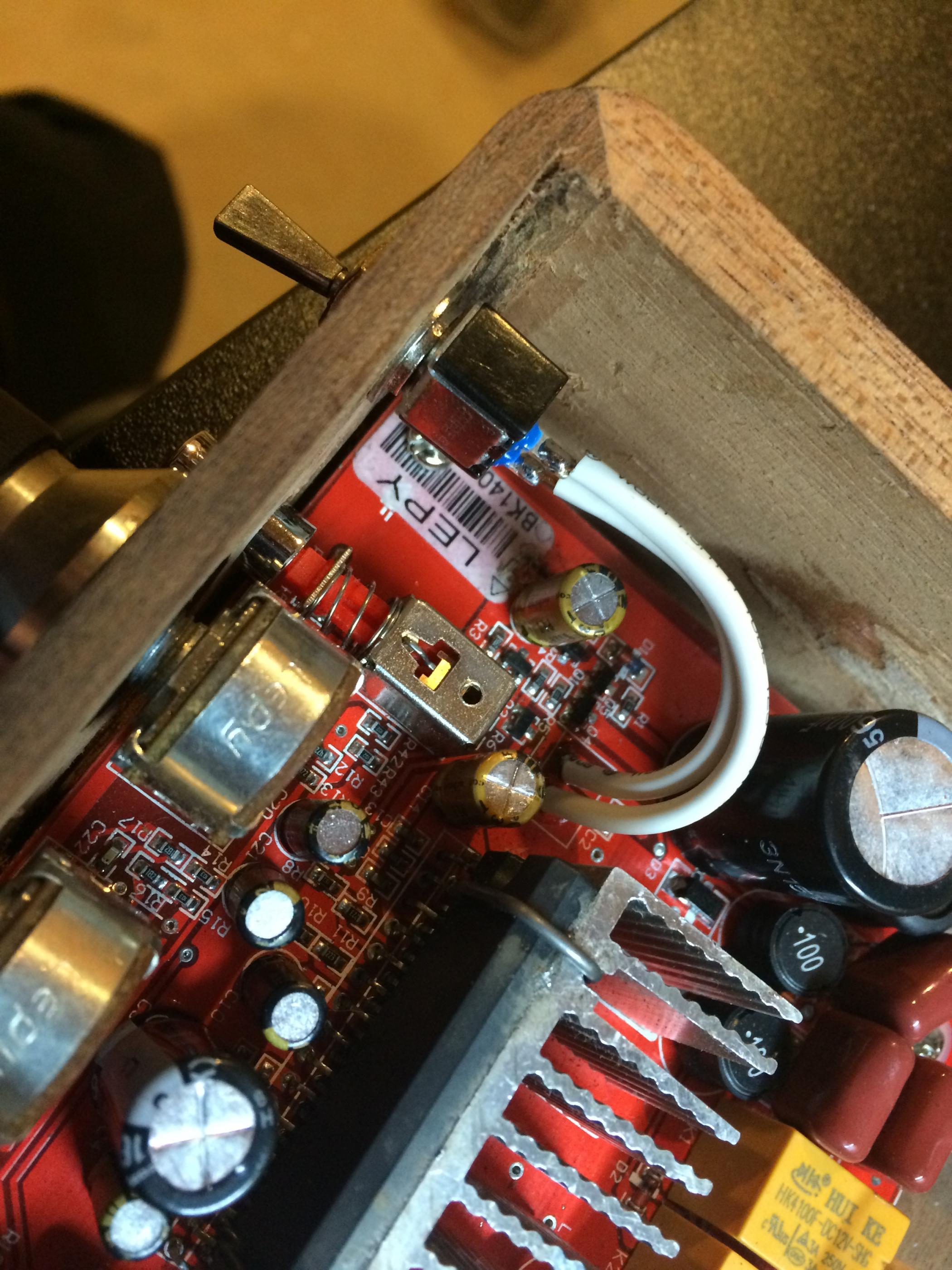

I picked it up after seeing all the neat mods and stuff peopl have done with it. Also it was a learning experience that I could use on other projects.

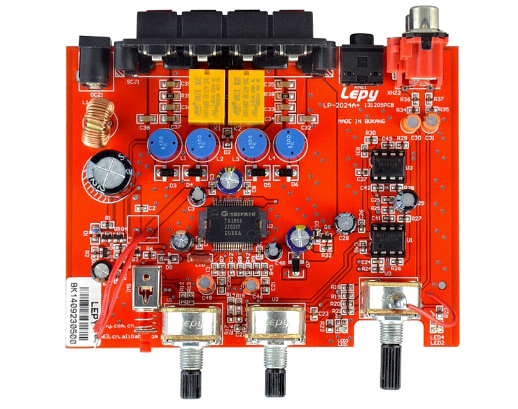

It seems the lepi or "lepy" company that makes these has been reading the forums and mods because they actually applied some of the mods to the design and put them into the next model!
Take a look at this new version with upgraded components...

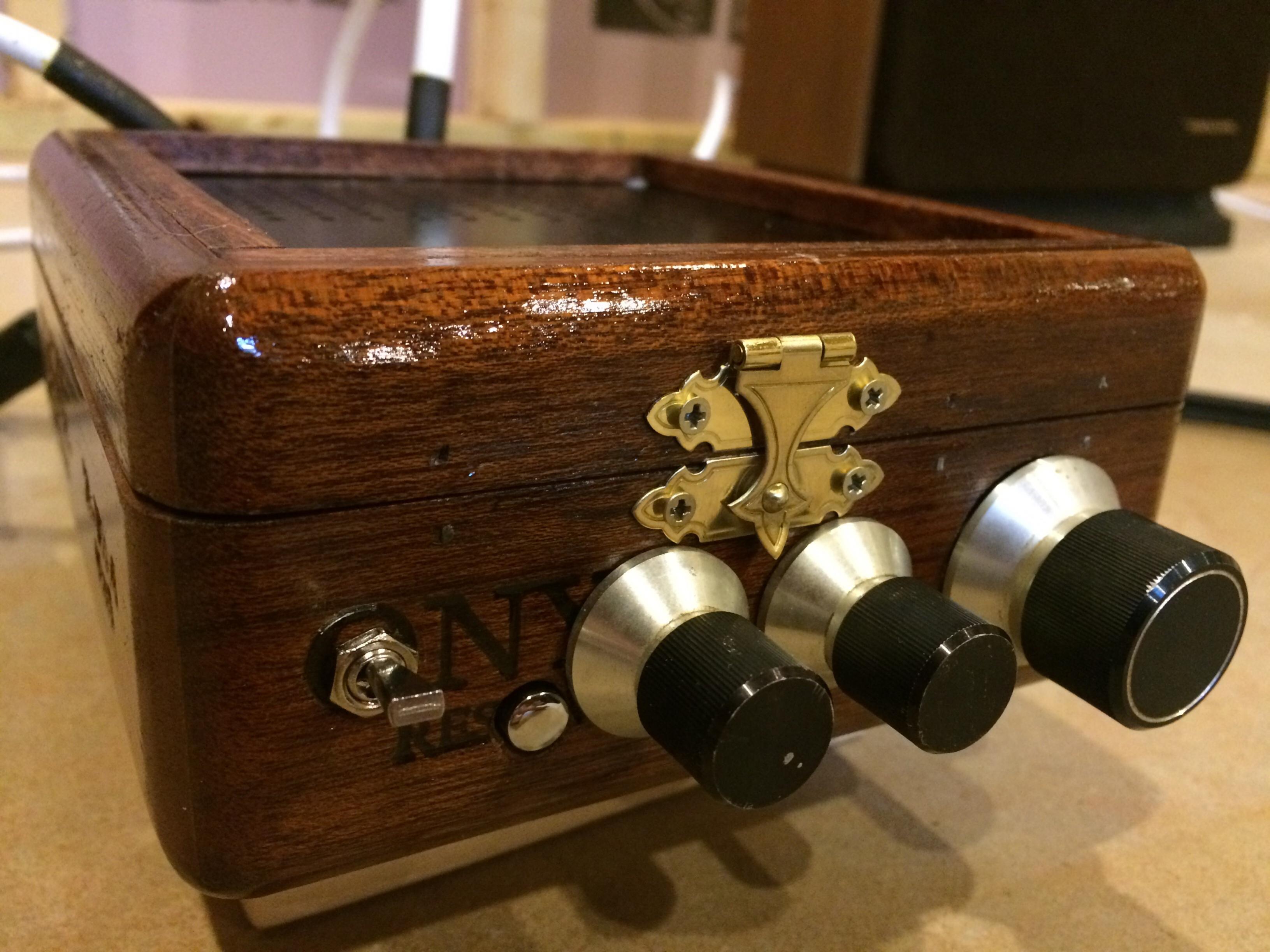

Waffle,
those mods are a work of love, very nicely done. Beautiful, looks like you enjoyed the re build.
That photo is of a 2024A+, I wonder if the 2020A+ has the same upgrades? I should get mine today, anxiously awaiting with screwdriver......
No heatsink? or is it under the chip?
The 2024 has a different tripath chip that is physically smaller. Apparently it doesn't produce as much heat as the 2020 so it doesn't have any mechanical heat dissipation.
It was definitely a fun build, I don't know why people complained about changing the opamps because it wasn't hard at all. I use a pencil tip solder iron and tinned the pads for the replacement op. To remove it, I have a soldering heat gun specifically for smd parts.
I do have an unfortunate update though, I had this thing running for a very long time at high volumes and now the amp goes into protection mode flipping the relays anytime over 1/4 volume.
