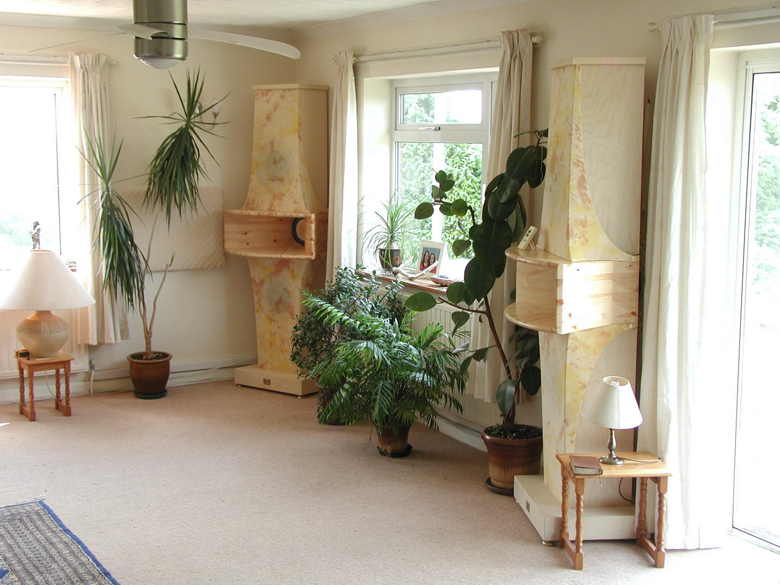

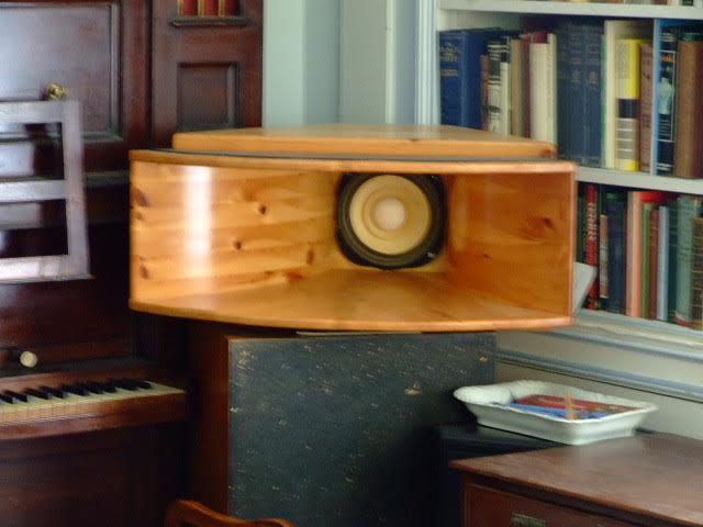

But I have a pair of wooden front horns which are just 150Hz horns made by John Richardson
attachment.php
and these work best with the doorknobs.

Attached is a photo of the Richardson production horns in his living room
