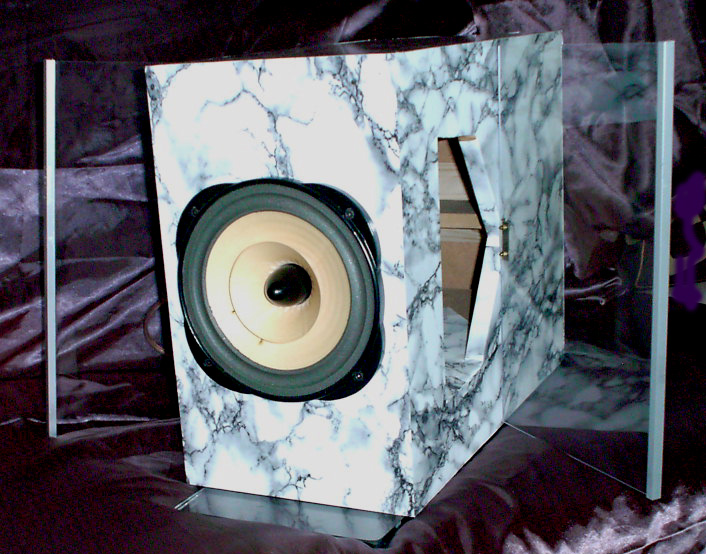

I built some 208 Sigma cabs for my Fostex 206E's. I picked up some PM6c's and tried them in the 208 sigma cab. They sounded ok, but the bass was lacking and they didn't really work. I would think the same could be said for the 206 Solo cabinet.
I did some research to see what I would need to build to get the Lowther's to soound as good as the Fostex. I reckon the Big Fun Horn, would do it.

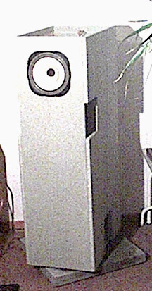

Hello,
i have made good experience in different
horn constructions:
Trumpet Sat and the others,
and in the Saxophon, also working in
the other double horns.

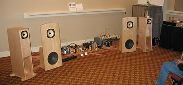

Lowther America has some plans that you might be interested in for the PM6C including their open-baffle at Open Baffles Lowthers. This is a very simple design to build.
I listened to Jon's OB speakers at VSAC a few years back and thought it was one of the very best sounding speakers there. I believe he used the Tone Tubbies crossed over at around 200 hZ (IIRC) for the bass duties. Very, very nice!
