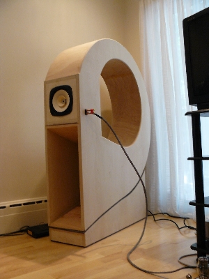

Something like this ...
This is my first attempt using Fostex FE207E drivers. They sound very good, even compared to what I usually ear at audio shows. Definitely not the best ... but I am working to improve it. No special tweaking of the drivers, nothing fancy in the compression chamber except Deflex on the back wall.
I am not too happy with the craftsmanship. I made a lot of mistakes and the 2 horns are not 100% symmetric (maybe 95%).
It was a great learning experience and a required step before playing with delicate Lowther drivers.
I have used examples on the Dominique Petoin site to design the horns to match with the Fostex FE207E driver.

Amen. Those don't match the average specs I have, and given that they're hand-built, sample variability on Lowthers is quite high.
BTW -technically, that's still a folded horn. Unfolded really means no folds, turns or bends, i.e. straight. Not that the results are likely to be significantly different in practice, looking at it. And BLHs don't really have compression chambers, other than the room it happens to be situated in. OK, yes, I'm nit picking... We know what you mean.
Thanks, MJK ands Scottmoose, for your input. So the 1st step is to really buy the drivers ? How much do they drift from specs and how well matched are they when shipped from the factory ?
I hate the fact that I will have the drivers on a shelf until the cabinets are ready. Last time, it took 8 months to build them
Which one of the parameters will cause the the design not to work properly ?
Normally, I take these values to design the profile of the horn.
Fs, VAS, Qes, Qts, Re, BL and Sd.

lowtherdream said:So the 1st step is to really buy the drivers ? How much do they drift from specs and how well matched are they when shipped from the factory ?
Hi lowtherdream, have you seen this info?
http://www.quarter-wave.com/Project04/Project04.html
If you go to the General Speaker Related Articles link on my site you will find the measured T/S parameters for my collection of Lowther drivers. If you assume that the A and DX series use the same frame and cone assembly, then you can get some idea of the potential variability in fs, Mms, Vas, Re, and the Q's values.
A good set of T/S parameters is key to designing an enclosure, using computer simulations, that produces an optimum low frequency response. For me, accurately predicting the response during the design phase and then correlating against the measured results is half the fun. But that is just me. There are a lot of ways to design a system with or without the T/S parameters. Lowther drivers are really special in my opinion and they definitely seem to produce a love 'em or hate 'em reaction among users.
Why have you focused on the PM5A driver? What are your expectations/requirements for low frequency performance? How big and complicated are you considering for an enclosure design? There are a lot of options for a Lowther design ranging from simple OB to slightly more complicated ML TL to very complicated BLH enclosures.

The measured T/S do vary according to your measures. Does it mean I have to build a different cabinet for each driver ? Are the drivers properly matched in the Lowther factory ?
I was planning to go BLH similar to the ones I created for the Fostex FE207E.
The PM5 has great specs and is a very efficient driver. Drivers in the A series is said to be Lowther's most natural sounding drivers.
The PM4A is much bigger and I know that the magnet size will become a problem in certain designs. Since I will probably only buy 1 set of Lowther drivers in my life, I was aiming for what I think is the best unit. Of course, I only had the chance to listen to DX4 drivers, and I doubt I will be able to ever compare the drivers side-by-side in a real live test.
I guess my best option will be to build a decent cabinet using the manufacturer specs, buy the drivers and install them. Once installed, I will be able to burn them in and measure the real specs. With these new numbers, I will be able to design and build a better cabinet, and hopefully be happy with the results
Is there a better approach without spending too much money ?

Typically I don't need more than 25 watts for the low end, and I usually
use about 5 watts for the top end.
Two drivers, FR and woofer.
Filtering, simple 12 dB/oct and a simple notch - anyone can do it.
Small footprint.... You got me there, but the BLH's that I like tend to
be on the large side.
Anyways, I like the lack of internal box reflections and the way a dipole
"illuminates" the room.
