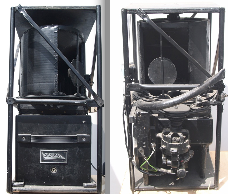

Got a 4x4" Leslie for sale if you want some more movement!
The 4x4" work better than the compression driver on a 3 foot horn did, saved a lot of space.
Just mount the cone driver in a sealed box (or pipe) with a wad of insulation in it, and attach your experiment to the front of it. I don't think a compression driver is gaining you anything here. edit: whoops, Art beat me to it. If you can avoid a shrinking cross section, you'll probably like the results better, so maybe have your "branching" start at the same place on the large tube, rather than tapering to a small one. I suppose if you had a series of branches coming off the large tube, each one would be a high pass filter...
weltersys - Quite a piece of hardware there; very interesting!
