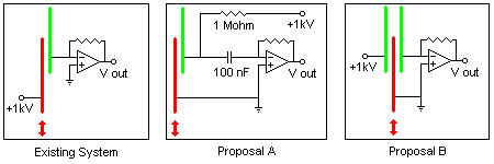

Here's a nice motional feedback idea based on measuring the capacitance between concentric cylinders:
Capacitive motional feedback for loudspeakers
And here's a couple of ideas that could help performance and ease of construction:
(The text below is copy-pasted from an old email - hence any weird formatting etc)
_______________________________________________
The illustration below shows the existing system as well as a couple of proposals. In each case the output voltage (V out) is proportional to the velocity of the moving (red) plate. Static plates are shown in green.
In both of the proposed schemes, the moving plate is earthed, rather than connected to a high voltage source. This can be done by simply connecting the moving plate to one end of the voice-coil (preferably the earthed end). There is then no need for extra "flying" wires, drilling holes in the voice-coil former or attaching additional wires to the spider.
Proposal A
* With the values shown, response will roll off below about 1.6 Hz, which could be ignored or compensated elsewhere in the circuit.
* Depending on the driver, it may be possible to use the voice-coil former itself as the moving element. This is likely to be better behaved mechanically than a glued-on cylinder due to it's rigidity, good balance, and direct coupling to the voice-coil.
* Possible disadvantages could be pickup of hum and noise from ambient fields as well as the effects of nearby earthed objects, which may affect the electrostatic field and cause distortion.
* A couple of diodes from the op-amp input to earth would probably be a good idea to protect against high-voltage surges at switch-on / switch off.
Problems with distortion
A problem with the original design as well as with Proposal A above is sensitivity to sideways movement of the red plate. This effect is reduced with cylindrical capacitors, as a sideways movement will increase capacitance on one side, while reducing capacitance on the other side. However these effects do not cancel out - a movement to either side will result in an overall increase in capacitance. Thus any sideways vibration at the frequency being played will produce 2'nd harmonic distortion at the output.
Proposal B
* This avoids the problems mentioned above because the capacitance between the moving plate and either / both of the static plates is irrelevant.
* What is being measured is the capacitance between the two static plates in the region above the moving plate.
* The moving plate acts only as a shield.
* With solid, accurately aligned, well damped static plates, I would expect this system to give good linearity and be immune to the effects of spurious sideways vibration or resonance of the moving plate.
* It would also be easy to implement decent shielding around the static plates to prevent pick-up of hum etc.
