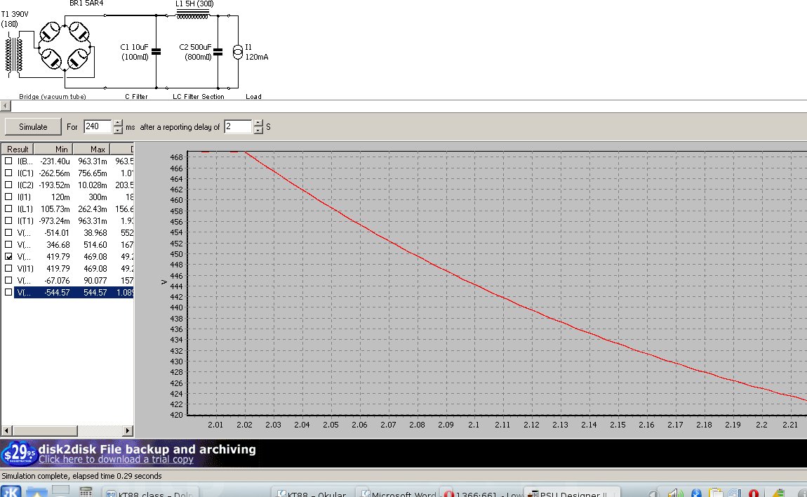

Here's a screen grab from PSUD. I don't know the inductor resistance, so just a guess there. I put in 370V at a rated 150mA for the transformer (it would be double that for your actual transformer, because you are running two channels.) I set it up as a full wave rectifier, to reflect the impedence of the rectifier. It will be slightly different for a bridge, but it will get you close. Voltage is taken at the first Current tap.
Thanks Sheldon, you where right and your PSUD simulations where spot on, se my latest post.
