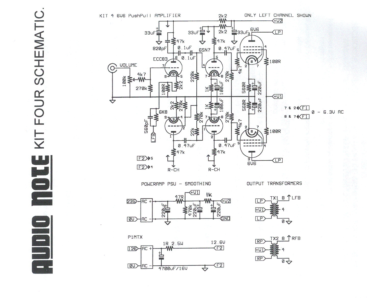

Well, if I misinterpreted your terms "weird," "strange," and "unusual," to mean "weird, strange, and unusual," you have my apologies. Perhaps there's a difference in American usage of these terms.
I think there is very little difference but again you miss the point. I was not saying the availability of those values was weird etc (and you were at pains to point out repeatably that those values are available) but I was saying that the choice of values was weird etc.
I am sure that even in America there is a difference between choice and availability.

Sorry to stay OT, but in the UK we have a reliable supplier (Rapid Electronics) who stocks Vishay E96 1% resistors, but only the E6 values from the range. Like many people from my generation, I tend to think in terms of E12 for most values, with E24 for precision things like RIAA. I emailed them to ask if they could expand their range, either adding the nearest E96 to each E12 value, or stocking the E24 5% range too. They replied, asking me to list the values which I would like them to stock. At that point I gave up.
As a result of my E12 brain, many modern circuits appear to have strange resistor values which may be difficult to obtain in the UK from the usual hobbyist suppliers. I even thought for a while that the designers were being clever, and implying a greater degree of design precision than is warranted for most circuitry - too many sig figs is a common newbie problem. End of OT comment!
Ah, I think you hit the nail on the head. It's an old UK head set versus a new USA head set thing. I am 60 years old and like you I rarely find a need to go outside the E12 series let alone the E24. These youngsters in the States seem to have been brought up on E96 and use it without a thought whereas to us old E12 brains all the values appear wierd, odd whatever.
