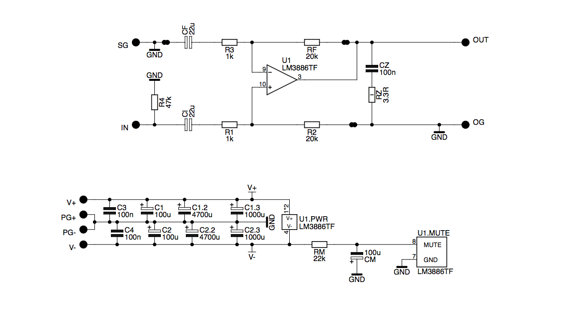

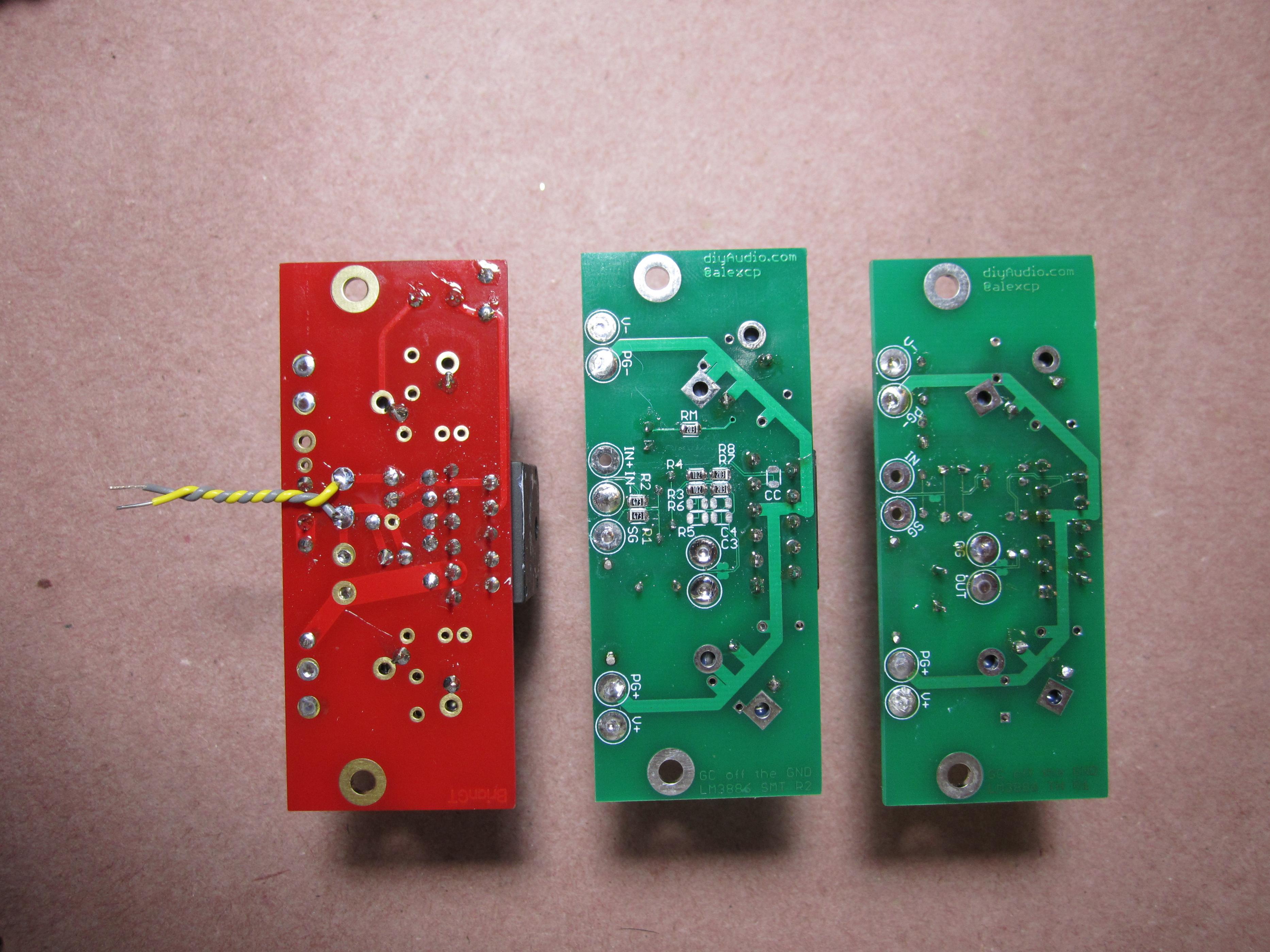

Have you, by any chance, analyzed how supply decoupling specifically affects the performance of LM3886?
I have not analyzed it in detail, but I have noticed that the LM3886 tends to oscillate at output swings exceeding 30-32 Vp if you use less than the 10 uF of local bypass cap recommended in the data sheet. I have not found the exact limit, but a 10 uF X7R 50 V rated capacitor does not have enough capacitance at 35 V supply (due to its voltage coefficient) to ensure stable operation of the LM3886 with higher than ±28 V rails.
Your page on the topic starts with the assertion that if the supply to the LM3886 is bouncing, the LM3886 may behave in unintended ways, but you never give any design parameters.
I'm sure you can work backwards from the PSRR curves in the data sheet. Note that the PSRR is different for the two supplies. VEE has worse PSRR as the VAS is referenced to VEE.
You do mention, however, that no power supply non-idealities are included in the LM3886 model, and that the data sheet is ambiguous on the exact requirements for bypassing.
If I recall correctly, the data sheet is not ambiguous about the 470 uF minimum bulk cap on the board and the 100 nF local decoupling. There is also no ambiguity in the data sheet around the fact that a smaller electrolytic or tantalum cap is needed by the LM3886. The ambiguity arises around the exact value of that local smaller electrolytic/tantalum cap.
You can find the info in the application section in the data sheet.
although the version with one cap per rail works remarkably well.
Have you honestly tested it? I.e. run it at various supply voltages with both 4 Ω and 8 Ω load and watched the clipping behaviour on an oscilloscope?
In your view, how much decoupling is enough, and what specifically are the ill effects of various kinds of insufficient decoupling?
You'll need minimum 470 uF on each rail where the power enters the board. In addition, you need minimum 10 uF in parallel with 100 nF on each rail, located as close as possible to the LM3886. I normally use 1000 uF + 22 uF electrolytic + 1.0 uF X7R ceramic.

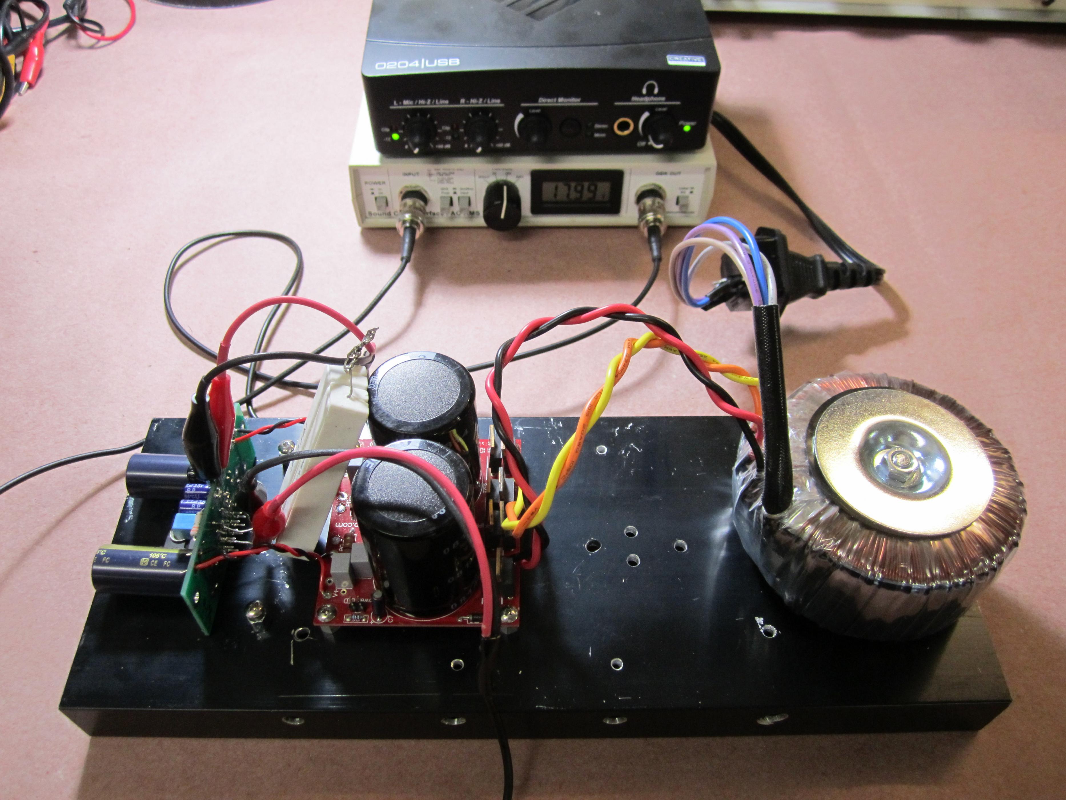

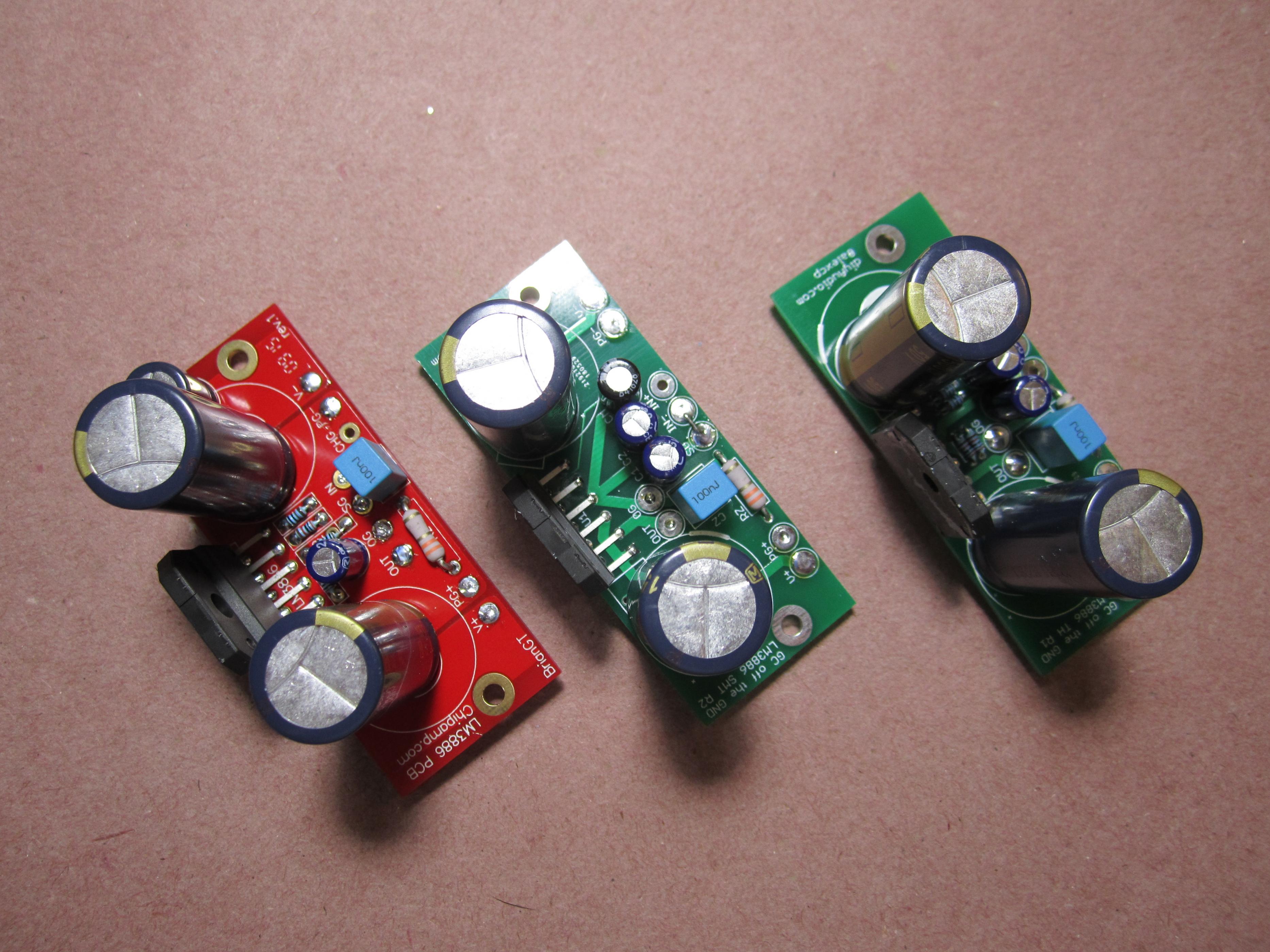

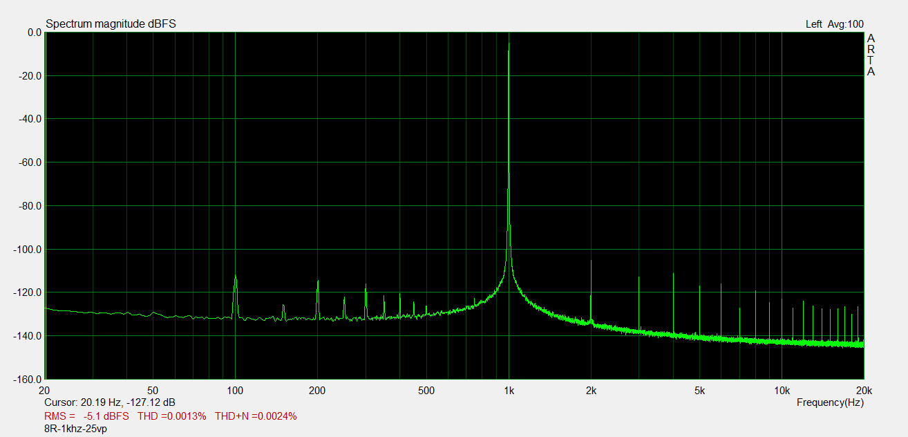

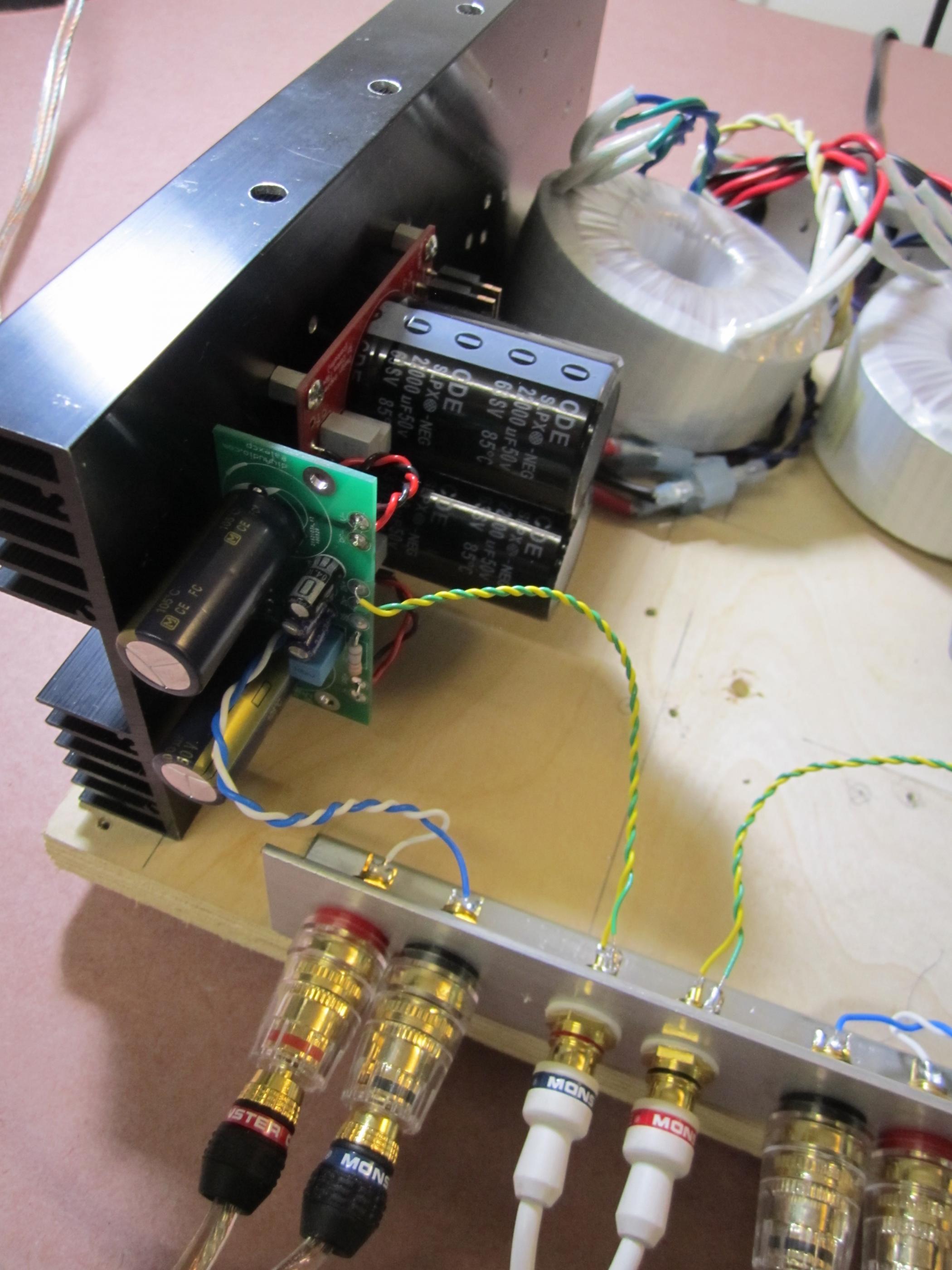

I did test my boards for clean clipping into 8ohm with an unregulated power supply giving about 31V rails at clipping, and they clipped fine with one 1500uF Panasonic FC per rail.

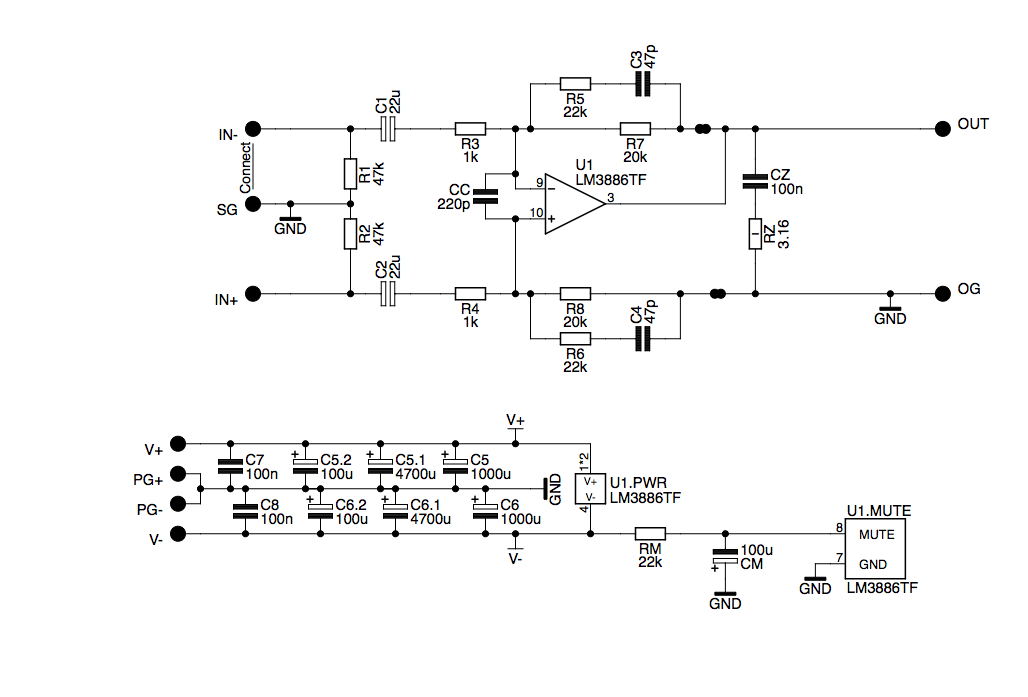

May I ask you to touch another topic: the design process for the frequency compensation network for a composite amplifier like the Modulus? There are advocates for high loop gain amplifiers with high(er) order feedback networks here on the forum, and implementations besides the Modulus (two examples I've built in the past are the MyRef and the ZD-50), but I have not seen any reasonably detailed discussion of how to actually design one. Your products clearly show you know how to do it - may I ask you to shed some light?
In the Modulus-86, I use a combination of a few 1st order compensations (dominant pole, feedback lead/lag). It's nothing fancy, really. Just complicated.

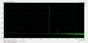

So far, I read the TI app note recommended by KSTR in post #46 above. I found it very compact and accessible.

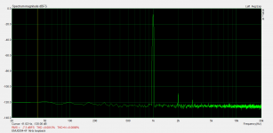

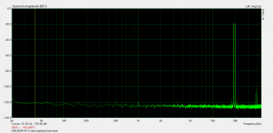

As an exercise, I designed, simulated, and built a composite amp with a gain of 21 with two halves of an TL082 - see attachments. As predicted, it oscillated without compensation, and properly compensated, it demonstrated very different distortion behavior compared to a single half of the TL082. The measurements below were taken at approx 8Vrms output level, just below clipping.
