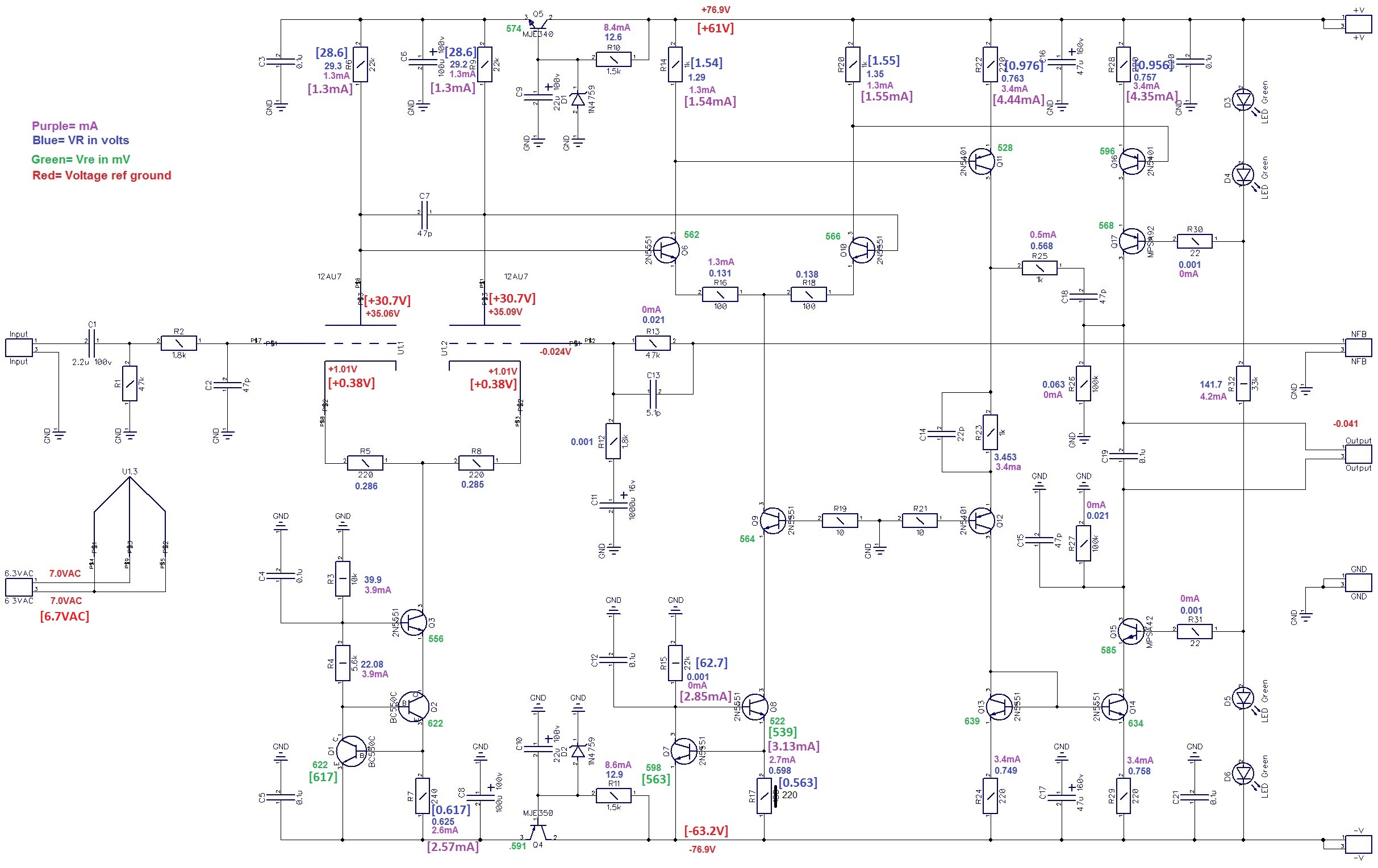

Maybe you could mark up a schematic with VR and VBE readings so I could have something to compare to. I had hoped that maybe I had the PD, VD reversed. You used all red wires and it is too hard to try to follow them but I just got home and rechecked and the PD is definitely closest to the V+ and ND is closet to the V- so I had it hooked up correctly. Weird thing is that it works fine if I tie the NFB from the IPS to it'self but when I try and tie the NFB from the OPS it looses it. I'm doing that again until I can be certain that the IPS is running where it is supposed to. I'll need those readings from you to do that.

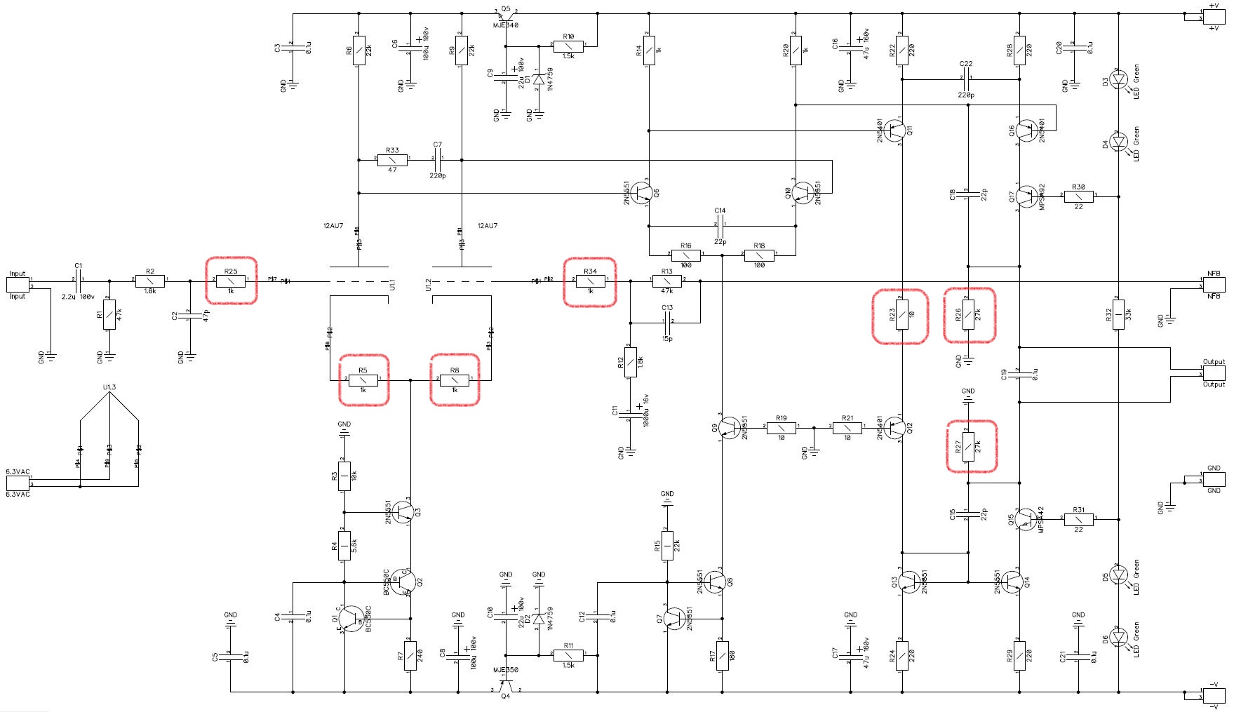

I first tried the "less tuned-up" version (first attachment) and then I tried the latest one, with some additional modifications. Both showed no issues. The second one is the most preferable in terms of both stability and overall performance.
Red boxes indicate what is changed comparing to the previous version.
Please don't pay attention to C4, C12 caps position on the pictures so far - they are in their initial position on my PCB. The way they are illustrated is reserved for future builds (potentially better PSRR).

Hmmmm, I made the changes to the board to match the latest schematic and tested it stand alone, and the oscillation is the worst so far so obviously I have something wrong somewhere. Looking forward to the schematic with your readings.
Here is the schematic with not all, but the most important readings.
You've got a very strange reading across R15 (22K) - looks like the meter has lost the contact or something - it can't be zero...
The tube is 12AU7, not 12AX7 by any chance? Well, I'm asking stupid questions as it is very strange it's oscillating... something is really wrong, we need to find out what it is :)
Power supply voltages coming from OPS are lower than expected in my setup (they were ok with my OPS, but pretty low with SlewMonster - I will check why cap multipliers take more voltage than expected. But this is not really important - the front-end is operational even with the the lower rails.

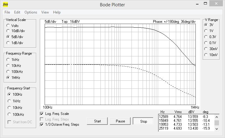

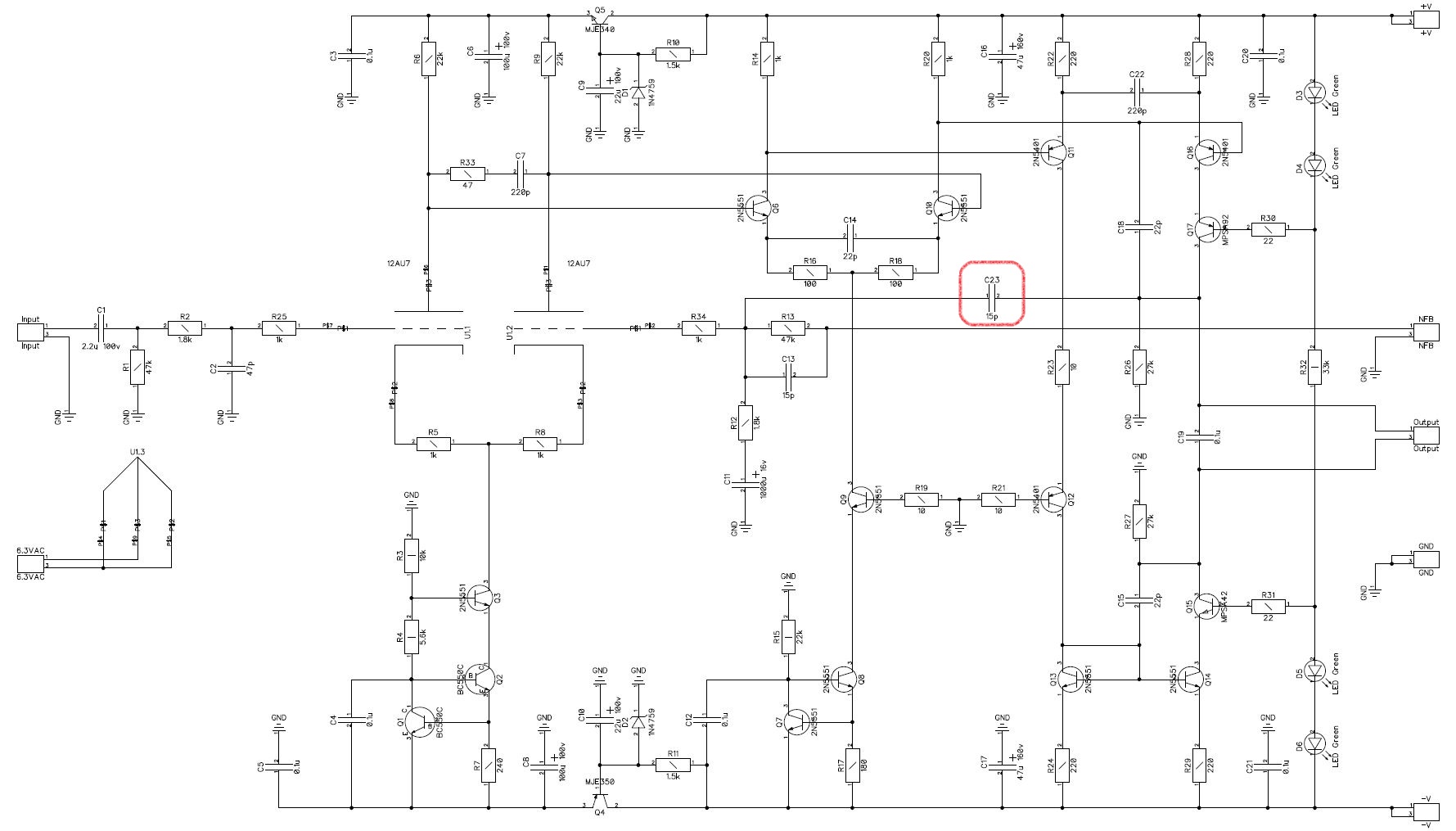

Just tested even more aggressive way to add stability margin. 15pF capacitor, marked by red square, adds a nested loop at HF, limiting the bandwidth and increasing the phase margin (see Bode plot), leaving no space for oscillation. A slight drawback is an over-compensated square wave response, but this is fine in the circumstances we've got. Let's try it this way (first the front-end alone, then, if everything's fine, carefully with OPS).

Hi Valery,
Success! It is working. I will try adding the cap you just added as well but it works. Not the best looking 100khz square wave but looks nice at 20khz. I have a 1.u cap in C1 because that's all I had but I have the 2.2u now so I will switch it out before I try playing music through it but no more rejection by the OPS. I'm pretty stoked. Going to mod the other board now to match this one.
