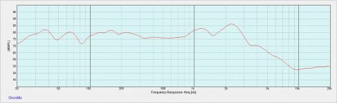

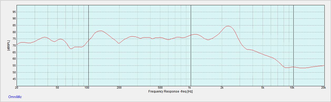

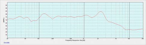

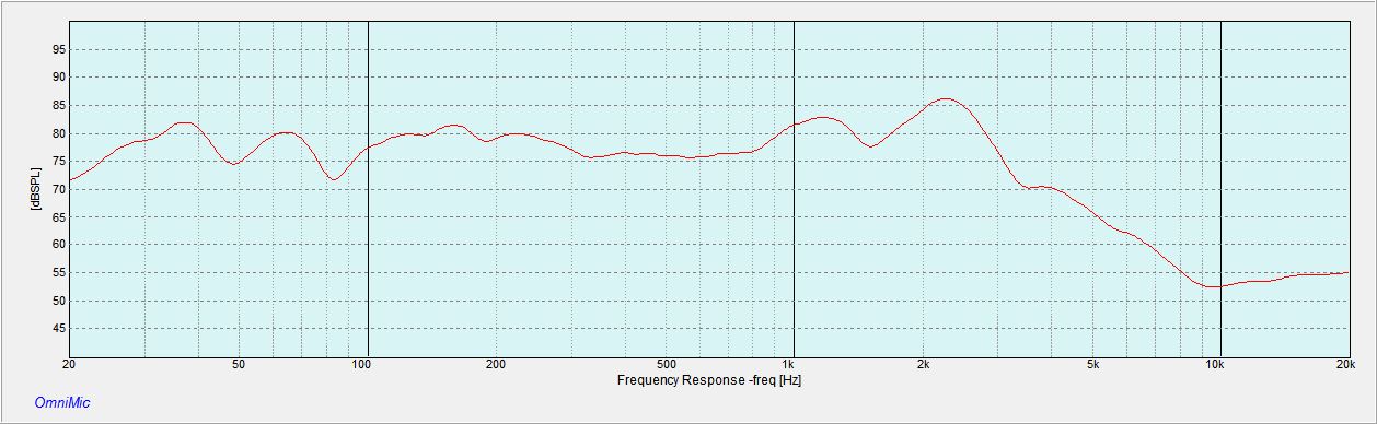

Attached sweeps
1-2: Separate left and right mono woofer only, running full range. Note right woofer is louder due to closer boundaries. They look better separately, but the interaction makes modes affecting the summed FR. Repositioning should help this.

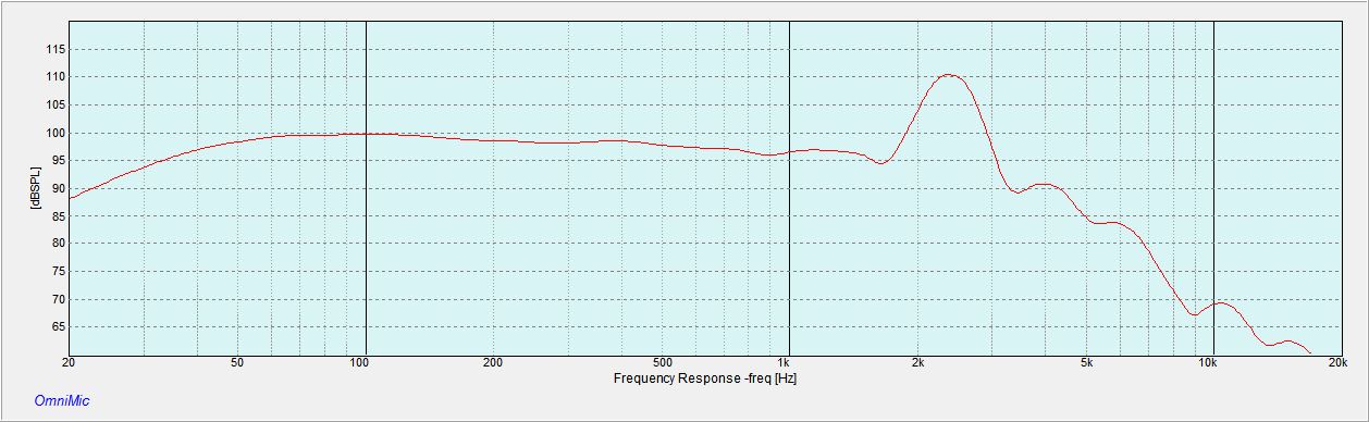

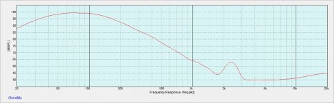

3-4: Left woofer, mic 1/2" from dustcap. With and without 2nd order low pass filter at 150Hz.

Although we don't see the whole pic here, it does seem promising to be able to achieve a good result. The non-linearities from the raw response is not bad at all- A few inches here and there and I believe you can achieve an even more linear response prior to EQ-ing.
To be able to detect room modes, you need to study un-smoothed single point measurements.
Since you are into DSP and active crossover, it is also an option to place the woofers different to the mid/tweeter since you cross-over pretty low. E.g. placing the woofers closer to the front wall for optimizing bass response and increase headroom. The mid/tweeters can be placed for minimizing comb filtering effects and optimizing midbass/lower mid response. You need off course to time delay the mid/tweeters accordingly to the woofers. At least you should try it before ditching it.

Having a second look at the LP filtered response. You have used 12dB/oct filter. Try going more brutal on the filter order. You will then eliminate smearing from the woofer in the mid region and increase power handling of the midrange driver. Varying the XO-point with a few Hz step at a time can also have great impact on the audible end-result.
So you think that the blooming, boominess is related to reflections? I'll try moving them around to see if it changes the tone. But honestly I'm not confident that speaker positioning is primarily responsible for the poor tone quality, especially since so many other speakers have had clear bass placed in similar locations.
