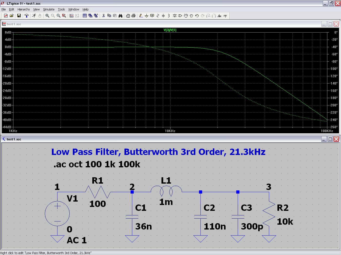

Any easy way to implement a decent low pass filter (an ultrasonic cut) for the output of a preamp? I'm concerned about potential buildup of stuff if there is already noise or other junk in 96khz material and would like to be safe just in case. Any common implementations? A cut off above 20k but under 30k would be preferable. Thanks!
An example of a passive 21kHz lowpass is attached:).
The filter has 40 dB attenuation at 100kHz. and zero noise.
The preamp output impedance (100 Ohm) is important for correct filter response.
C3 is the line capacitance (about 100pF / meter)
