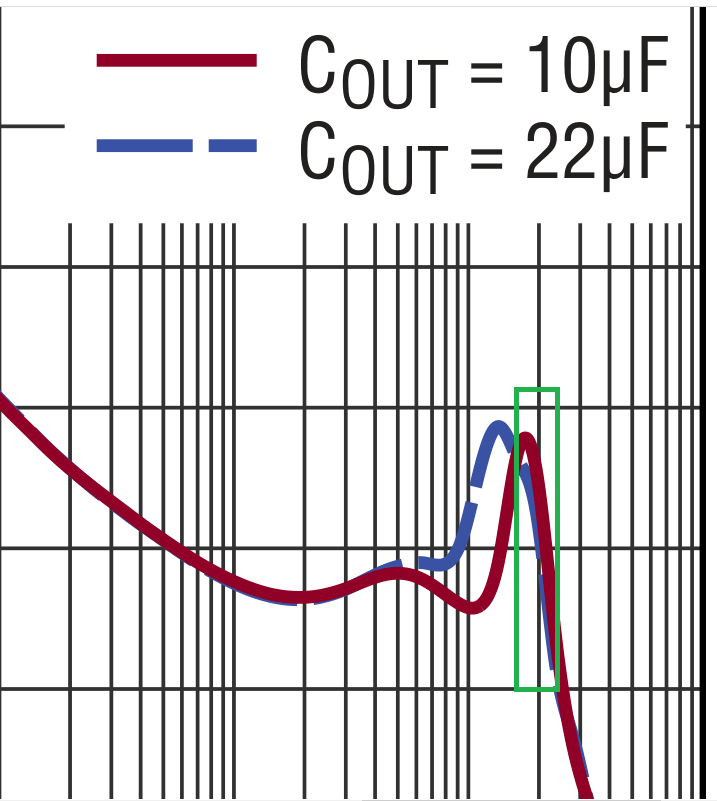

You are right too, I thought the graph expresses itself:
I referred to the bandwidth limitation region of the graph only. If Cout is 22uF, you are right - PSRR increases, but the inflection point of the graph is moving to the left and as you can see, if there is a ripple in the input circuit to aprox. 1.8Mhz is better for Cout to be 10uF because in the 22uF situation PSRR is already descending.
I admit it may look strange to someone who cannot read my thoughts. ;)
I admit the talk about 'inflection point' and such is creative. ;-) But it is not really about inflection point or bandwidth of PSRR. It is about the absolute value at each frequency, and with larger C the curve is always the same or above than with lower C. So higher C is better for PSRR.
Jan
Jan
As I already told you, I was referring to the region where the larger C curve is not above to the lower C curve, in the following context:
- the manufacturer says "larger values of output capacitor only marginally improves the performance because the regulator bandwidth decreases with increasing output capacitance"
- the graph in the datasheet only shows 2 close values 10uF and 22uF, but we were talking about 560uF and the difference between its curve and the lower 10uF C curve should be more significant.

"For stability, use a minimum 10µF
output capacitor with an ESR below 20mΩ and an ESL
below 2nH. Large load transients require larger output
capacitance to limit peak voltage transients.[...]
Given the high PSRR and low noise performance attained
using a single 10µF ceramic output capacitor, larger values
of output capacitor only marginally improves the perfor-
increasing output capacitance — hence, there is little to
be gained by using larger than the minimum 10µF output
capacitor. Nonetheless, larger values of output capacitance
do decrease peak output deviations during a load transient."
Where did this quote come from ? It seems to match my understanding.

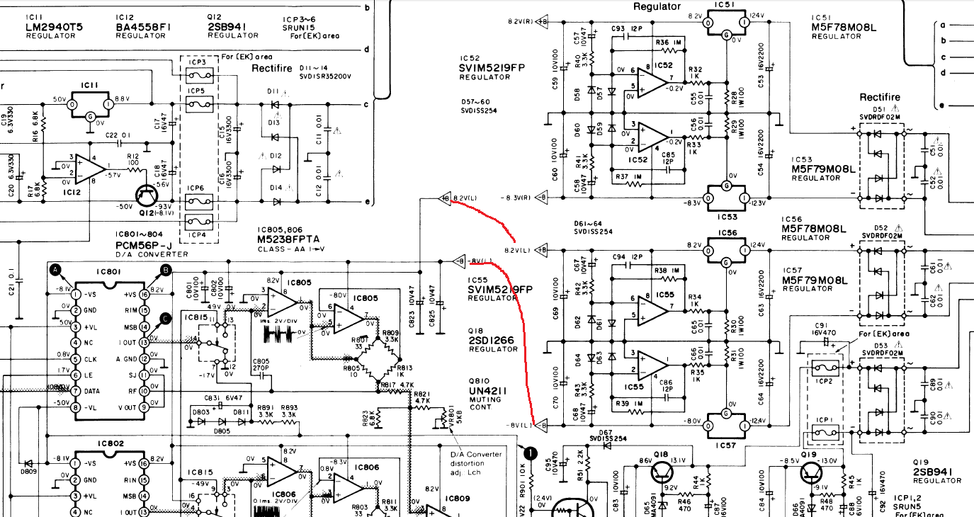

edit: there's also a denoiser circuit for 78xx type regs that is called fixnoiser or something like that and it also allows to vary the output of a 7812 for example, if I remember correctly. .
it's not called in any way...it was just used extensively by Technics in some high end cd-players of the late 80's ...and it can be easily modified for any higher voltage than 5v by using 78/7905 plus appropriate zenners.
https://www.diyaudio.com/forums/power-supplies/359652-fine-ic-voltage-regulators-28.html#post6353344

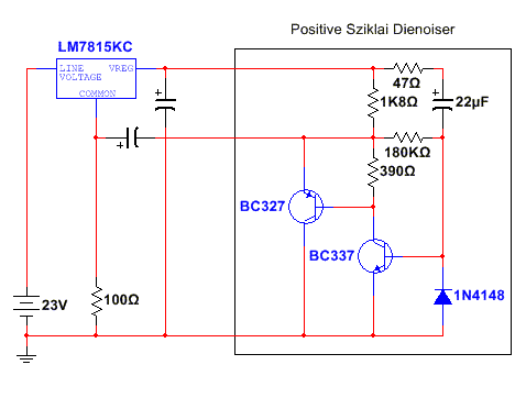

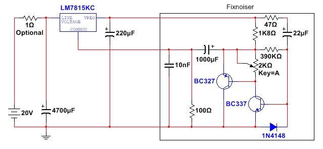

I wasn't talking about that. I'm refering to the dienoiser circuit that has been adapted for 78xx regs. It's called Fixnoiser and also provides variable output out of the fixed voltage output regs. They should be performance wise between a denoiser and dienoiser.
This is the schematic for the fixnoiser which has variable output out of a fixed output 7815, from this post D-Noizator: a magic active noise canceller to retrofit & upgrade any 317-based V.Reg.

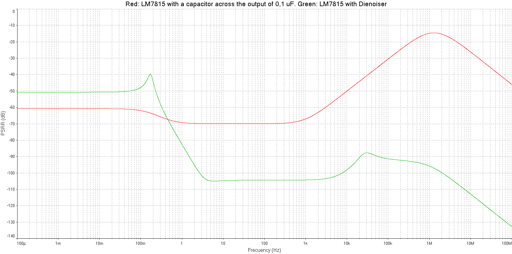

And this is how this version simulates:
804792d1577403918-noizator-magic-active-noise-canceller-retrofit-upgrade-317-based-reg-sziklai-dienoiser-fixed-regulator-gif
804793d1577403918-noizator-magic-active-noise-canceller-retrofit-upgrade-317-based-reg-sziklai-dienoiser-fixed-regulator-comparison-gif
So far I don't think anyone built and measured the 78xx versions yet. The pcb designs I made should be compatible with them tho, maybe someone does make and measure them at some point.
