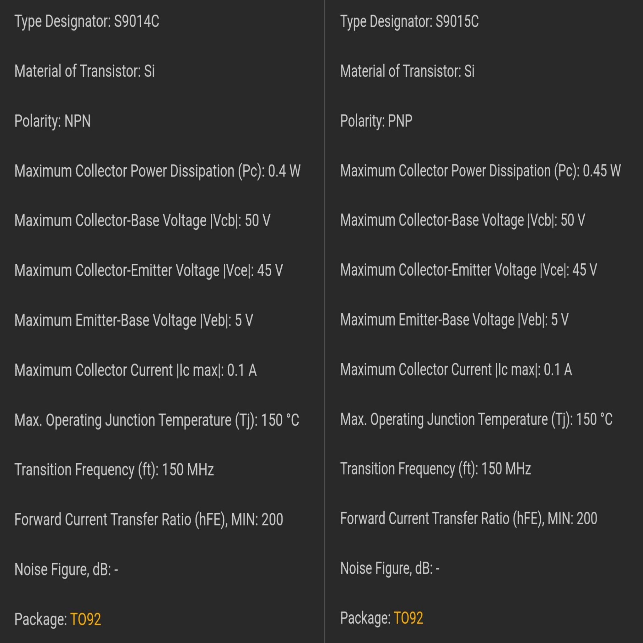

What are some good low noise bipolar transistors with good linearity?
9014's claim a 0.9db typical NF. but there's no noise chart.
they seem to be very similar to 2n2222's which also have around 0.9db NF.
2SC1815's meanwhile show a 1db NF and no chart. and they're far less linear too.
2SC1845's seem to have less noise, or are they just a HV version of the 2SC1815?

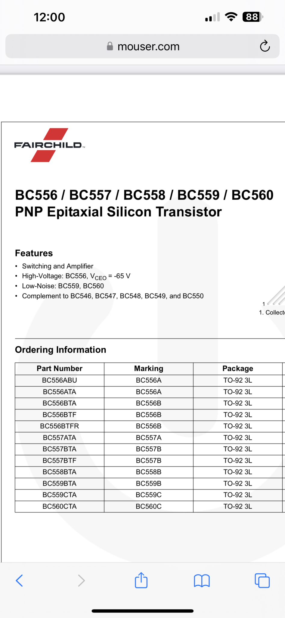

Bc550/560?
