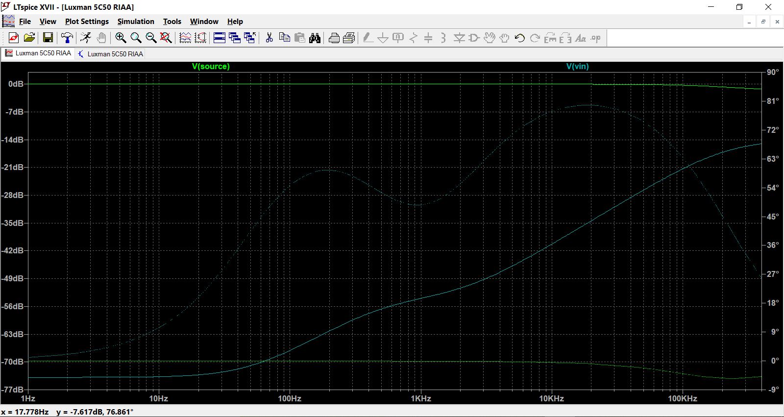

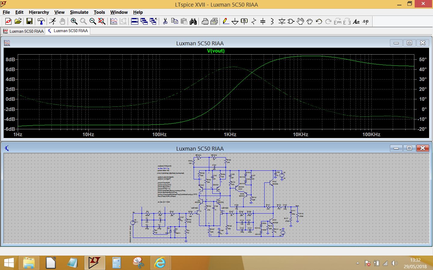

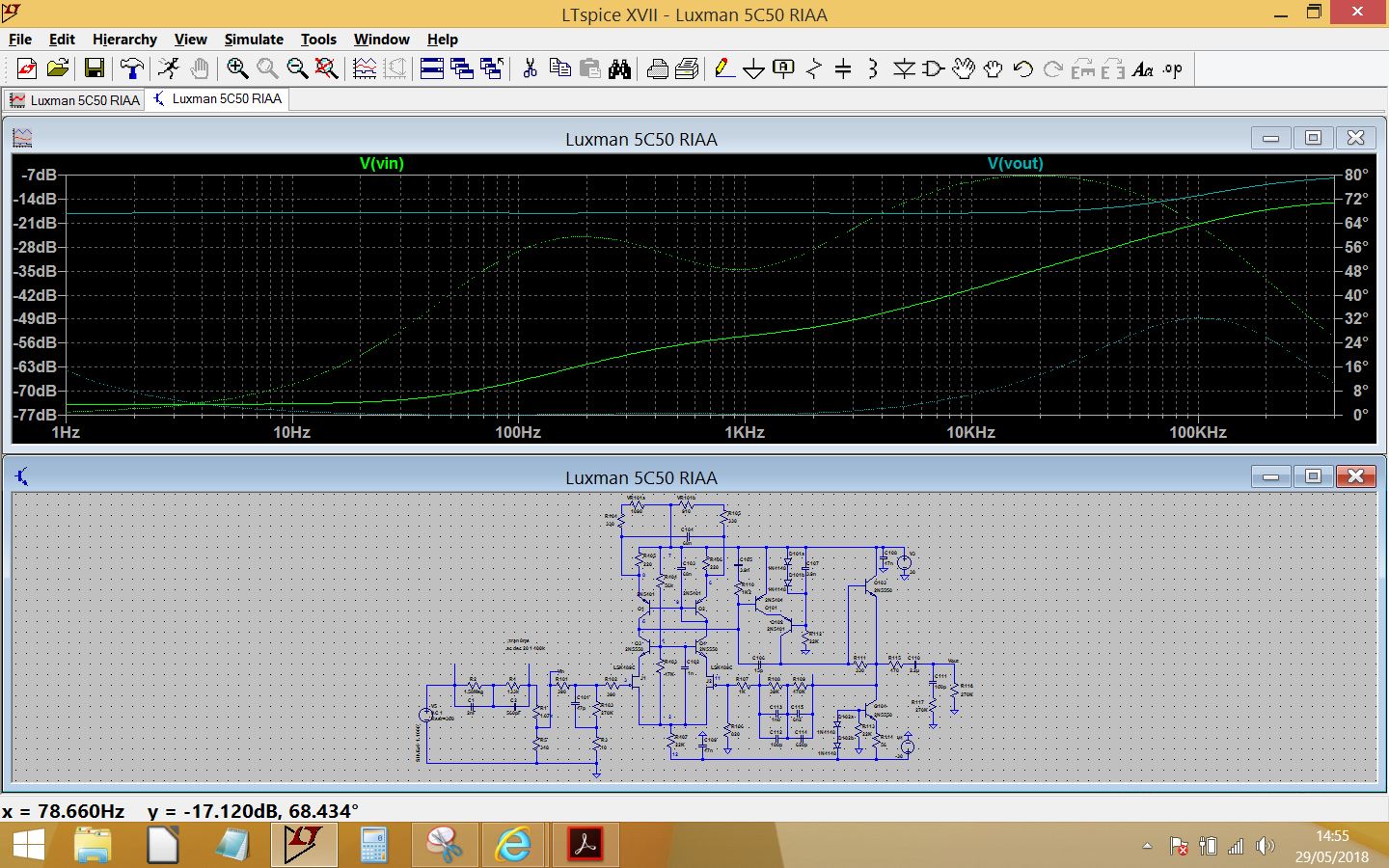

This shows the output of your inverse RIAA and then the output of the preamp. I would have to research what levels would be expected from the RIAA network but your version does produce a definite curve. Your preamp output is very non linear, I would check the time constants.

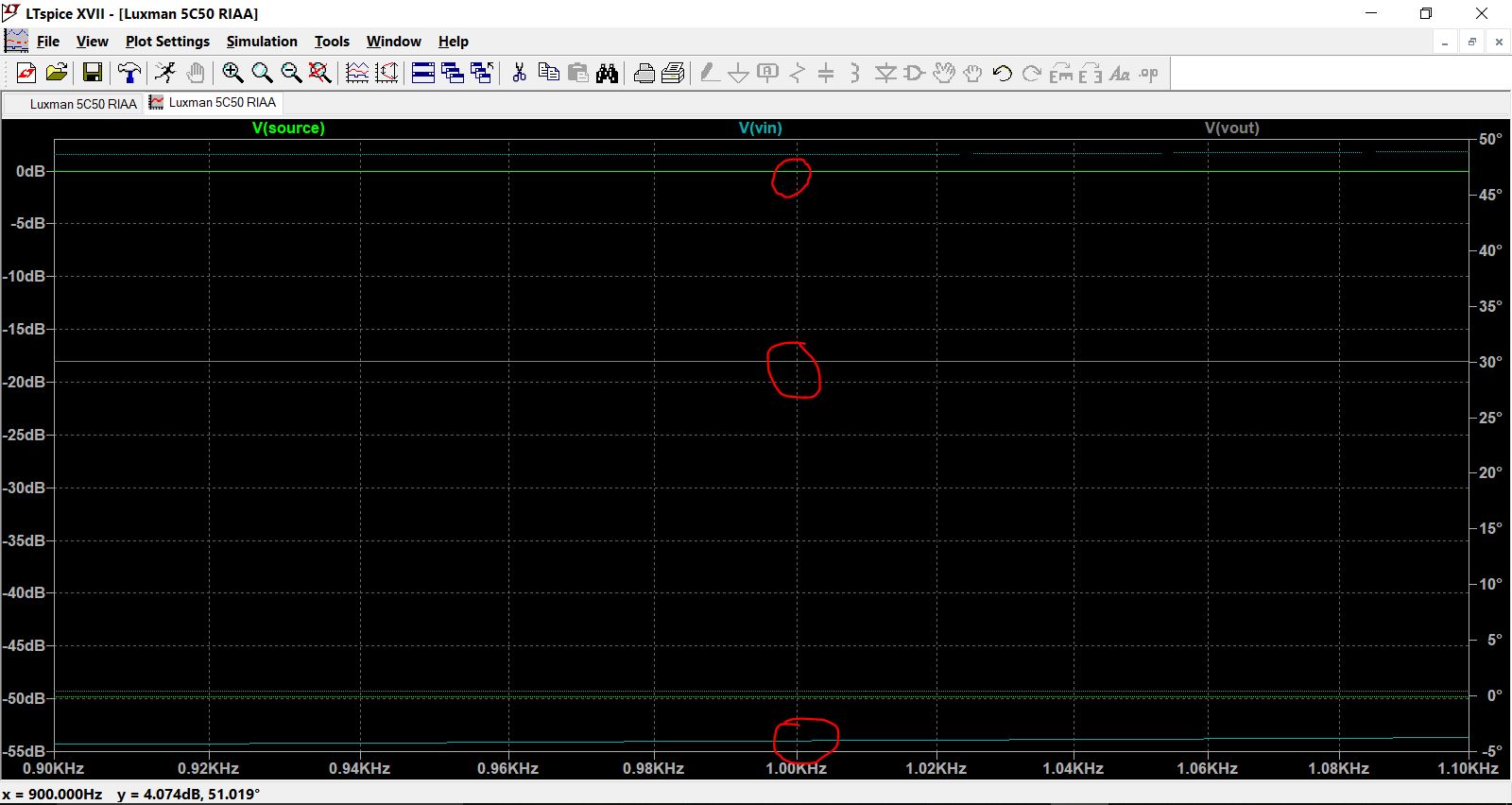

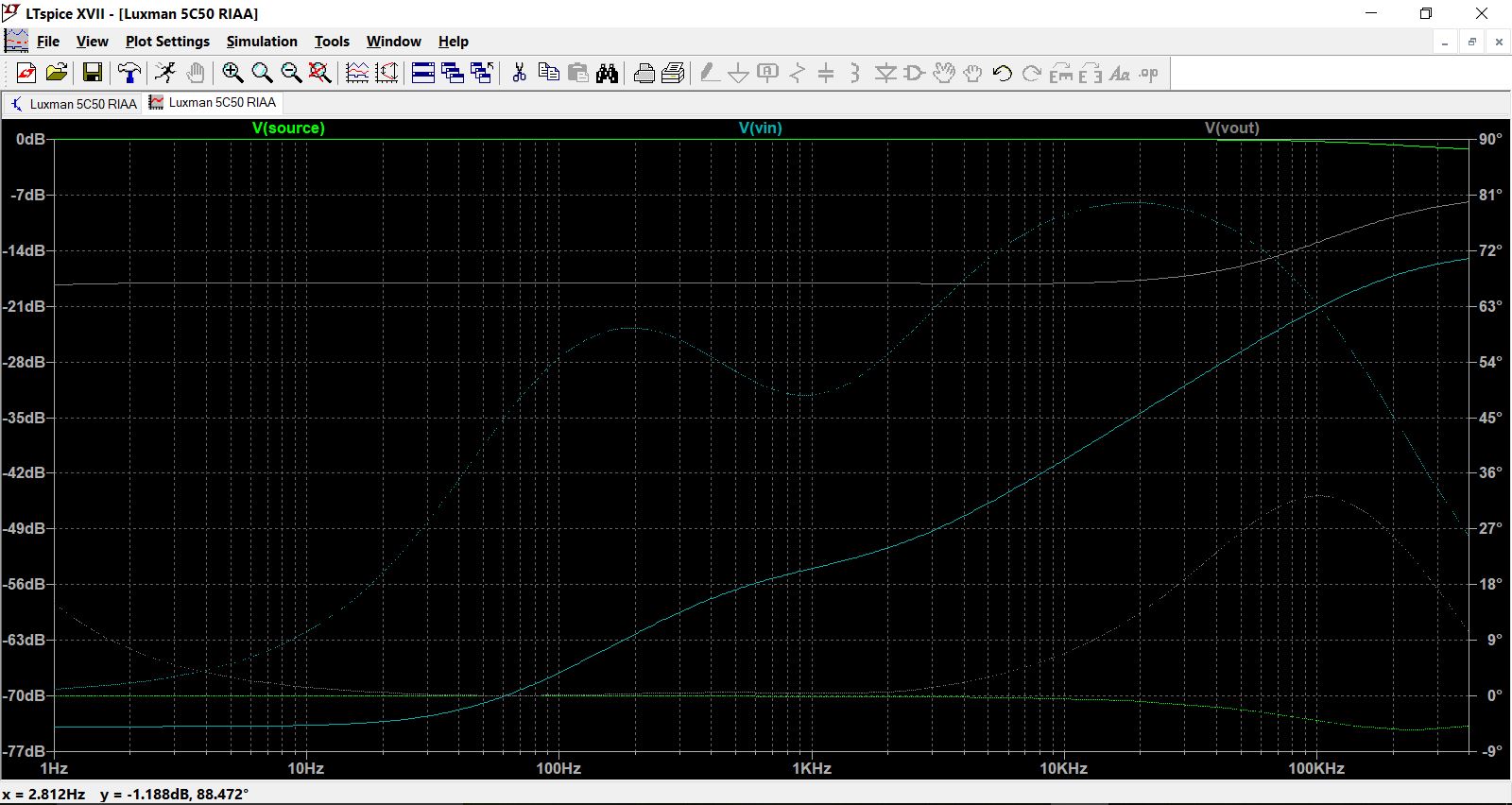

Like this ;) and your overall frequency response is the flat line at -18db
The generator has a reference level of 0db. It is 0db because we set the voltage source to have a '1' in the 'AC Amplitude' box. That is the standard value to use. This setting is used for the AC analysis run of the simulation and overrides whatever amplitude you have set in the normal way.
If you made that number 3 (for example) then the voltage source would have a starting value of 9.5db. It works like this. The level is 20log (V1/V2), so that is 20log(3/1) which is 9.5.
If we made it 27 then the starting amplitude would be 28.6db. 20log(27/1)
Try it :)
It is our reference voltage. I've also given it a 300 ohm series output impedance although that will make little difference.

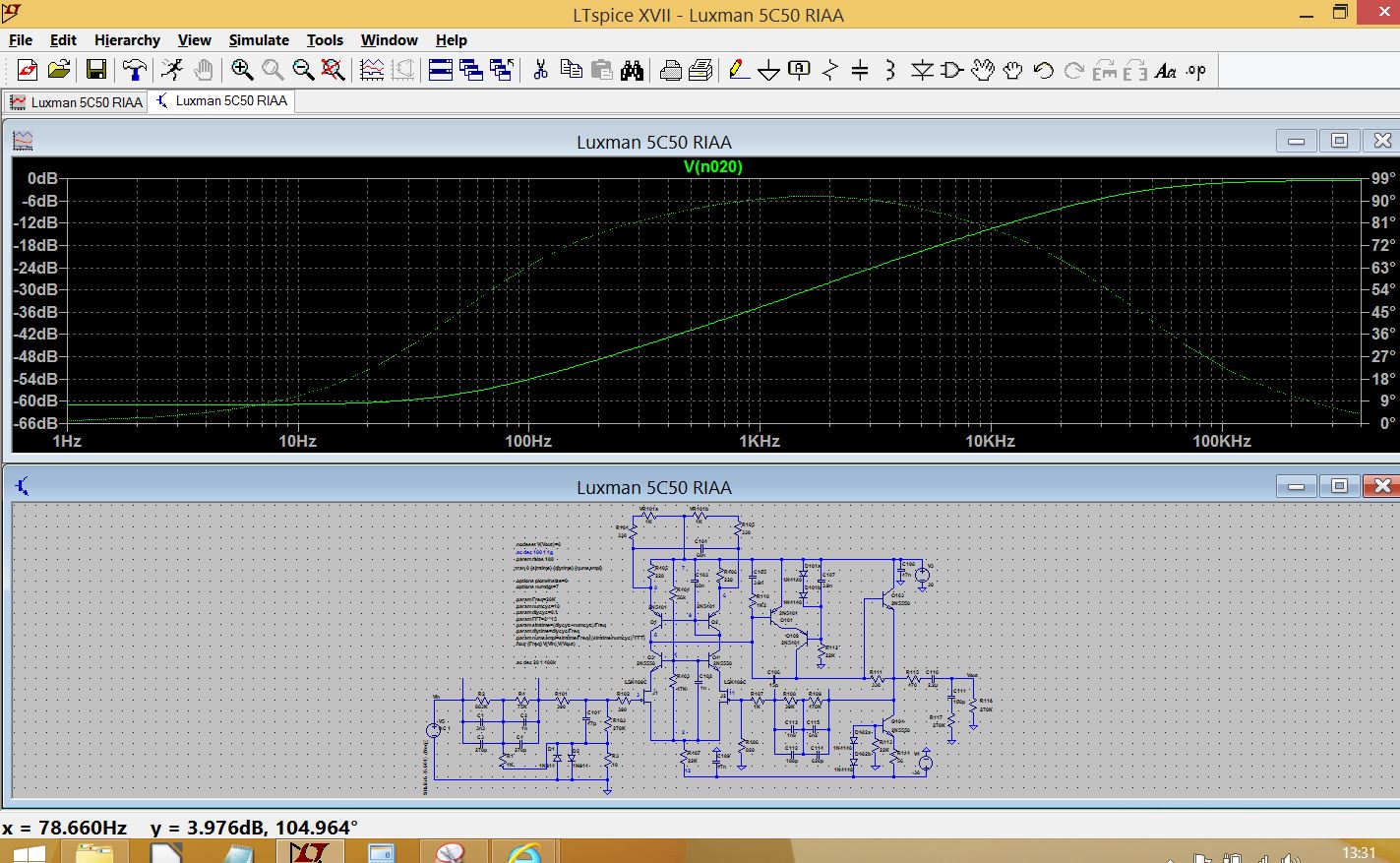

So we have 0db applied to the input of the inverse RIAA. The output of the RIAA is a curve following the official time constants. That gives our voltage 'Vin' which we apply to the amplifier.
Pick a point on the curve (say 1kHz) and look at the amplitudes. The input to the amp is -54db down at 1kHz as applied to the amp via the inverse RIAA network.

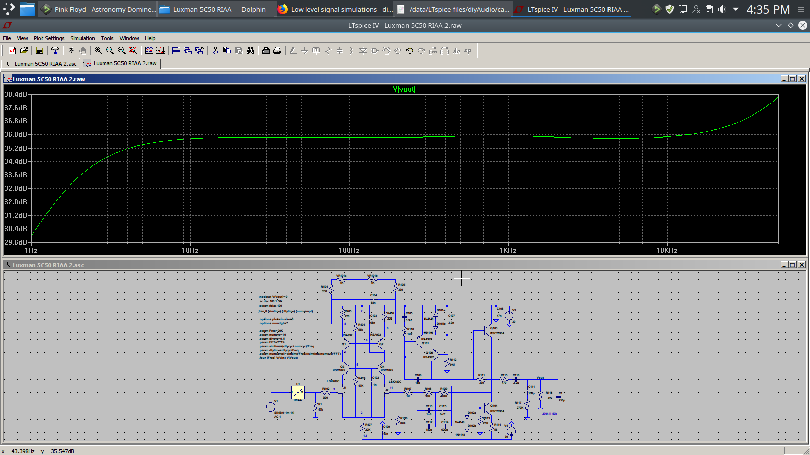

Now add the output of the amplifier to the traces and we can see that at 1kHz the output is at -18db.The third image is a close up of that. So the gain of the amplifier at 1kHz is -54 - -18 which is 36 or 36db.

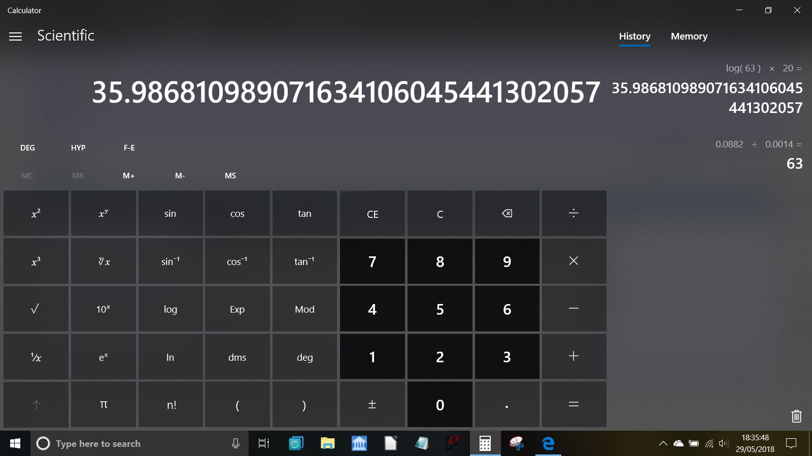

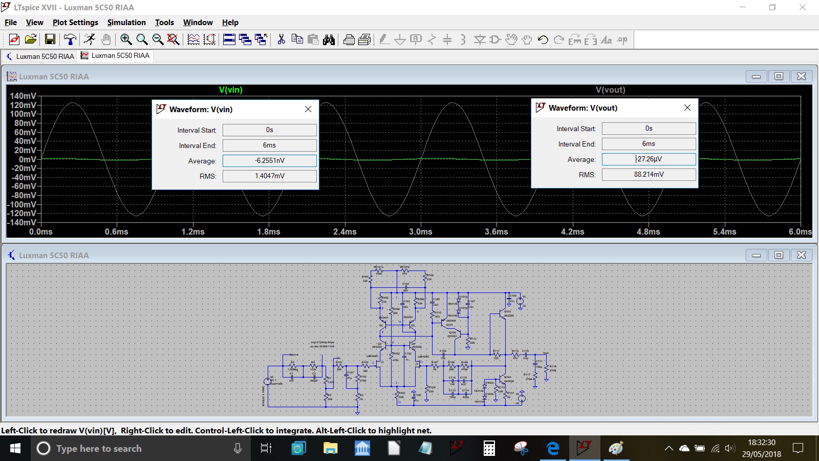

Lets prove it works by changing the simulation to a normal analysis and apply a sine wave of 1kHz.
Now we can see that we have 1.4mv applied to the amp input, and we get 88.2mv output.
Gain equals 20log (Vout/Vin) which is ;) (see last image). It agrees 100%.
