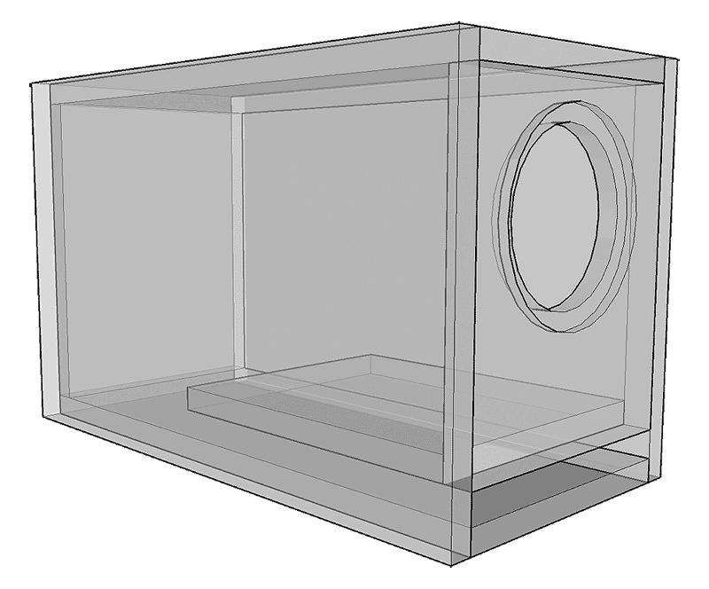

Hi Dave, I'm starting to like the sound of these and the price is certainly right
Are you thinking a simple 1" front port or slotting like you have on your designs?
http://p10hifi.net/tlinespeakers/FAL/downloads/VarKalEL-191111.pdf
dave
planet10 [url said:http://homepage.mac.com/tlinespeakers/FAL/downloads/VarKalEL-191111.pdf[/url]
dave
OMG... You've taken my sketch and made it into a working design.... just for me..... what a Gent
All I need to do is put about 10 degree of angle on the front face and I'm in business
Cheers Dave, VERY much appreciated.

Hi Dave, I had problems getting 15mm plywood so I've gone for all 18mm
As a result I've had to re-jig the dimensions based on what fits within my cabinet.
Is the revised design OK with that port length?... I assume it is, as the internal volume is very similar

As long as you retain the internal volume and CSA/length of port the same, you can feel free to juggle the other 2 dimensions ( height and depth) within reason. Just don't reduce depth to the point that net aperture to port slot is occluded by back wall damping material.
A few well placed spacer blocks under the front of raw rectangular boxes should provide all the angle adjustment required. Keep in place with double edge foam tape or PSA velcro.

Cheers Chris, I was about to glue the cabs last night but stopped myself to just make sure first
Assumming that you have the net volume the same, you have decreased the cross-section of the vent, and increased its length by 3mm thus tuning it lower by a tiny bit. Shortening the shelf by 4mm will put it back in the same ballpark, but driver to driver variation would likely swamp the vent difference.

Cheers Dave,
The cross section of the port has reduced because of the increased material thickness (6mm total)....but kept the length the same as your design. (the baffle was 18mm in your design anyway). So the net volume of the port is smaller but the same length.
The net volume of the whole cab is still the same however.

When you decrease the X-section of a vent you also need to decrease its length to keep the same tuning.
When i looked at my drawing quickly this AM, i thot 15mm baffle on mine, but it was 18 so length is the same, shorten by a mm should keep thing sthe same. If you want to check my guess, i did up this vent sizing doc.

Cheers for that Dave, calculus isn't my strong point but.....
If port 'volume' is the critical part of the tuning then I need to reduce the length by about 8mm or make it thinner by 1mm. Crikey, I didn't realise just how critical the port tuning is
Is that right or am I being a bit thick
Also, can I ask what the tuning frequency is for that volume? I'm guessing about 60 hz?

Hi guy's, cabs are done but I've left one side removable for now so I can tweak things...
With regard to the felt lining of the panels can I use this stuff?
I have an abundance of this Polyurethane foam to hand but not felt.....
Also, I'm not sure what to do around the port? Do I leave it clear by a inch or so?

That stuff is not nearly as effective as the felt but it will do in a pinch. Keep the vent clear of restriction.
