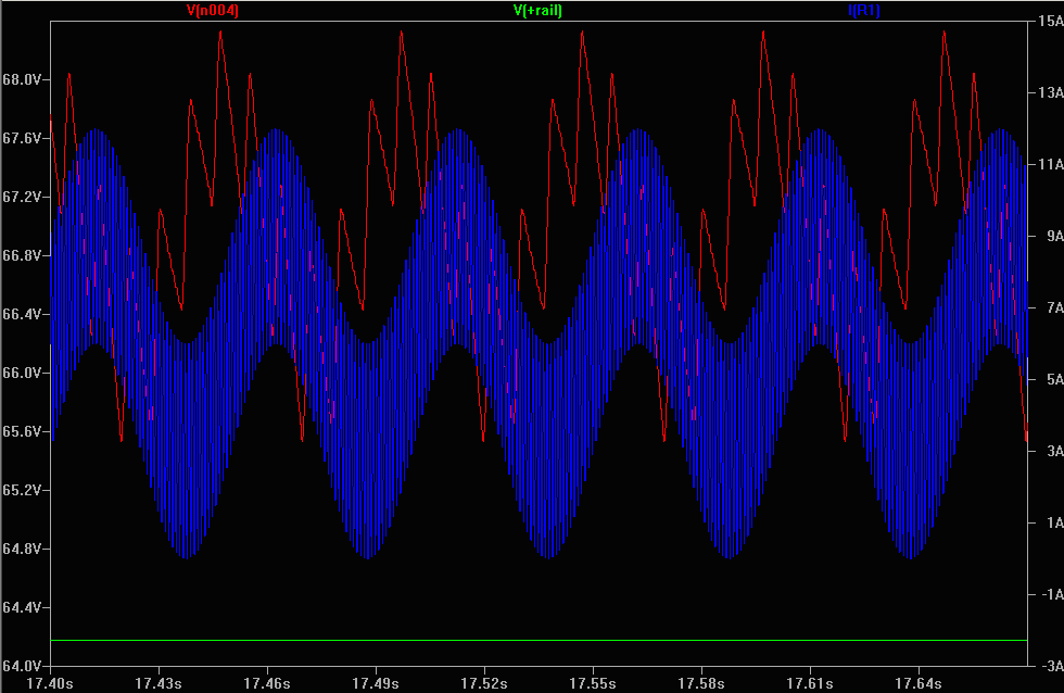

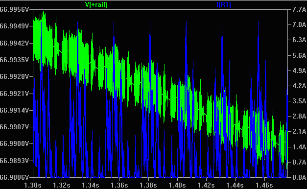

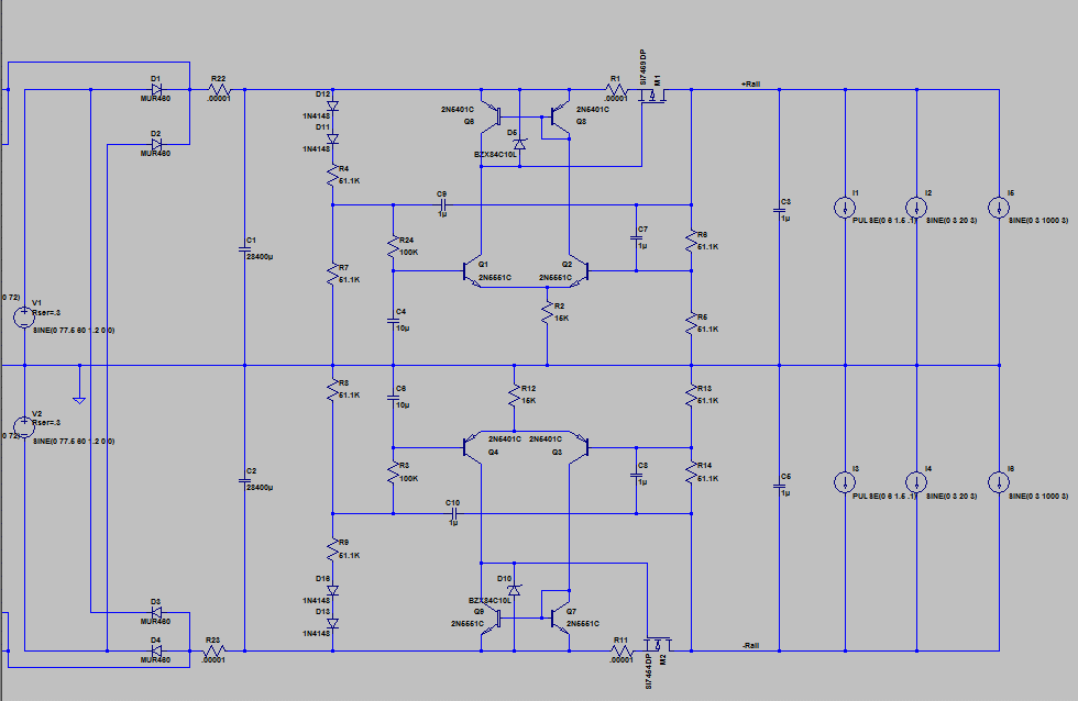

Hey Guys,
I've been working on an active power filter for an amp I'm designing: Think Bybee Music rail.
This one is pretty simple, but offers exceptional ripple rejection with a low drop.
Using low Rds P-ch MOSFET and a pair each of 2N5551 and 2N5401, the results have me quite excited to build it up. The model I'm running has given me around 2mV total ripple with an output current draw of up to 12A peaks. The load current sources are a fixed 6A, a 3A @ 20Hz, 3A @ 1000Hz. I don't have a spice model for the IRF5210 so I substituted the Siliconix Si7469DP which seems to offer similar characteristics. The negative rail compliment uses a low Rds N-ch.
Here's a few shots of the simulation showing both the total ripple with current as well as the unfiltered and filtered voltage for comparison. Ripple has been reduced by a factor of just over 1000, or a little more than 63dB. Total dissipation in the MOSFET is around 15W with average delivered power of nearly 400W.
I honestly can't say if this has been done, but it's probably not new. I'm very pleased with the results as you can probably tell.
2mv of ripple with 12A peaks is very impressive! and it looks like you are only sacrificing about 2V to do it too. :)
Tony.

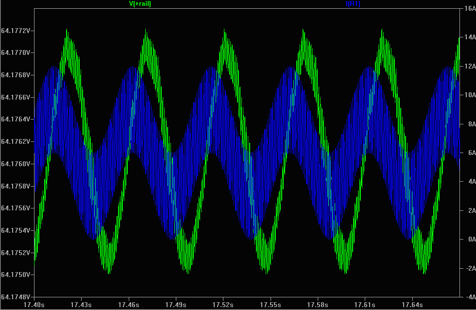

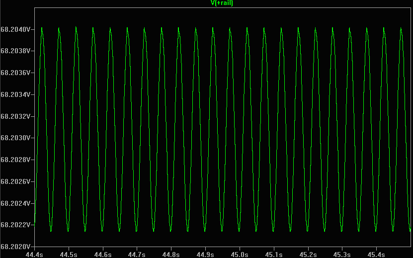

2V was the target. If you remove 1 of the diodes feeding R4 and R9, you can get even less overall drop. But that does result in an increase in ripple when a full 12A peak 20Hz modulation is employed. In reality, such a demand on an amp would be exceedingly rare, so a single diode would probably be more than adequate for music signal loads into 8 Ohm.
Here's a shot simulating full power 20Hz into an 8 Ohm load and a single diode feeding R4.

That could be quite a handy circuit if it performs as simulated. I have used the the LT1085 before for similar purposes but it only goes to 7A
The IRF3210 and IRF3415 can handle 40A with a 200W power rating (given adequate heat sinking of course). This set up should be able to clean up virtually any power amp supply you could think of. Parts cost is very reasonable.

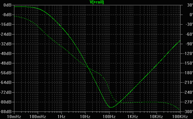

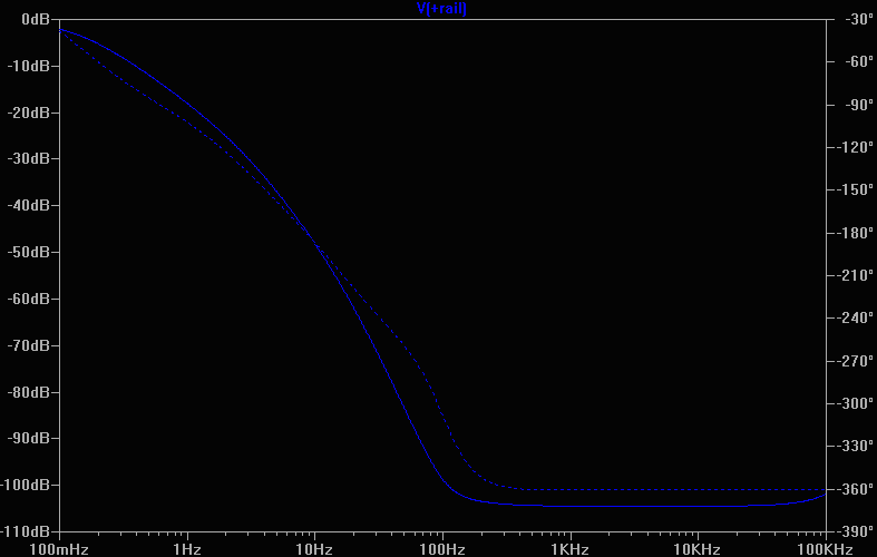

Here's a shot of the transfer function of output ripple/input ripple. This does a serious job of attenuation over the frequency range where current draw is highest via music power (below 300Hz) which creates the largest ripple levels on the main filter caps.
Adding a shunt regulator to this one for high frequencies may be beneficial though. I may have to break out LTSpice and do just that.

Interesting design! Somewhat similar to AMB's a22 The σ22 Regulated Power Supply but you have some new good stuff in there. You've eliminated the zener in the voltage reference (I'm assuming the 1N4148s are less noisy than the zener, but haven't checked specs), have the mosfets turned the other way for a LDO rather than source-follower, and your positive and negative halves are completely independent. I especially like that last point since that issue makes troubleshooting the a22 a little harder - when one rail goes in a certain way they both go. Probably no pressing need for the mosfets to be configured as source-follower since the reference voltage for the error amp is sampled after the mosfets in both designs.
But I do like AMB's idea of feeding the voltage reference parts with the separate cap multiplier to create clean(er) power from the main rail, at the expense of a couple of volts. Especially in the case of really large currents moving through the main rails (and associated IR rail ripple), which both designs can handle. I've suggested to AMB before of connecting the cap multiplier(s) to the main rail through an inductor to help nuke any any frequency noise that otherwise would zoom right through the cap mults. Also beefing up the cap mult transistors to BD139/140 and putting a reverse diode across the BE junction given the caps on either side. I also like how AMB has actual current sources feeding the LTPs, rather than the (16k) resistors, for higher impedance looking back in. Those current source diodes are getting scare and pricey though. Probably better at this point to use a depletion mosfet or BJT based ccs.
agdr.
Thanks for pointing out the Sigma22. Very similar circuit topology for sure. But unlike the Sigma22, this unit is not regulated. The diodes act as a fixed voltage drop to allow the reference voltage to track the average voltage on the main filter caps. This allows the MOSFET to maintain a fairly constant 2V drop, minimizing power lost in the device. The way the circuit is designed, it is basically acting as a 2nd order lowpass filter with unity gain. As the input level changes slowly, the output will track. But higher frequency variation, like rectifier ripple, is filtered out. It's sort of an active version of a CRC supply with much higher rejection capability in the frequency range where most power will be drawn from the supply (below 400Hz).

Thanks for the thoughtful reply.
Here's a shot of the transfer function showing the 0dB rejection at DC (LDO output tracks average line level) with maximum attenuation at just over 100Hz and then slowly rising after that. But there's still 40dB attenuation of 10KHz input noise on the output. This transfer function is with a typical ampilfier load at idle (500mA bias draw).
I'm using a MOSFET with Rds at full on that won't exceed .06 Ohm. Even with 15A peak draw, the device won't be dropping even 1V. The only time the device would ever see that kind of current draw would be with 4 Ohm loads pulling 500W, which will be exceedingly rare. Even then, all that happens is the device simply acts as a .06 Ohm resistor for the duration of the peak current draw. During the amplifier operation in Class B, when the positive current draw goes to 0, there is some overshoot on the LDO recovery. I've included some other shots showing the input ripple using an AC source of 1V@120Hz and 70V offset, and .15 Ohm source impedance. The load is an amp using a multitone music simulation signal. The closeup of the LDO output looks a bit hairy, but in reality, the levels are quite small. I've included a spectral content of the rail under load as well. The two spikes you see are part of the test signal fed to the amplifier load. The spurious stuff is over 100dB below the output signal level (20dB).
The amp circuit I will be pairing with this LDO already has PSRR of around 80dB at 120Hz. Increasing that to a total of 120dB or more doesn't seem like a waste of time if you're trying to make the quietest amp you can, especially for use with high sensitivity speakers.

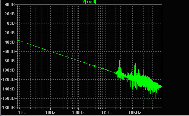

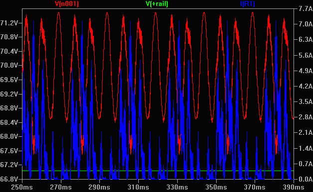

OK, some progress and a thorough simulation. The power supply is fed with full bridge rectifier and AC voltage sources. The amplifier is fed with a 5 tone test signal simulating a real world music signal. Peak output power into 4 Ohm load resulting in 930W instantaneous peaks and and 15A peak current through the LDO.
The pictures show spectral content of the amp output, the LDO rail, and the rectifier side of the LDO. Also shown are the input and output of the LDO in the time domain as well as a shot of the amp output signal.
It appears that the use of the LDO greatly cleans up the power rail, far more than even doubling the rectifier cap bank would do at a much lower cost. This simulation is done with 30,000uF on the rectifier filter and 6000uF on the LDO output.
