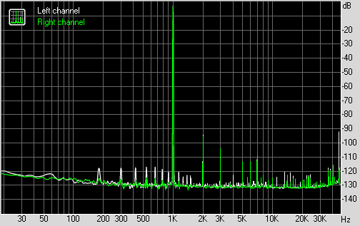

Emu 0202 could produce distortion due to ground loop between USB ground and Scope ground. Trying Jensen transformers may help a lot. I use unplugged laptop running from battery for low thdn so ground loop is no more. I enjoyed Emu 0202, 0404 and Tracker for years due to low distortion. Their Line OUT to XLR IN or Headphone OUT to XLR IN connections allowed recording of wave file with THD+N down to 0.0004% I double checked zeroes, no mistake here, EMU 0404. Of course to go that low I had to adjust Line, Headphone out and XLR sensitivity to get exact 0.0004% or in one case 0.00035%. Not on each EMU 0404 unit would go down to 0.00035%. EMU 0202 and Tracker allowed 0.0007% easily.
Peter
