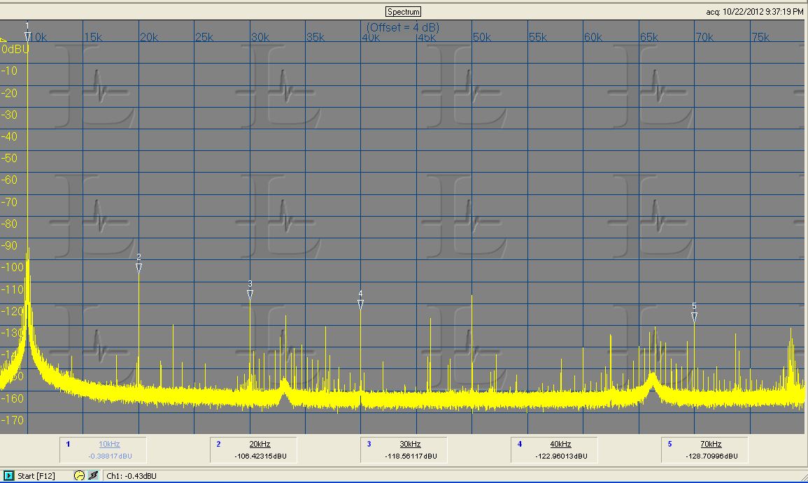

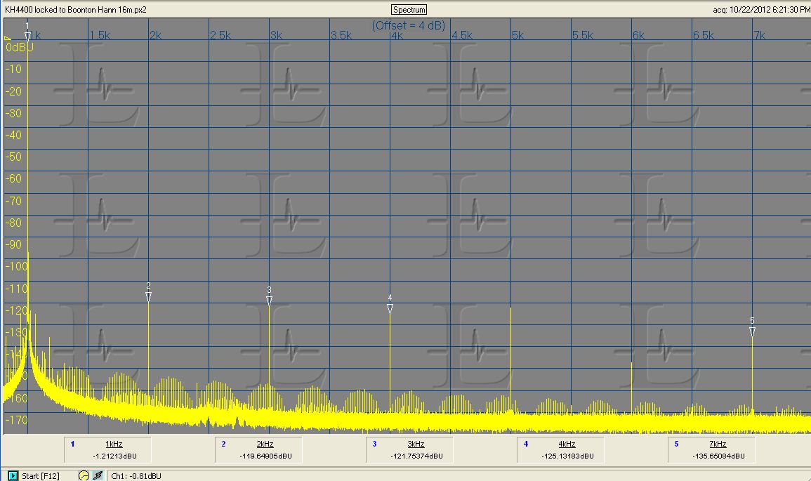

I have modified the KH4400 for injection locking. It helps when doing the really high res stuff since the generator has enough drift and phase noise to limit measurements. Here are measurements of my KH4400 using the AKM5394A (and 16M point fft) (locked to my Boonton)
I saw a cheap KH4400 on ebay a few days ago. I don't think there are customers for them at the usual $500+ price range.

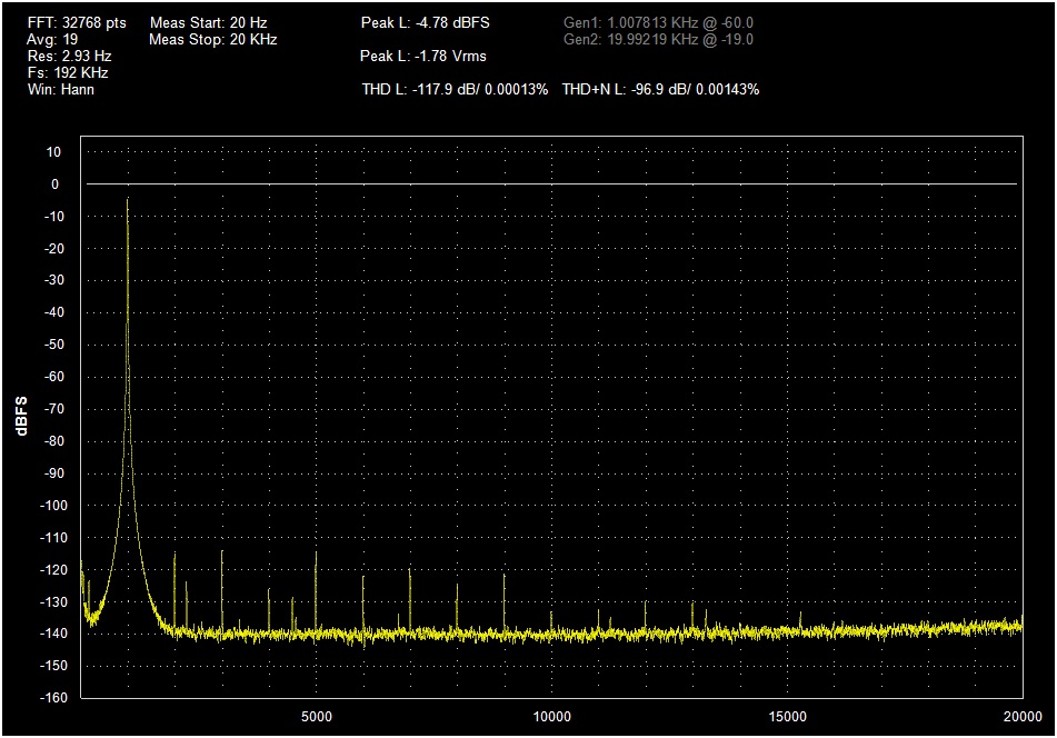

Interesting situation here --- Two oscillators - the 339A and Victors -- show very low on ShibaSoku.... verified Victors oscillator distortion spec. BUT, the FFT from the new unit QA400 shows both at -100-ish (<1.0 v rms). Now what the heck? -RNM
You are bumping into the Crystal ADC's limits.
I have attached a plot of the same generator as above (KH4400) measured with the QA400. You can see the difference in the distortion floor. Other key tricks, you must get the frequency to be precise or the bins will miss. That's why I added the injection lock to the KH4400. Make sure the internal generator matches the frequency since that is what their software uses to determine the harmonics.
The QA400 software is a good start and will get useful results immedately. However if something like HPW-works were to support the hardware I would find that very helpful (hint!).
