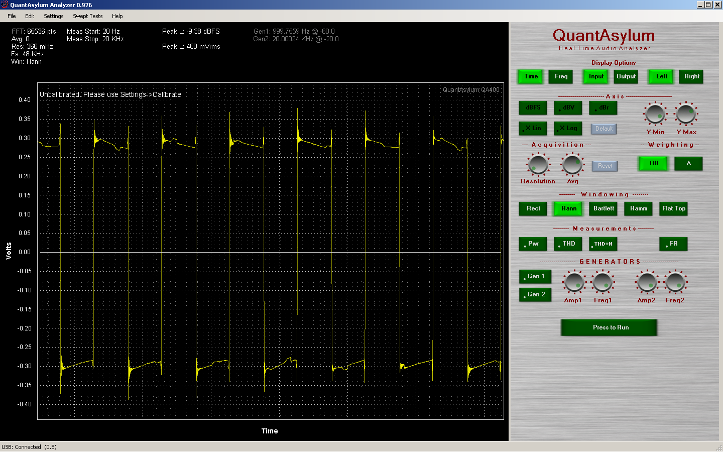

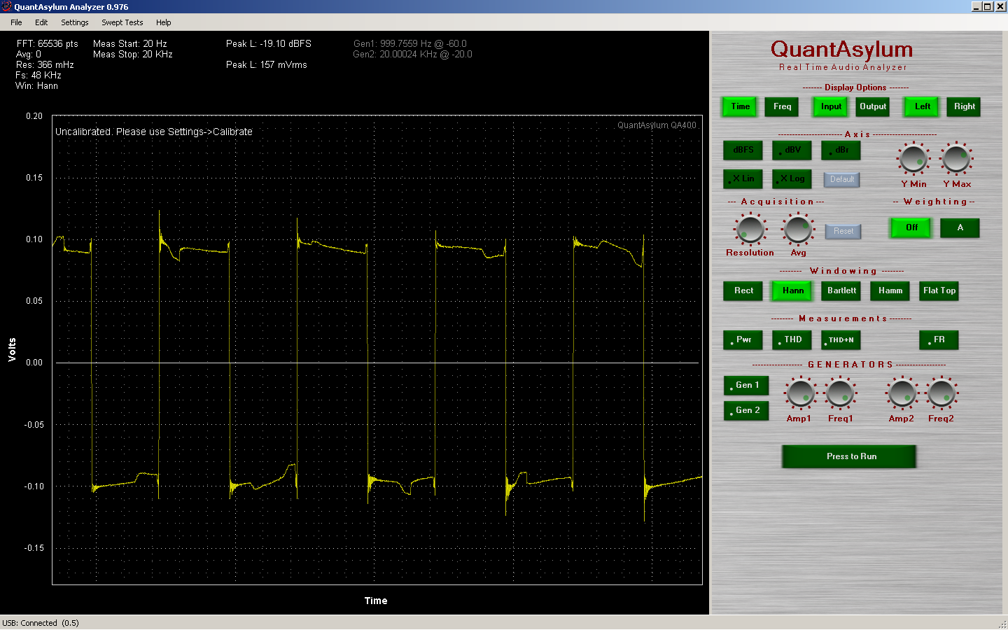

I have the 7220 in series with a 100 ohm resistor.
Input to the series is a 600mVpp square wave.
The QA400 is connected to the vertical output of the scope.
The first shot is the output of the function generator and the second is the voltage across
the 100 ohm resistor in series with the lamp.
I've been trying to measure the tau of the lamp but no luck.

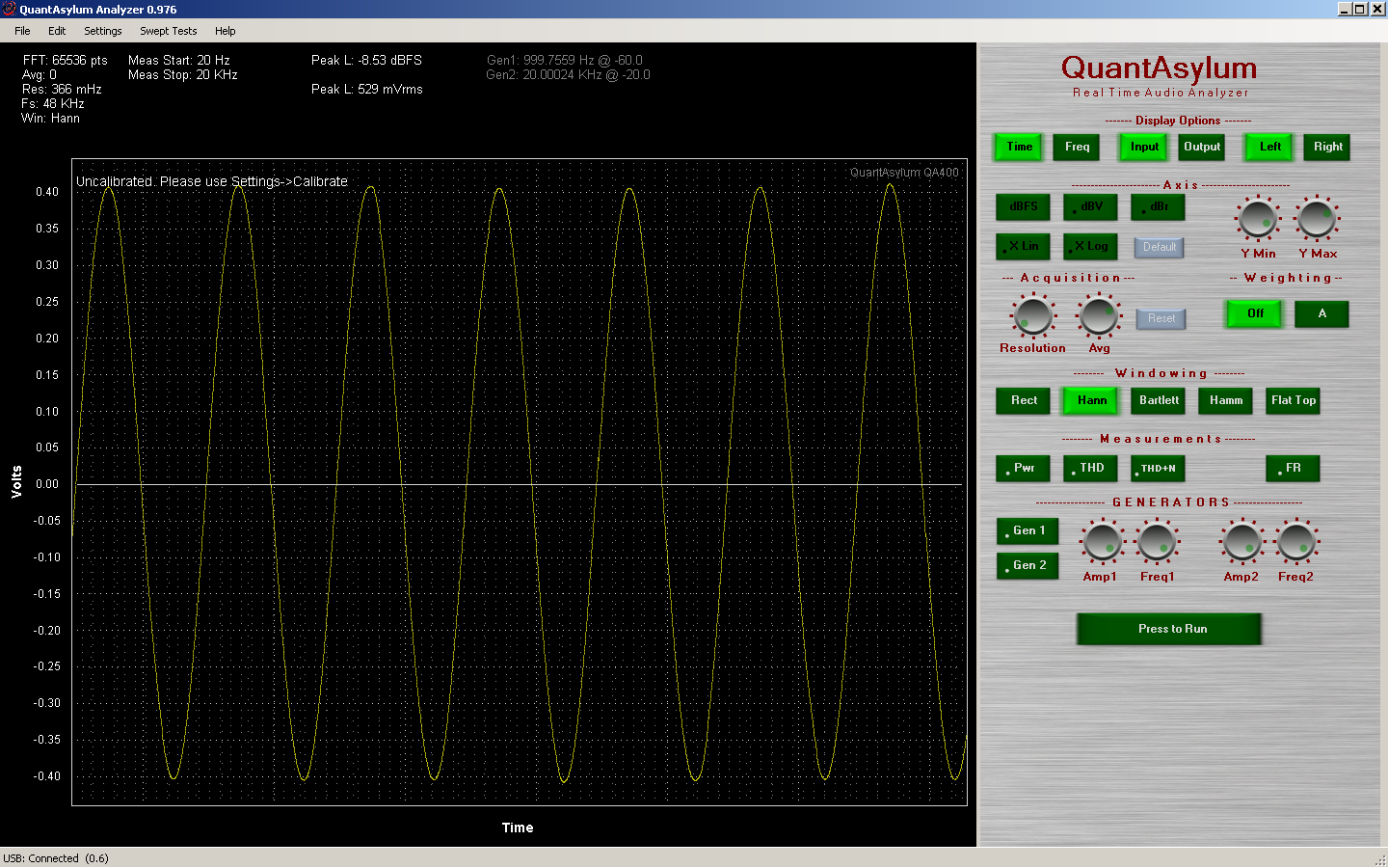

Also with a sine.The waveform is clean on the scope.
The ringing is from the QA400.

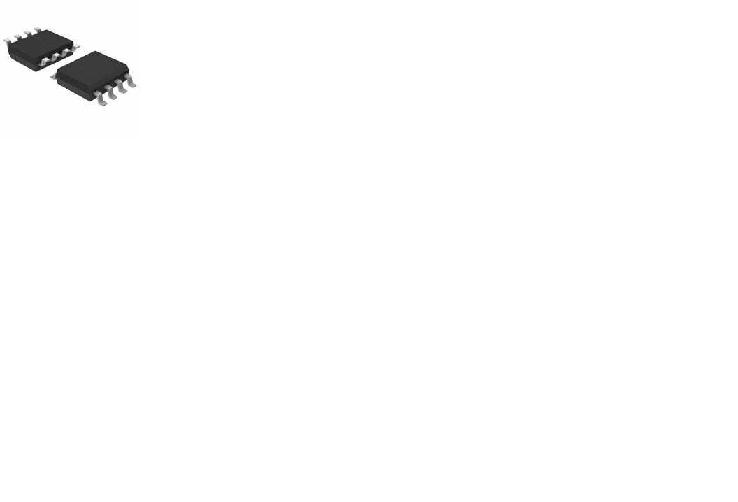

David, are you playing with optocoupler with photovoltaic output and 339a JFET A1Q2 or
with photo FET optocoupler?
http://pewa.panasonic.com/assets/pcsd/catalog/apv-ssop-mosfet-driver-catalog.pdf
http://www.fairchildsemi.com/ds/H1/H11F1M.pdf
Oh, I see... Correct?
Oh, I see...
Hi Dimitri.
The Panasonic APV1122A.
Those other things are terrible.
photo FETs? slow?
A lot of distortion too for a part that says distortion free in the data sheet.
I was very disappointed.

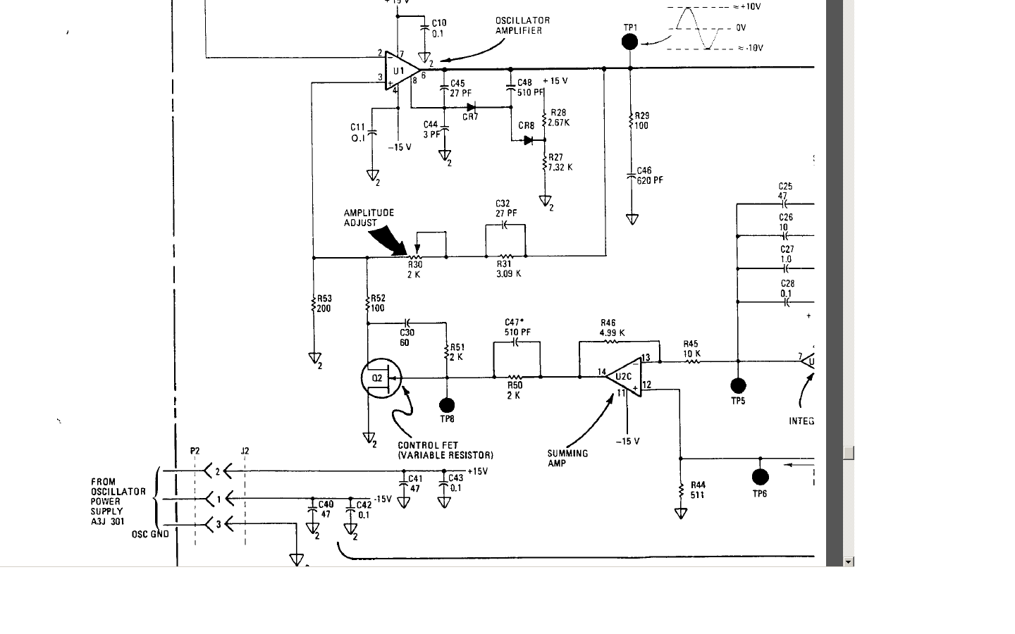

Update on 339a mods
I've done a few more mods to the 339a oscillator and to the balanced modulator board.
I replaced the level pot in the oscillator with a Bourns 10k cermet. This squashed a large 3rd H I just couldn't seem to get rid of. This was a repair.
I replaced the VCR2N with PN4392 Jfet which drove both 2nd and 3rd H down further.
I bypassed the capacitor C30 in series with R51 and added a 100uF electrolytic cap in series with R52. I replace trim pot R30 with a cermet single turn 2K pot.

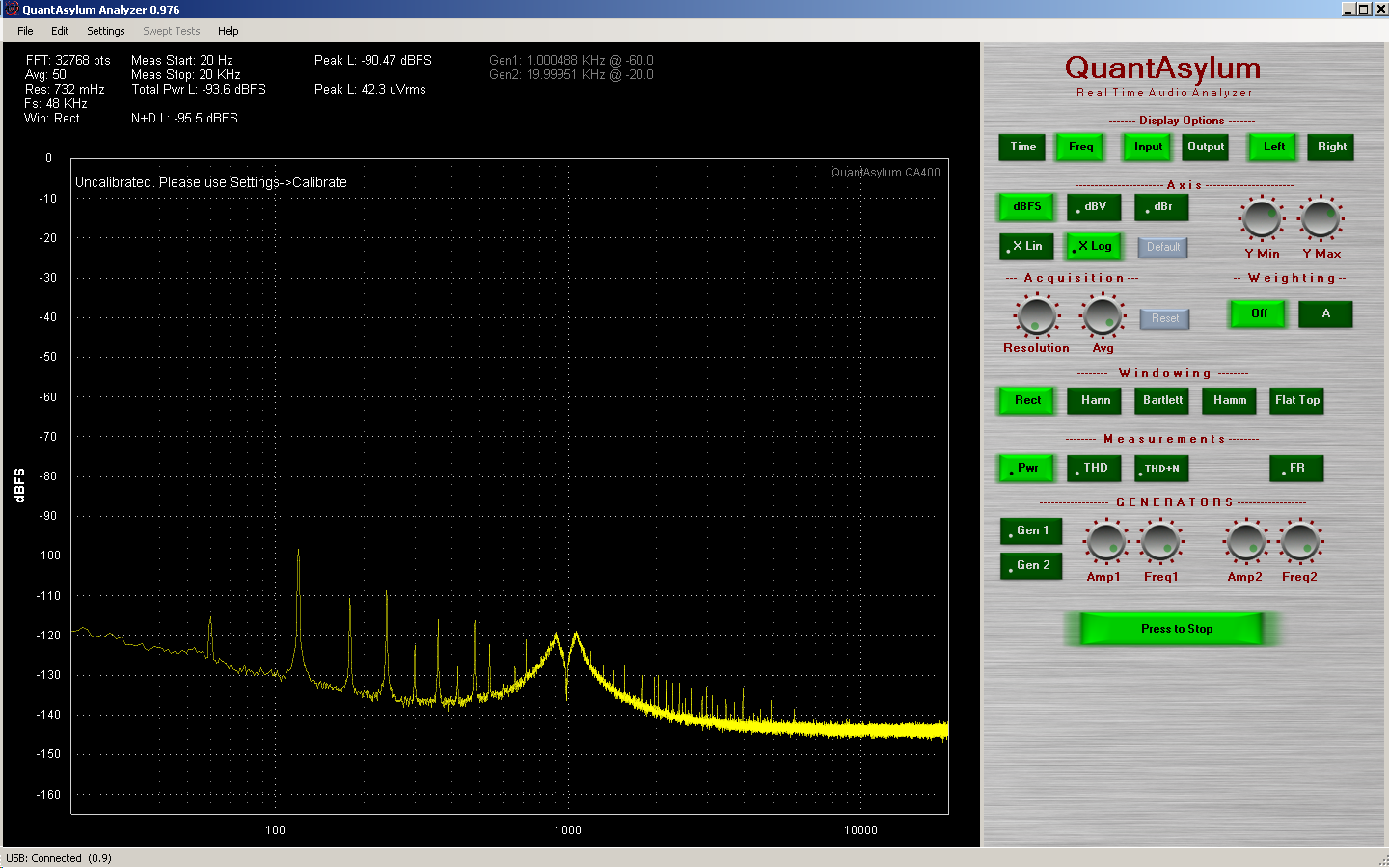

With some tweaking of the amplitude level trim and distortion trim pots got the following results from the oscillator.
The balance modulator board has R5, R6, R32 and R33 changed to 10k. R7, R8, R34 and R35 changed to 1K. I added a balance 10k trim to A3U4 wired same as the balance trim for A3U2. CR1 and CR7 are removed and R10 and R39 are bypassed with a jumper.
A3U1 was replaced with a 1468 in a earlier mod and R1 is set at 200 ohms.
All trim pots are changed to multi turn cermet pots.
This reduced the noise and distortion when setting the balance trims.
The balance trims are set by probing the test points ATP1 and ATP2 with FFT at 1KHz and tweaking the trims for minimal level of signal and harmonics on the the test points.
Here are the results.
I will confirm this measurement once my Twin T is assembled.
