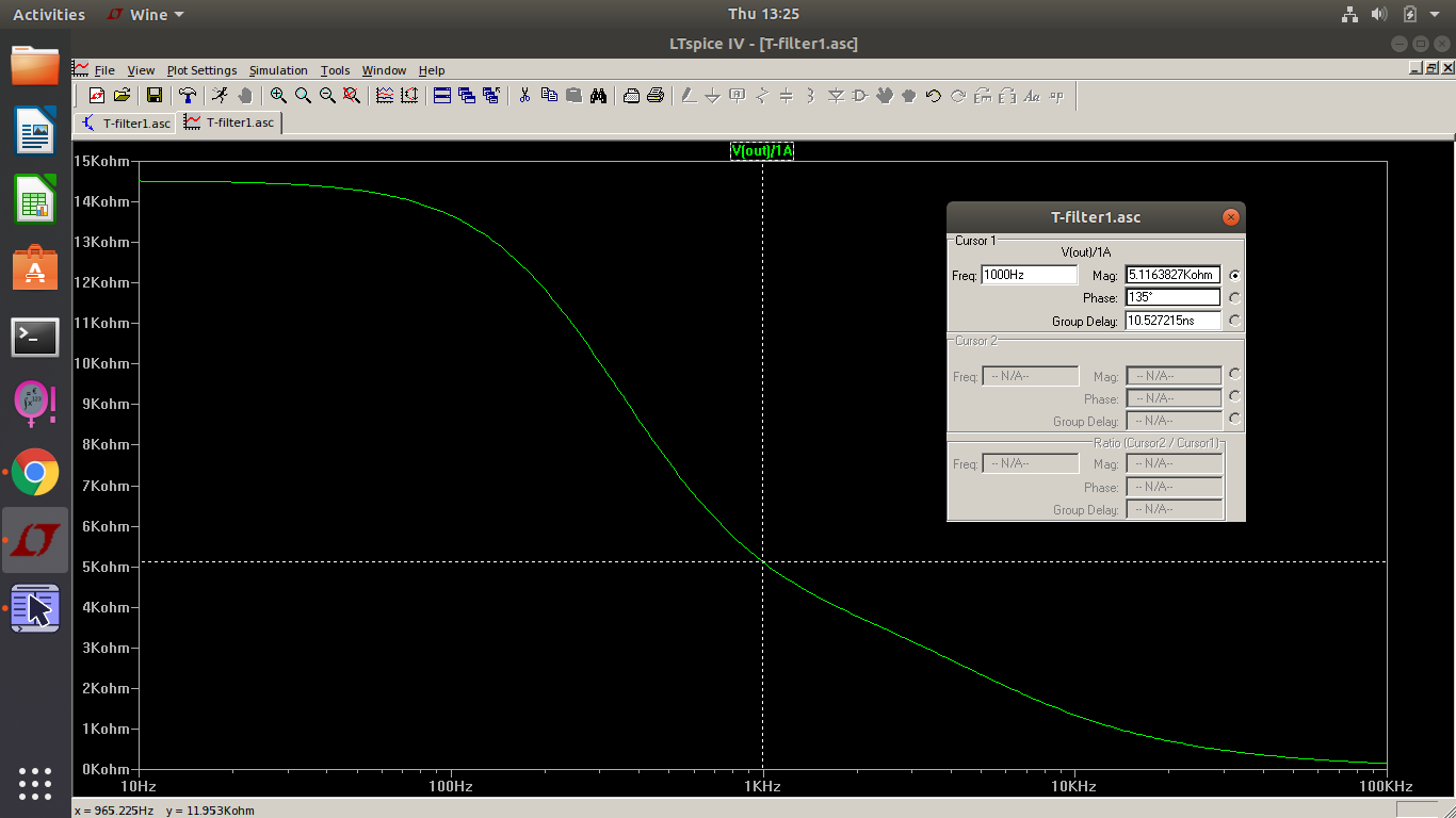

The changes are most certainly negligible but so is -120 dB distortion. Look at the output impedance of the passive notch and use that as the source Z for testing the different opamps. I'm attaching a quick sim I tried which shows around a 10K source.
This is the output impedance of Viktor's 1k passive notch filter (source imp = 50R)
The output z should go to almost zero to have lowest thd in the next op amp stage, but the notch filter is as it is. Maybe an active notch filter, but according to Victor that introduces new thd into the chain.
You can build a low z notch filter with 100nF MKP caps, but in that case you need an input buffer. More thd from caps, more thd from the buffer.
Today I did some simulations. Having no input buffer is not so bad when you use e.g. the notch from Victor. The measurement error is with H0=1kHz
Zout src = 600: H1-H10: -0.7 dB .. -2.5 dB
Zout src = 200: H1-H10: -0.2 dB .. -1 dB
Zout src = 100: H1-H10: -0.1 dB .. -0.5 dB
Zout src = 50: H1-H10: -0 dB .. -0.2 dB
You can live with that. You must be careful to have a DUT that doesn't have a large output impedance, e.g. 1k ..10K.
