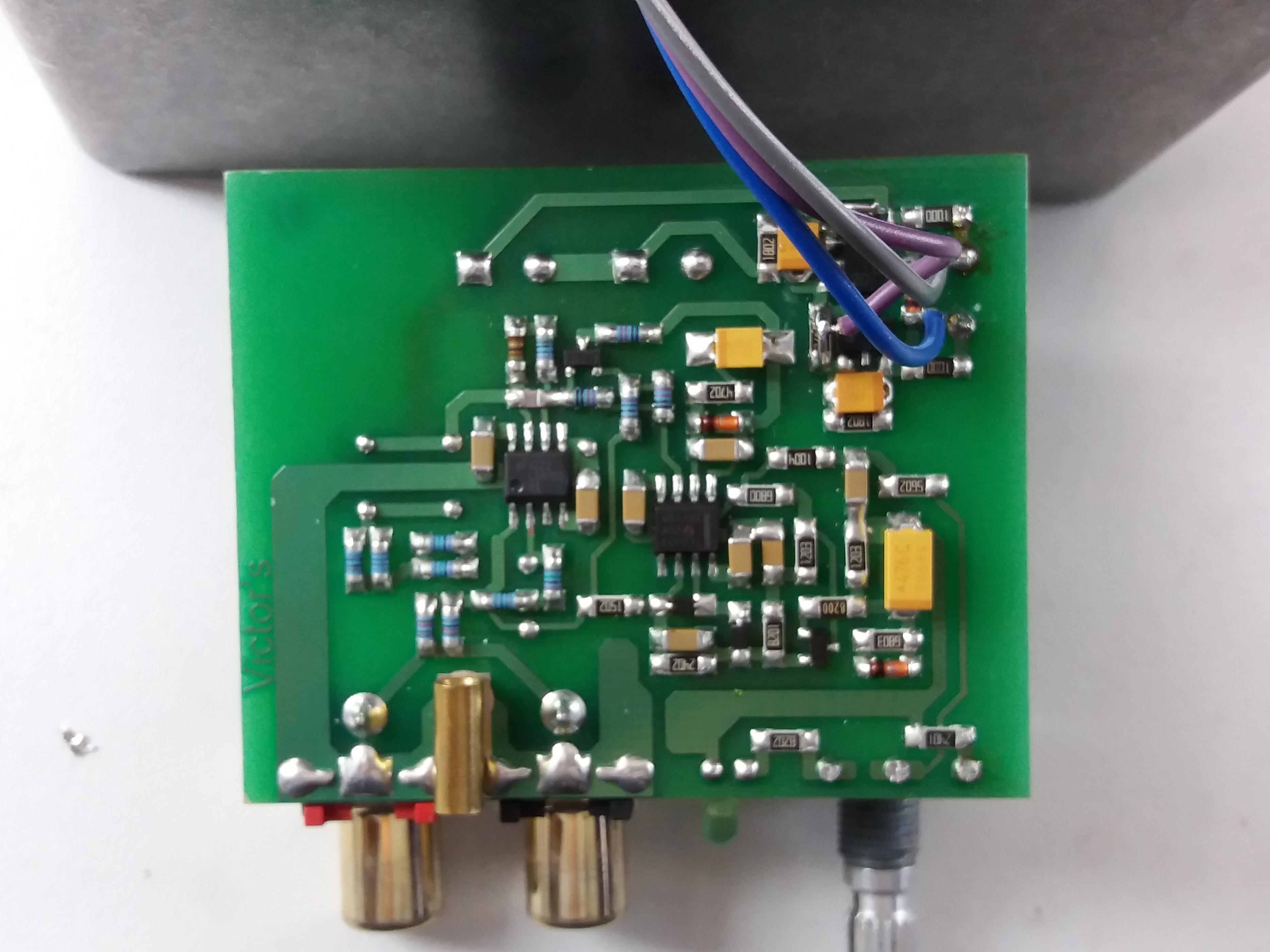

Have been playing with my new old AP SYS2722. Attached THD residual of the 2722 analog generator, as well as Viktors 1kHz oscillator, both at 1kHz, 2VRMS out.
Interestingly, the Viktor shows lower residual for 2nd and 5th, better than the AP. It also shows that going to balanced probably is not worth it.
Viktor, if you read this, is this typical for your unit? If you only could get rid of that 3rd .. ;-)
The specs for the 2722 are about 4dB better than shown here, but I am still waiting for the calibration kit from Mr. AP to arrive.
Comments invited.

Jan. I did basically the same as you with my Victor oscillator but with a passive notch. My result are much better and I suspect that your distortion origins from the AP's notch.
I had the same problem with my notch before changing the notch caps to a massive parallelled C0G type.
Ser the result here. Low-distortion Audio-range Oscillator

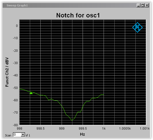

Spot on. (Pic 1) It's a twin-T notch with Susumu metal film 0805 resistors (1,5k and 3,1k) with three 100 ohm multiturn potmeters in series with all at enables fineadjustment of the notch down to about -80dB.

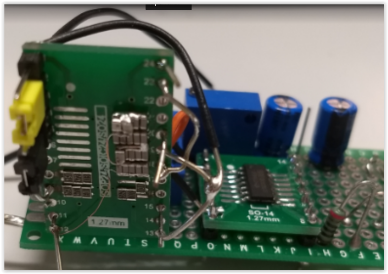

First I used PET capacitors in the notch filter, but that gave me much worse results. I then modded the circuit to this ugly creature with about 20-25 0805 C0G capacitors in series paralell to match the doube value required in twin-T design. (pic2)
That did the trick and I am very pleased with the result.

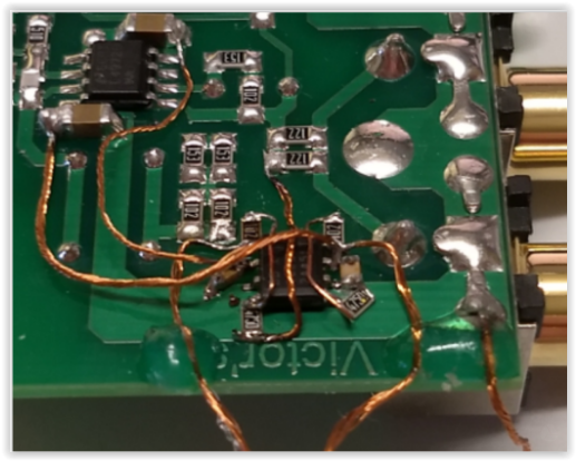

I have also added a OPA1632 on the output to give me balanced singnal to my amplifier testing (pic3).
With this in place I get around -140dB second and third order distortion. If this is from poorly matched resistors, the OPA1632 itself or from the analyser (with its built in notch) is unknown. Anyway it is much lower than the amp I am working on.
