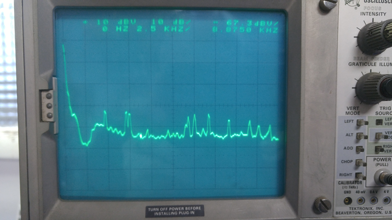

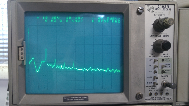

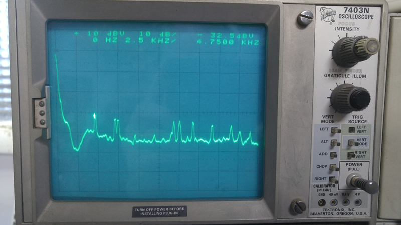

Some distortion measurements with my Shibasoku 725. These are all at 10V, 2400 Hz.
First are from a Fluke 510 AC standard (tweaked). The second 2 are the Shibasoku 590AR. They are scope pictures of the display from a Wavetek FFT, which has the internal corrections for bandwidth. These are from the monitor out at -90 dB (= 1V).
Scaling is pretty straightforward. 1V = -90 db from the signal (10V or + 20dBV) so for example first picture the -32 dB is -122 dB from the fundamental Second picture, the displayed noise is -67 dBV/rtHz so scaling 67 dB + 90 dB to the signal -20 dB to get to 1V yields -137 dB/rtHz noise density. Its -157 db from 10 V. I'm not sure that noise is the source or internally limited.

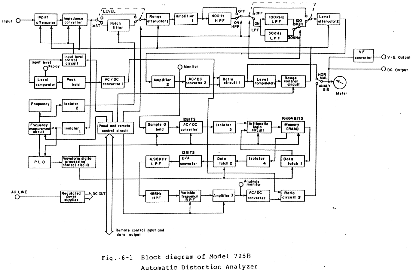

On this model the AGC starts at the input amp. That means, unless the noise is pretty high in the source, it will probably change with level as the input gain changes. What I have noticed is that the distortion and noise do change with level. The 590AR uses a passive 600 Ohm attenuator on the output for all levels. As a source it will never have less than 3 nV/rtHz.
I tried different levels with the 590AR and the distortion remains the same until the front end gain changes and then it all changes a lot with the harmonics shifting in levels significantly. All below -120 db so it meet spec.
Looking at the block diagram the meter gets its input in different ways but not directly from the monitor output. It looks at the ratio of input to output but the agc's are not that fine grained so it may have +/- 2 dB variation from level to level or more? Lots of moving parts in this thing.
Fluke 510 distortion w/ marker at distortion
Fluke 510 distortion w/ marker at noise in noise density mode
Shibasoku 590AR distortion w/ marker at distortion
Shibasoku 590AR distortion w/ marker at noise in noise density mode

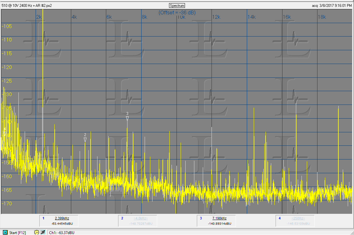

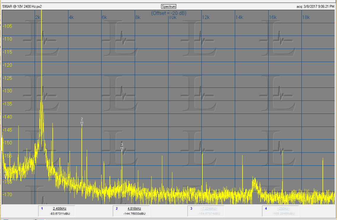

And just to get more data here are measurements of the same two sources using a passive (B&K 1604) notch filter. The harmonics are not corrected.
First the Shibasoku 590AR same as above.
Then the Fluke 510
The noise pickup on the 510 measurement is frustrating but typical when going directly into a PC sound card, even differentially.

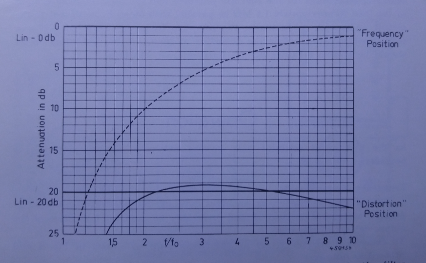

Use the upper correction curve to correct for the harmonic levels to compare. Using the "distortion" setting introduces too much loss.

Demian I not clear about the levels at the input to the notch filter.
Your card probably doesn't take much more than 1Vrms at the output.
Your not putting the whole 10V through are you?
This notch (B&K 1607) is completely passive. No mods. The EMU clips at around 7V (10V peak). I used the -20 dB attenuators on the 1607 to calibrate the input. The notched output is around -60 dB. I duplicated everything again today and got essentially the same results.
