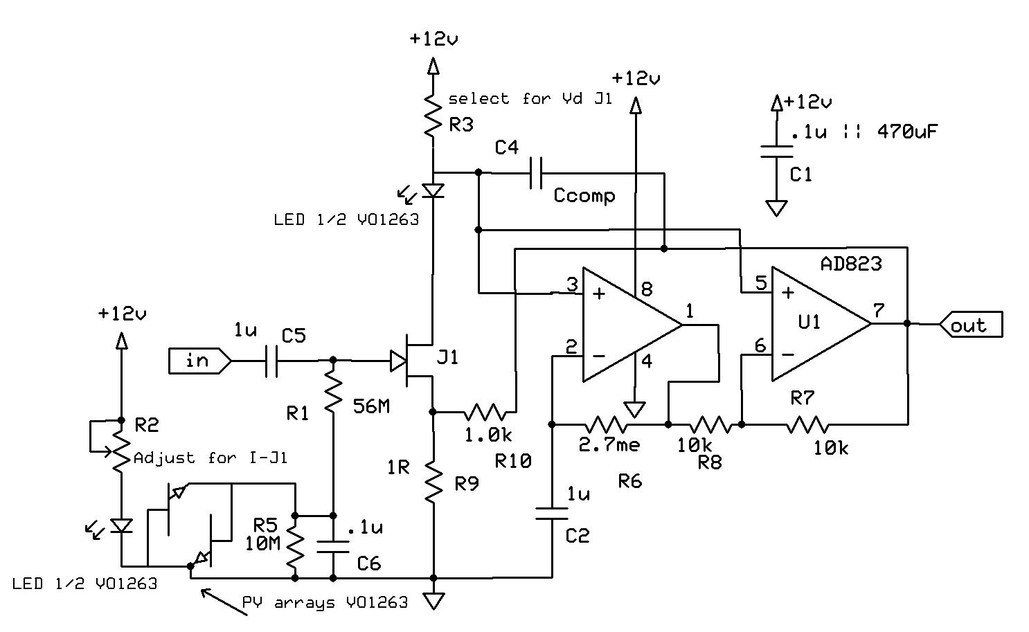

Been looking through the Wurcer LNA courtesy of Xen.
Question 1.)
The PV array is shown in the sch with the outputs in parallel but in opposite directions. This is replicated in the PCB.
If I set the 10kVR LED current into the PV Array and assume this is fixed.
When the input jFET draws current, it turns on the other LED and generates an opposite output, thus reducing the net voltage/current fed to the input offset injection via the 56Meg resistor.
If the jFET draws more current, the offset current injection is reduced.
Am I interpreting this correctly?
Q2.)
The R2a value is shown as 3k ±0.5%.
This resistor is in series with the 10k VR.
Why is a 0.5% tolerance resistor specified?
Q3.)
The 10k R7 R8 and the 1r R9 are specified as Vishay S102.
What do these resistor do that needs this quite specific resistor.
Can any 1r and 10k metal film be substituted?
If not any, what parameters are important for selecting these resistors?
Q4.)
C4 is optional and a 5pF is suggested. A position is not shown on the PCB. Where should this be located?

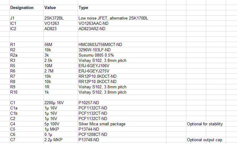

But I did download the BoM and sch
Can anyone recognise these and help point me to where they came from?
Question 1.)
Q2.)
This resistor is in series with the 10k Variable R2.
Q3.)
Q4.)
