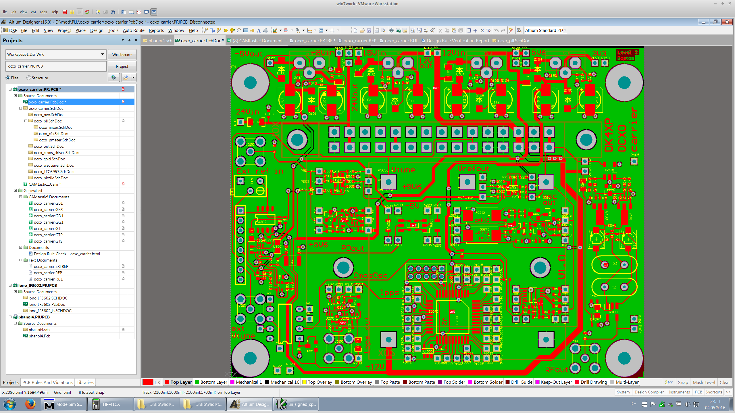

Maybe on the time nuts list. The filter is pretty low now on the priority list. Instead I have made a board that can carry a HP10811, Morion MV89 or MTI-260 crystal oven and phase lock it to an external reference. There is also a 1pps generator, optional frequency doubler / harmonic killer and output amplifier. I'd like to power-combine 2**n oscillators to average away their phase noise. I have bought at least 20 MTI-260 oscillators on ebay, packaged as HP/Lucent gps-less standby units and also got 20 of my boards
I'm also working on a IF3602-based successor to my 220pV/sqrt Hz preamplifier because I'm not so happy with its behaviour in the 1/f range. I want to use it as a ring mixer post amp to soup up my 89411A for cross corr. phase noise measurements to get independent of the E5052 at work, at least for some fixed frequencies.
I also see the problems with the phase noise filtering, but if one produces the oscillators, only 10% of the crystals have top phase noise performance. The other 90% are collecting dust. So the filtering could be a nearly free way to recycle them.
regards, Gerhard

Hi Gerhard,
That's a really nice board, and a good idea. I don't want to knock this thread off it's rails, we can take this to email, or you could begin a thread on your implementation and ideas. A lab frequency reference is a very useful thing, and I don't see it discussed much. I'm pretty sure there are other members that could contribute useful things to your project.
As for time nuts, certainly possible. That's another valuable reference source. I've learned a lot from the good folks on that list, and the references they are involved in are pretty darned good. Certainly better than the average hobbyist might need, but the basic idea is a solid one. Even a non-disciplined oven oscillator run into a few instruments would help with the digital devices we are starting to use. Right now, the idea would be a bench full of DVMs all calibrated to a different volt. Just trying to draw a parallel for people who haven't thought along those lines before.
-Chris

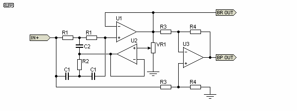

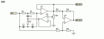

This is not a bad little state variable oscillator for $11, and, being built with through-hole components, can be modified without much difficulty. Not sure about the quality of the tuning capacitors, but they can be changed. Also, it probably would not be difficult using some off-board components to at least get multiple switched spot frequencies. Replacing the 5532 devices with updated devices, like LM4562 or OPA2134 might also yield improved performance. This would also make a good starter design for those who might want to experiment with active or passive twin T notch filters to try to see the distortion.
Also, using 2 or 3 of these with a good op amp summer, a decent twin-tone CCIF 19+20kHz or triple-beat MIM source could be made.
