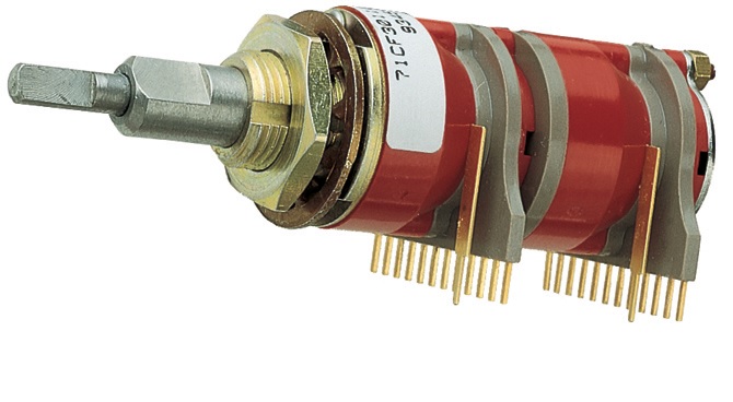

Here is a Grayhill similar to the Uni switch. Sells for 40USD. don't know anything about it just came across it.
These are the 71 series switches.
Thanks, these look fine and even better that Jan has tried them.
With options for economical, medium and top-end, that lets me feel confident that there will be no availability problems on a crucial part.
So it looks like a direct PCB mount switch, no wires and it will simplify SMT NP0 capacitors.
Now I can move towards a finalized board.

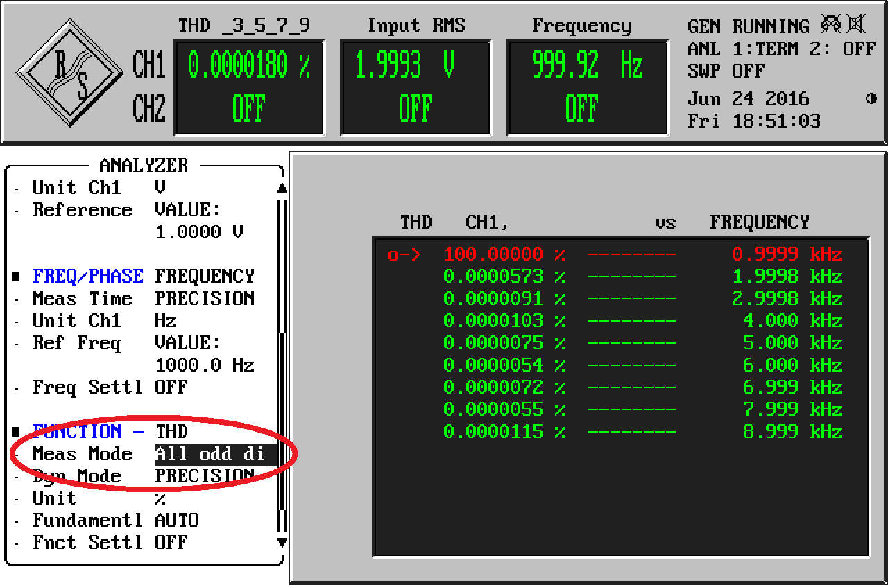

AP SYS-2722 and R&S UPV comparison (in japanese language)
"http://fixerhpa.blog.fc2.com/blog-entry-318.html"
what a luxury😱

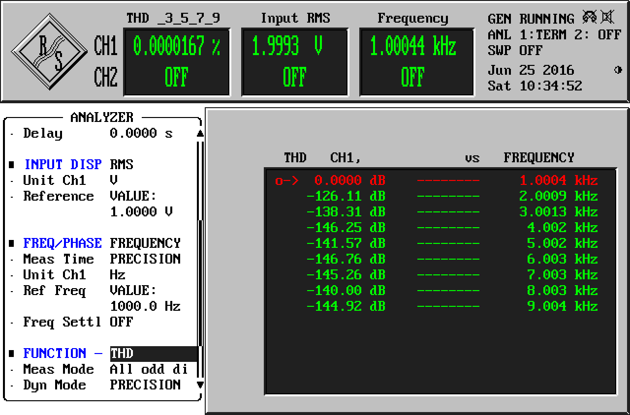

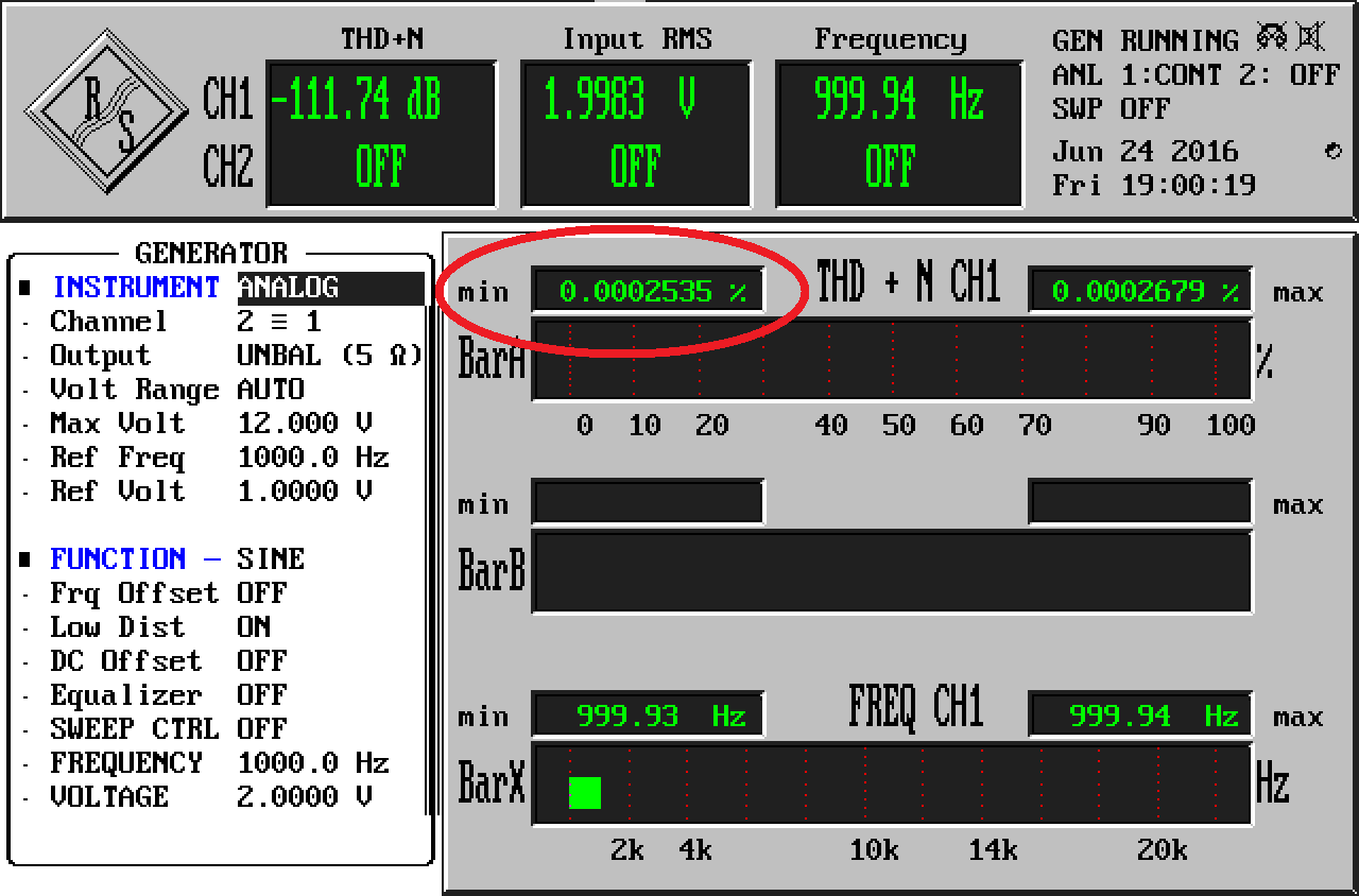

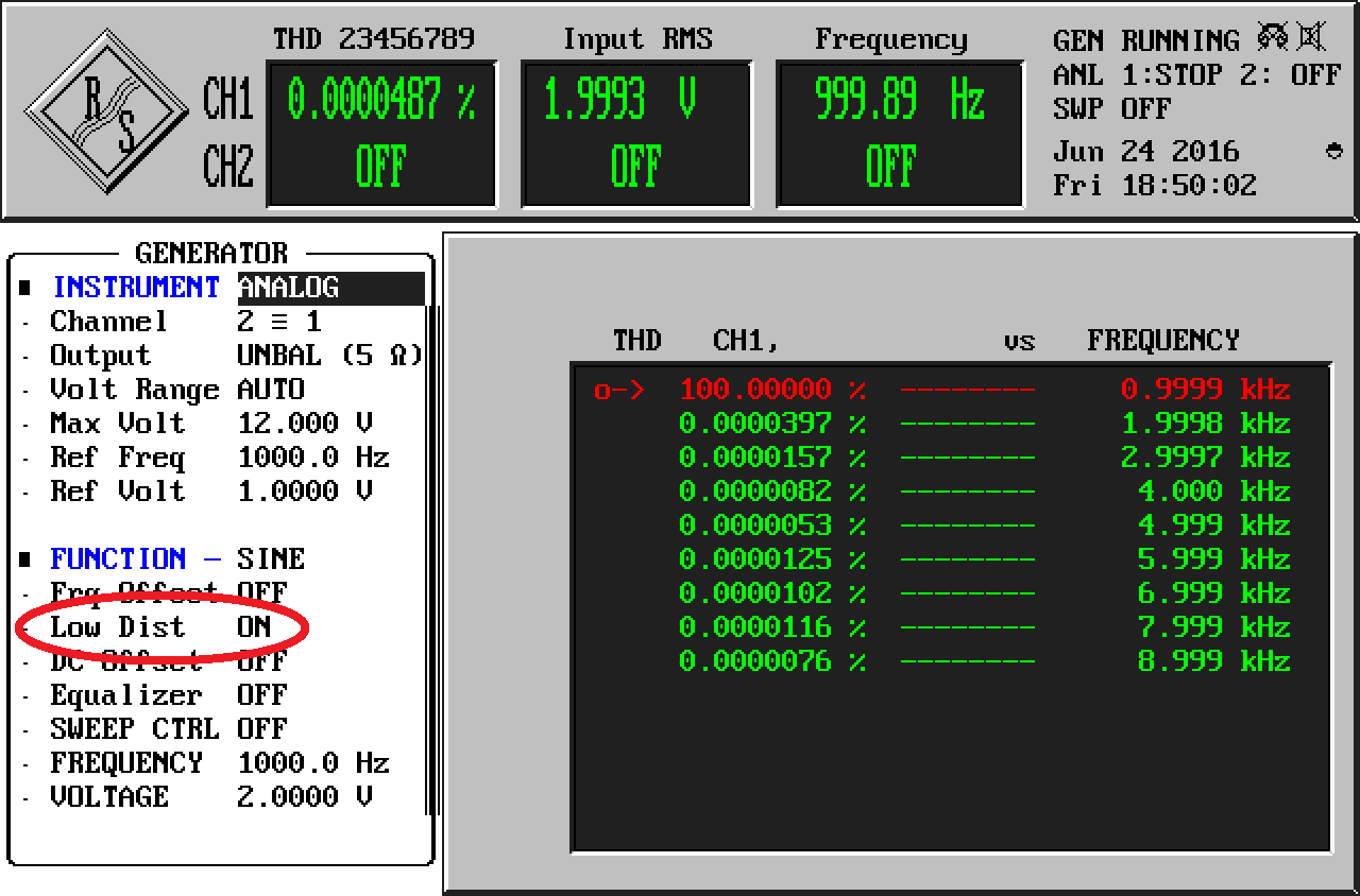

This comparison is not quite apples-to-apples, and can be misleading.
The writer did not state the option list for either machine and it is pretty clear from his findings that the UPV being tested either did not have the Low Distortion Generator (Option B1) installed or it was turned off during the tests. The SYS-2722 comes standard with a Low Distortion Generator.
If I am reading his findings right through Google Translate, a 2Vrms signal at 1kHz yielded:
SYS-2722
THD 0.00007%
THD+N 0.00016%
UPV
THD 0.00013%
THD+N 0.002%
Attached are my readings from a UPL with Option B1 installed and turned on. The UPL and UPV are stated to have identical analog performance. Generator output is connected via an actual RG316 50 Ohm cable to Analyzer input.
THD 0.0000487%
THD+N 0.0002535%
It can be seen that the UPL equipped with the Low Distortion Generator Option is a stunning performer, especially when compared to the SYS-2722. In one more picture, only H3579 are shown and it was at 0.000018%!

Can you redo those with the harmonics in dB? When the levels are so low the zeros are ovewhelming and dB are more manageable. The results are exceptional.
Sent from my LG-V496 using Tapatalk
Here are the plots in dB - THD with all harmonics H2 through H9, the only odd harmonics H3 through H9.
