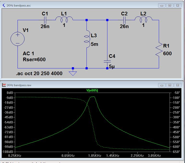

I guess I'm less impressed than Demian is -- I'm trying to figure out how you got 50dB of attenuation at 2kHz with a peak that broad, unless there's some limiting function at work in the sim. I also don't want my oscillator loaded with 600 ohms, but then that's a personal choice. In any case, if that attenuation can be real, then you've got a winner.
This is a quick sim of a filter synth I tried. Its a 3 pole Butterworth. It uses 1 Henry inductors. I first tried an elliptic but that needed 500H inductors. The passband is 100 Hz. The 1 Henry inductors are available from Triad. They almost certainly will have much higher distortion than any other element in this design. I don't think there is a practical 1 H air core. It may be the size of a Tesla coil.
That's pretty impressive. What does it spec for parts? And make sure the inductors are real (have realistic DCR). FWIW I use the free version of this Downloads which works really well. Then move the design to LTSpice to tweak.
It's not practical because the inductors are huge. The nonlinearity of iron core inductors really mucks up the AC response.

cute. The dips are set at the second and third harmonic. Those inductors are still huge, and they would need iron cores to be something you can put into a box. I can't even find a place to buy them, since the biggest I can get from Parts Express are about 10mH. I don't know if the iron cores were included in the simulation.
@dimitri -- not sure why we suddenly started talking about notch filters -- but the active Twin-T (RC only, positive feedback) is just better all the way around. But to clean up residual oscillator distortion, a low-pass or bandpass is needed. A simple LC peaking filter, one part each, has sufficient Q and selectivity to do the job. With a pretty good oscillator to start with -- an HP 239 or 339, or a KH 4402 -- an extra 10-20dB of suppression will take you mostly into noise.....

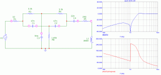

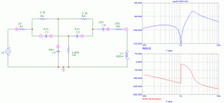

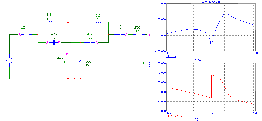

Wireless World, 1978, No 10
Neat Dimitri, I never saw that when I did my stuff. A 4" by 4" coil with 1300 turns of #16 wire is about 100mH and 4 or 5 Ohms (or am I way off). In the second one the coil does not see fundamental? and maybe could be cored??
Yes, see attach - current through the coilIn the second one the coil does not see fundamental?
Yesand maybe could be cored??
The beauty of this circuit is attenuation of 60Hz dirt (>40dB) and the same transfer ratio for all harmonics (2kHz, 3kHz, ....)
