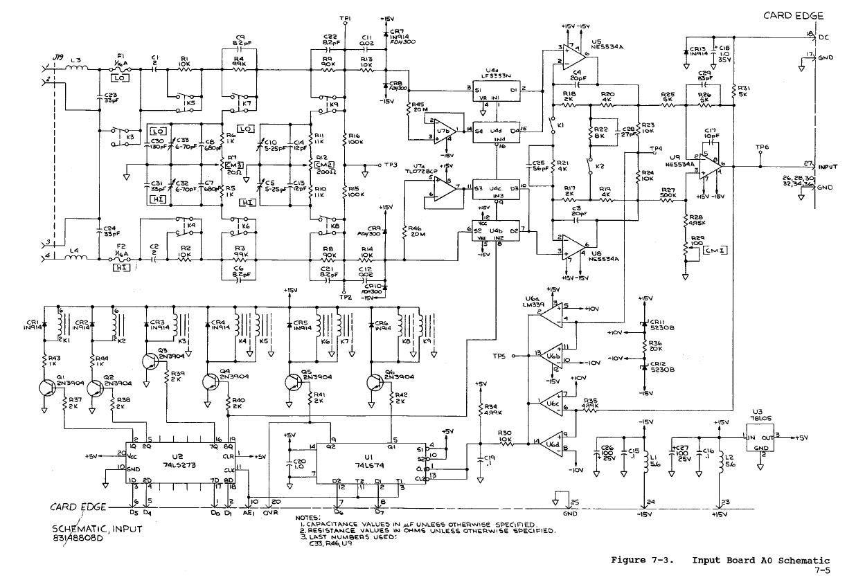

Boonton 1120 input
I have included the schematic for the input card for clarity.
I have noticed that the negative input has less distortion (by as much as 6 dB) than the positive input. if you lok t the schematic the difference is that the negative input goes to the inverting side of the differential stage U9. I think the issue is the common mode limits of that opamp and stage. Next step is to find which opamp handles the common mode the best. Also need to go through the circuit and determine the noise floor. Mine all are limited to varying degrees by second harmonic distortion. The input circuit has enough before getting to the notch filter to be the limit.
Also interesting is the "autorange/overload" circuit, U6 and U1. It looks pretty simple to emulate.
I guess the mil spec that created (and paid for the development) added 16 V open circuit and 8 V into 50 Ohms as output requirements.
Thanks--do you happen to have the schematic for the output stage you mention too?
I have noticed that the negative input has less distortion (by as much as 6 dB) than the positive input. If you look at the schematic the difference is that the negative input goes to the inverting side of the differential stage U9. I think the issue is the common mode limits of that opamp and stage. Next step is to find which opamp handles the common mode the best.
Same behaviour is observed for the SYS-2722 (as far as I recall the other way 'round, Bruce surely knew about it and avoided it at least for unbalanced sources), and I agree that common-mode distortion is very likely the cause. The AD797 is, to my best knowledge, the IC opamp of choice if low common-mode distortion is asked for. Even better were a diff amp topology which avoids significant common-mode swing to begin with.

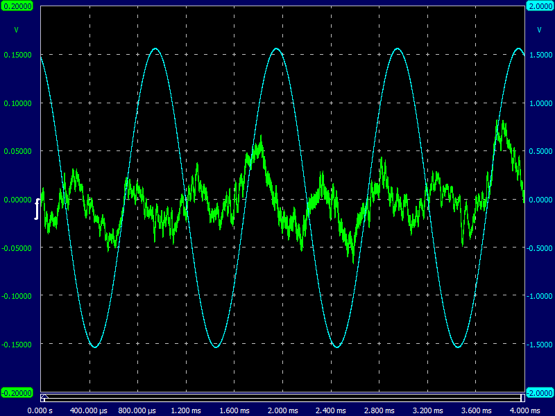

Yes the 2nd is where the money is for the 1130 as well.
I build my own 400Hz hp filter that sits on the filter board, and it seems to work OK (passed the cal numbers) yet when I activate it, the 2nd harmonic increases by several dB. So I win in the lf hum, lose in the 2nd :eek:
Demian is that also your experience with the filter?
I'm also looking for improved replacements for those integrated switches in the notch circuits LF13201 iirc. They have rather high Ron and the Ron also varies considerably over signal level.

I build my own 400 Hz hp filter that sits on the filter board, and it seems to work OK (passed the cal numbers) yet when I activate it, the 2nd harmonic increases by several dB.
But that's after the notch filter, no? Should not have any significant effect on distortion there. Perhaps some crosstalk (e.g. through the power supply) from it? That'd need to be rather substantial though...

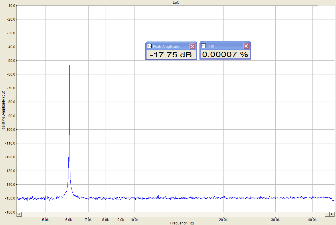

In the Boonton the plug in filters are before the notch. It may be to facilitate SINAD measurements on noisy channels (where the money is). The HP 8903 is similar. If I measure distortion within an octave of the cutoff the distortion goes up. Higher and its OK. The high pass is quite sharp.
Keep in mind that the box is specified to -80 dB THD+N and can get close to 100 dB with a little care. Freshly tweaked I can get .0006% around 1 KHz with around 3V in.
What I like is the generator accuracy (very close to a precision calibrator) and the ease of use. It also supports closed case calibration for many parts and the GPIB stuff works well. If the 2nd harmonic can be excised it would be really nice.
